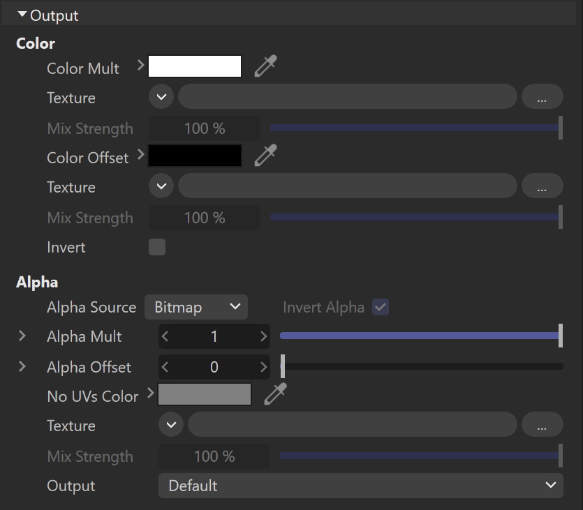

Output
Color Mult – Corrects the color of the texture by multiplying the RGB color values in the texture with the RGB color values specified here. A texture map can be assigned here.
Color Offset – Corrects the color of the texture by adding the RGB color values specified here to the RGB color values of the texture. A texture map can be assigned here.
Invert – Inverts the output map's hues.
Alpha Source – Determines how the texture alpha is computed:
Bitmap – From the alpha channel of the bitmap image, if present (and returns 1.0, if the image has no alpha channel);
Intensity – The alpha is taken from the intensity of the bitmap image colors (red+green+blue)/3;
Opaque – The alpha channel of the bitmap image is ignored and the VRayBitmap texture always returns 1.0 for alpha.
Alpha Mult –
Alpha Offset –
No UVs Color – Specifies a default color used for polygons with no valid UVs. In case the map is not tiled, specifies a default color that is used outside the texture square.  When a texture is selected, it overrides the color.
