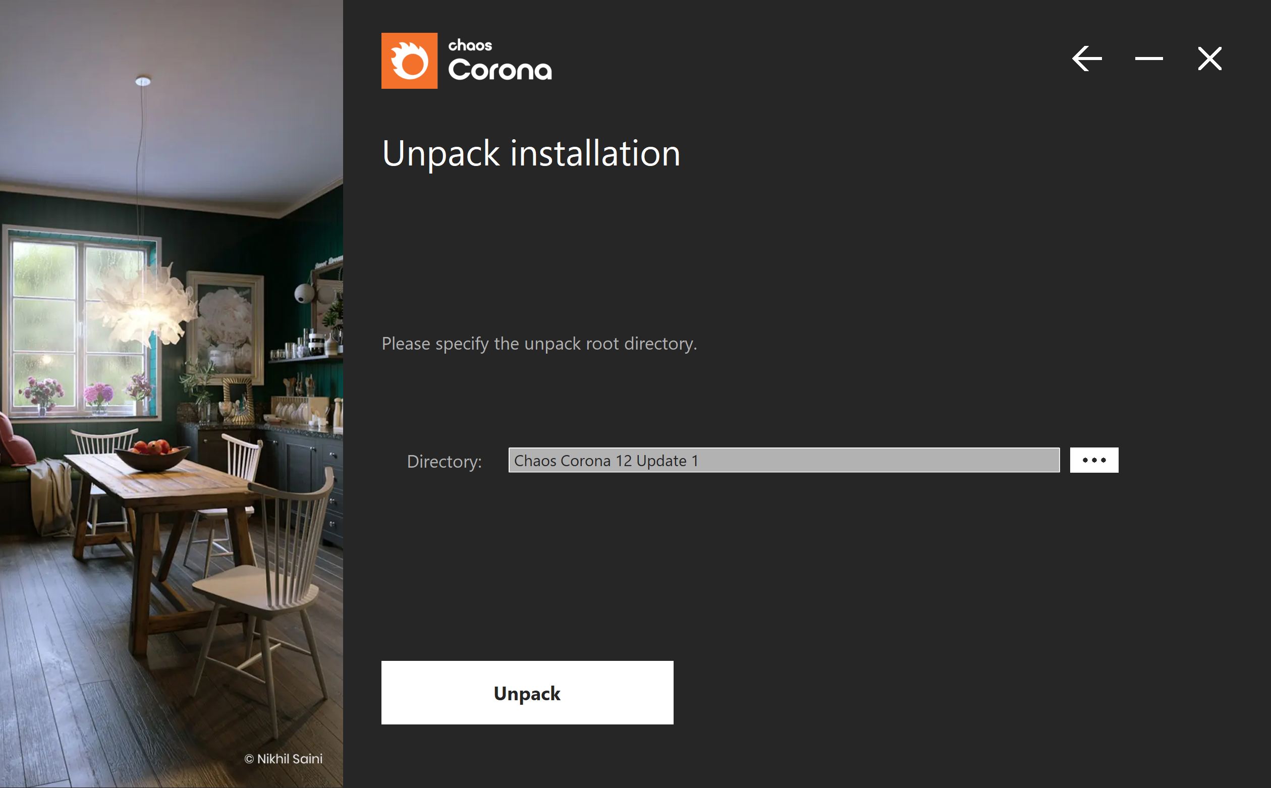

If you need to unpack all the installer files into a specified directory, click the Unpack button. This option is useful for advanced users and debugging purposes. For instance, you might choose this option when installing the plugins manually or troubleshooting installation issues. If the installer cannot detect any host application, you can unpack the files and copy them manually.
Unpack installation
It opens when you click on the Unpack button.
Directory – Specifies an unpack root directory where the installer files are extracted.
Click Unpack to proceed.

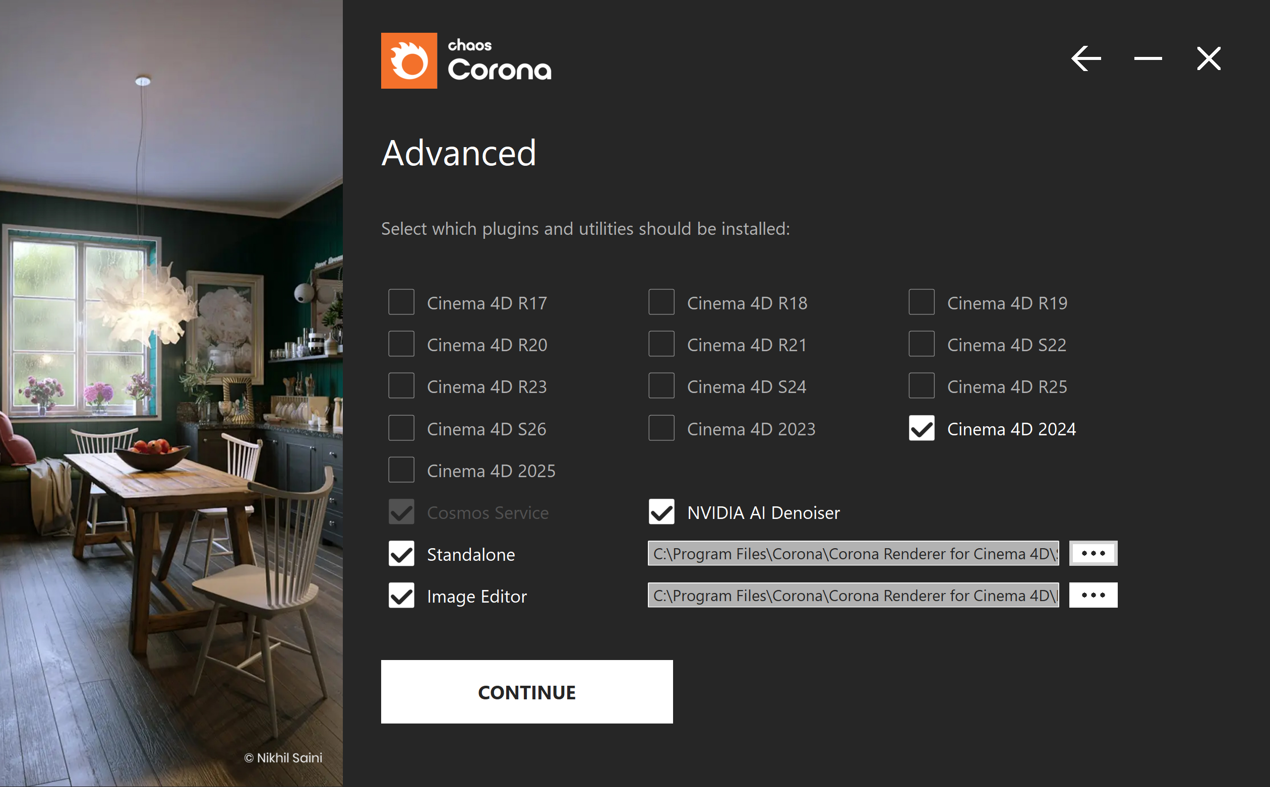

Advanced
It opens when you select the Advanced button.
If you select the Advanced installation type, after selecting Advanced, you are presented with the customizable options. Select the version of Cinema 4D you wish to have Corona installed in. You can also select the services you want to include in the installation - Cosmos Services and the NVIDIA AI Denoiser. Also, decide if you wish to install Corona Standalone and the Image Editor, and if so, where you want to install them.
Click Continue to proceed.

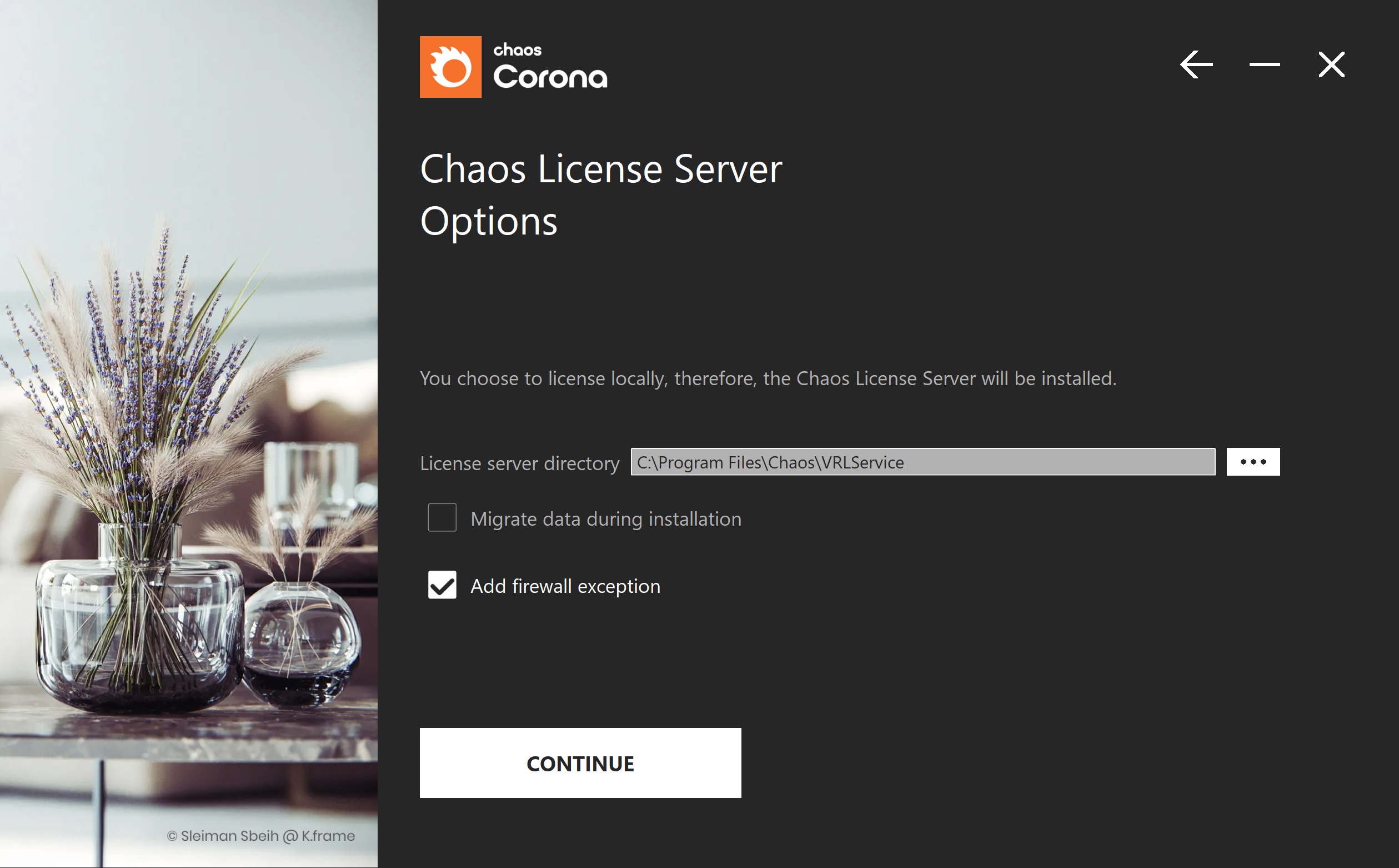

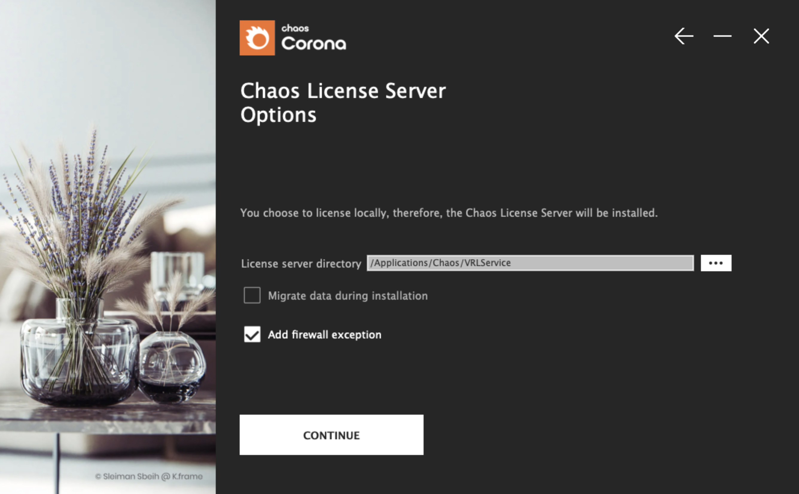

Chaos License Server Options
If you choose the Local Licensing option, you can choose where to install Chaos Licensing at this step.
Migrate data during installation – When enabled, it transfers all of your settings made with older versions of the Chaos Licensing, such as proxy settings, etc. Disabling this option makes a clean install of Chaos Licensing, with any custom settings from previous installations reset to their defaults.
Add firewall exception – Allows the default licensing port (TCP 30304) in the firewall. If you disable it at this step, you must manually add firewall exceptions later.
Click Continue when ready.

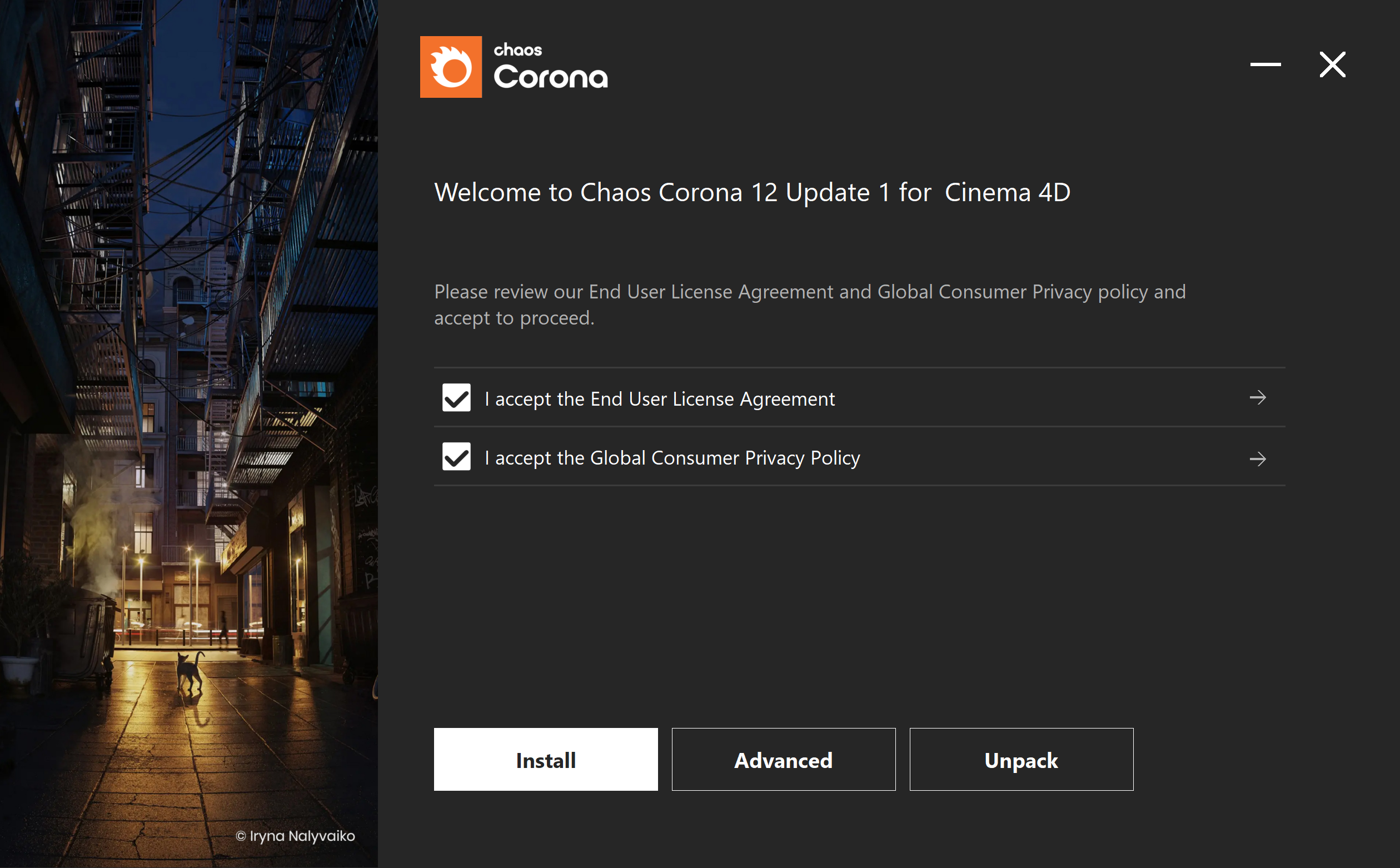

Welcome
Carefully read the End User License Agreement and the Global Consumer Privacy Policy. Click the checkboxes if you agree to the terms.
Proceed to click the Install button.
The Install option uses localhost for licensing by default and installs the software in a default directory.
If you need to customize your Corona for Cinema 4D installation, click the Advanced button.

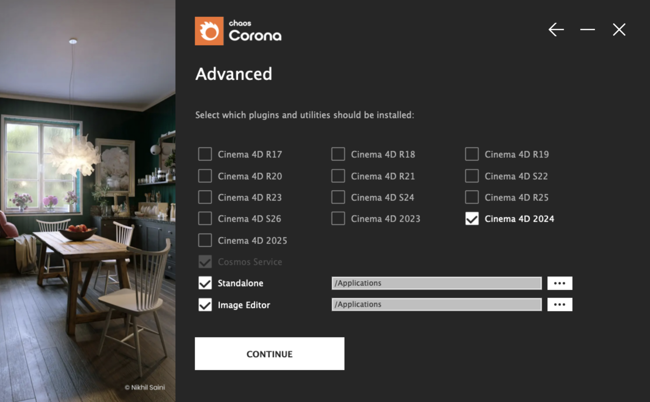

Advanced
Opened when you select the Advanced button
If you select the Advanced installation type, after selecting Advanced, you are presented with the customizable options. Select the version of Cinema 4D you wish to have Corona installed in. You can also select the services you wish to include in the installation like the Cosmos Services. Also, decide if you wish to install Corona Standalone and the Image Editor, and if so, where you want to install them.

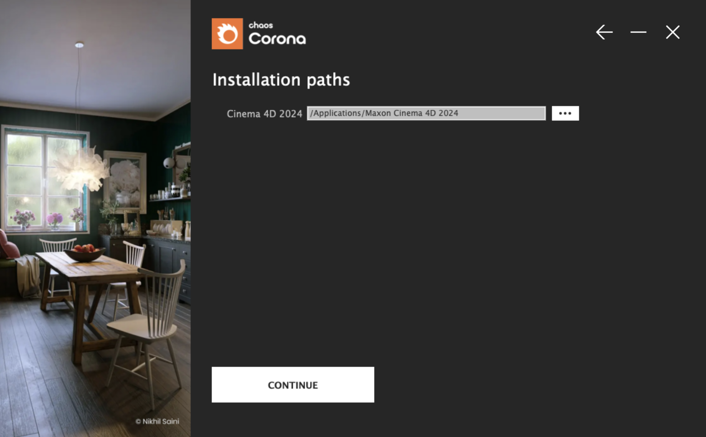

Installation Paths
In this step, review and edit the location of your Cinema 4D installation. This is so that the Corona plugin will be installed in the right place and be read by Cinema properly. Click Continue when ready.

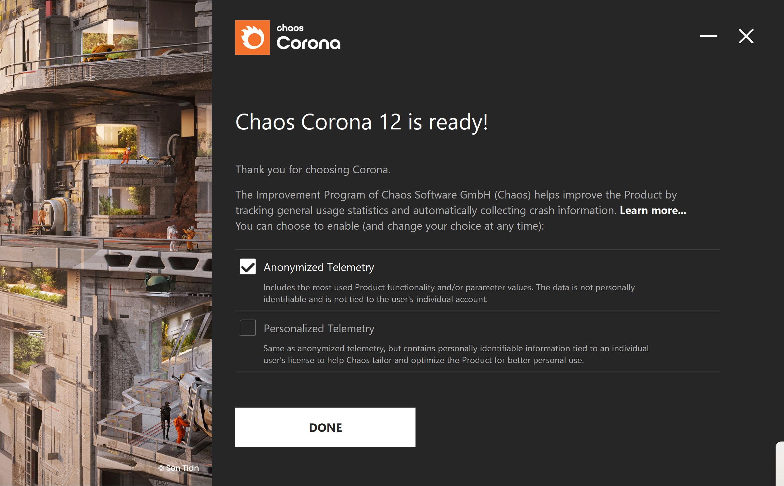

Chaos Telemetry
Corona for Cinema 4D is installed successfully!
Participate in the improvement decisions for future versions of Corona. No intellectual property is violated when agreeing to participate in the improvement program. Chaos does not gather scenes, assets, materials, etc. For more information, see the Chaos Telemetry page.
Anonymized Telemetry – Includes the most used product functionality and/or parameter values. The data is not personally identifiable and is not tied to the user's individual account.
Personalized Telemetry – Includes the most used product functionality and parameter values but also contains personally identifiable information tied to an individual user's license. This helps Chaos tailor and optimize the product for better personal use.
