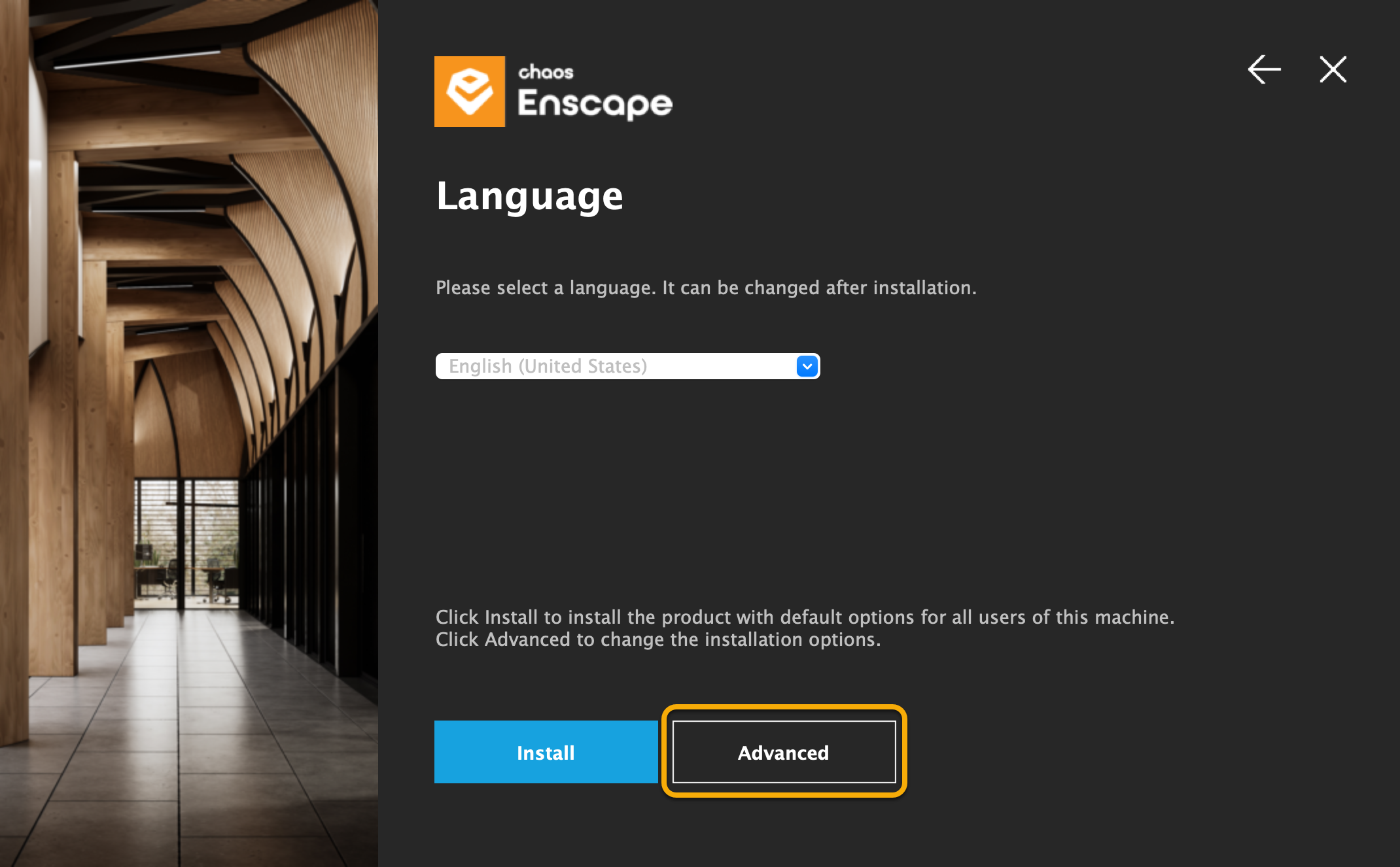

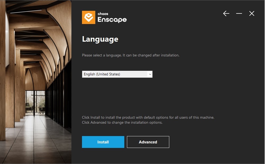

Once Floating License Sharing is enabled for the Organization, any user in the Organization can use the shared licenses by installing their Chaos product with all the default installation settings and signing in to the product with their Chaos Account. When added to an Organization, users receive an email confirmation. If the user does not yet have a Chaos Account, the user can create one by following the link in the email invitation that they receive. - Have the Administrator add you to their Organization.
The Administrator can add you to the Organization with your email. If you do not yet have a Chaos Account yet, you can create one by following the link in the email confirmation you receive. - Install the Chaos product(s) your Organization has a license for. Proceed with a default installation. This installs the Chaos license utility locally. Sign in with your Chaos Account when prompted.
Default Install |
Sign in |

- In case users have configured their Chaos product to connect to a centralized remote License Server, they will need to re-install the Chaos product and select Local Licensing in the installer’s Advanced options. Users will then need to sign in to the product with their Chaos Accounts.

If you already have a floating license setup with a centralized License Server within your local network, your users have selected Remote licensing in the Advanced installer options. To move to a Cloud-based Floating License setup, users will need to switch to Local licensing by re-installing the product and selecting Local licensing in the Advanced installer options. If users are installing a Chaos product for the first time, they only need to install with all the default options without selecting any of the Advanced installer options.
