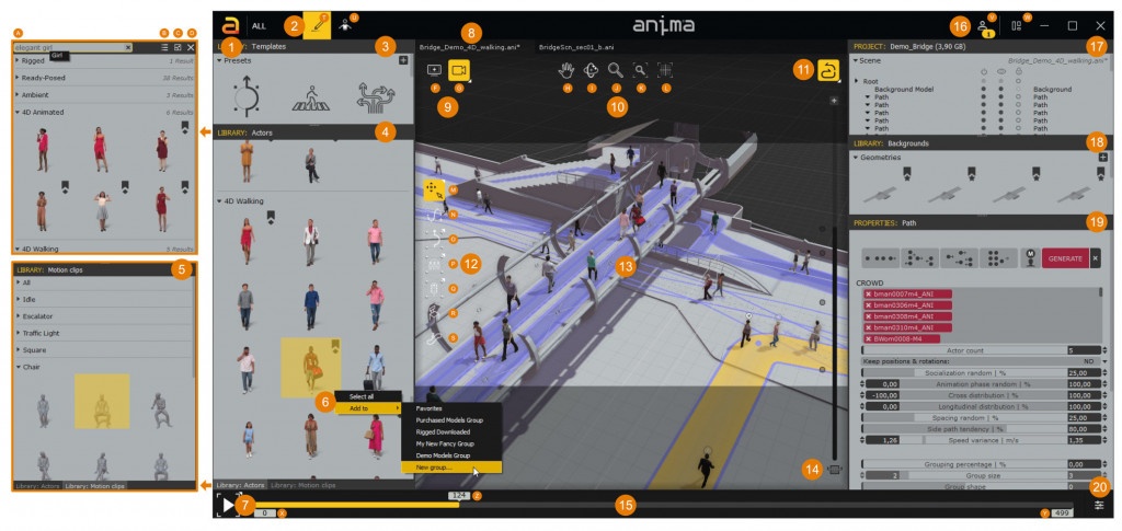

The Draw Mode Interface
The place to design, organize, and simulate your animations is the anima® Draw mode.
This mode is arranged into logical panels to help you focus on different aspects of your work such as selecting actors, drawing paths and areas, synchronizing the scene with your 3D app with alive™applying motion clips, editing the properties of the nodes,  or managing their hierarchy in the node tree.
  1. Main Menu
    This is the core of the application, where you get access to all the other submenus (Project, Scenes, Edit, Preferences, Help, License, and Exit).
    Right next to it you can see the currently activated license on this machine: ALL, PROor LITE.
  2. Mode
    The mode switch is used to toggle the workspace between Draw [T] and Edit [U] modes.
  3. Templates Library
    The Templates library contains system-wide and user-defined area presets. Drag these into the 3d Viewport to quickly populate scenes.
  4. Actors Library
    Contains a list of all the actors available in the current project: the ones from the Purchases folder and all the available actors online in the current user account (when using the subscription, all the metropoly® models from the web will be listed).
    Drag them over characters in the 3d Viewport, or into the Crowd field of the Properties panel to assign characters to paths, 4D pathsareas, or chairs.
    The following options will appear when you hover the mouse on the title of all the Library panels (Templates, Actors, Motion Clips, and Backgrounds) and also in the Project properties panel (except the thumbnail option):
    [A] Filter search box
    [B] Thumbnail or List view toggle
    [C] Floating panel toggle
    [D] Hide panel ( use the Panel button [16] to show it again )
  5. Motion Clips Library
    Contains a list of all the motion clips and categories available in the current project. Drag these onto the Motion Clip/Category property of an area to assign to all its characters. Assign it to individual characters by dragging to their Actor Clip properties, or directly over a specific actor in the 3d Viewport.
  6. Actor submenu
    Right-click on any actor to access the library item sub-menu and organize them as you please.
  7. Playback controls
    Use these controls to play back animations. There are 3 playback modes: Simulate and play (showing the tool nodes), Simulate and play preview (hiding the tool nodes), and Generate Preview Video (*.avi).
  8. Scene Tabs
    Each opened scene will be displayed in a different tab. You can open multiple scenes from the same project at the same time.
  9. Display Buttons
    [F] Display Preferences. Use this button to setup the viewport quality settings and preferred interaction preset (anima®, 3dsMax®, Cinema4D®, Unreal Engine®, Maya® or Blender®).
    [G] Camera Preview. Choose here between the cameras synchronized with alive™.
  10. Viewport Navigation tools.
    Let you control the viewport point of view by:
    [H Orbit.
    [I] Pan.
    [J] Zoom.
    [K] Zoom Extents.
    [L] Top View.
  11. alive™ button.
    Use this button to connect with the anima® plugin and synchronize scenes, cameras, and backgrounds.
  12. Toolbar.
    This toolbar contains all the tools needed to create or edit the scenes:
    [M Select and transform tool. Use this tool to select objects and actors from the viewport.
    [N] Path tools (For 4D walking and Rigged models). Use it to draw walkways (paths) over the collision backgrounds and make the models walk and run over them.
    [O] Avoid area tool. Use this tool to define obstacle areas that the actors must avoid.
    [P] Area Tool. Creates Area objects that provide a simple way to place groups of static actors.
    [Q] Traffic light tool. Creates a special area that let you stop and/or start the actors.
    [R] Chair tool. Lets you create seated people individually or in groups.
    [S] Escalator tool. Lets you create fully animated escalators and moving walkways.
  13. 3D Viewport.
    Shows a real-time preview of your animation project and enables you to design, create, and edit areas as well as move actors, assign motion clips, import background models, and create your scenes.
  14. Clipping Tool.
    Drag up and down to reveal different levels of the height of the background model. Or click the [+] icon to create more height shortcuts.
  15. Timeline bar.
    Use this bar to set the current frame [Z] or the animation range.
  16. User Account | Panels.
    [V] Use the Account button to sign in/out of your user account and access your models and notifications.
    [W] Use the Panels button to show or hide the panels available in Draw mode (Actor library, Clip library, Background library, Template library, Project properties, and Node properties).
  17. Project node tree.
    This window shows a hierarchical view of all the areas and actors in your scene and allows for an at-a-glance understanding of the project. From here you can create, select and edit all the elements in the animation.
  18. Backgrounds Library.
    Contains a list of all the backgrounds available for this project.
  19. Node Properties.
    Shows the properties for the currently selected object. This panel is dynamic and its contents will be different depending on the type of object selected.
  20. Playback settings
    Adjust the frames, time, playback speed, fps, format, and quality of the video.

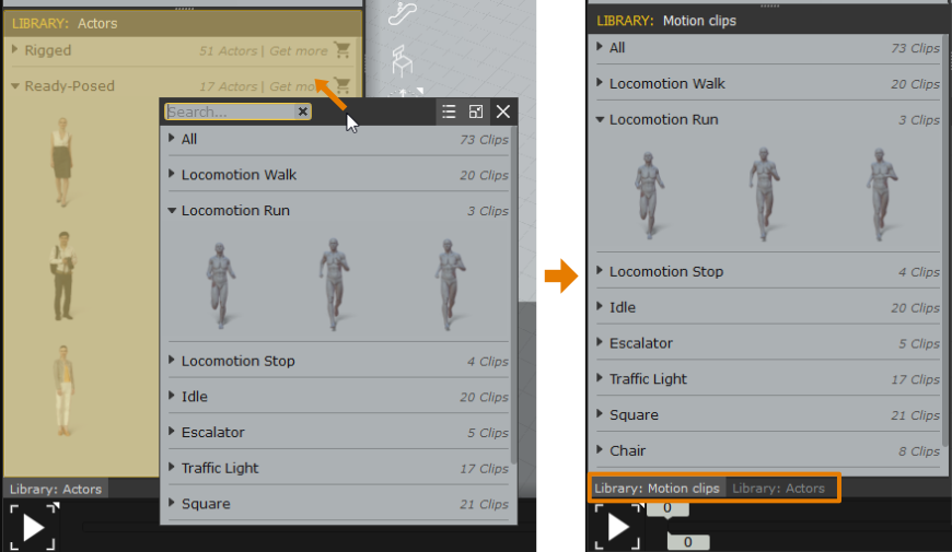

To Re-arrange, Re-size, and Tear Off Panels
  • To resize a panel, drag their top or bottom. To resize the column or add/remove more thumbnail columns (in the libraries), drag the sides in and out.
  • To move a panel, click and drag on the title bar. Once in the Drag mode, the valid areas where the panel can be docked again will be highlighted in yellow as you hover your mouse over them. Drag in between panels to change the position, or drag on top of another panel to create a new Tab in a tabbed group.
  • Drag a panel to an empty part of the screen or click the detach button in the top right-hand corner to tear off a panel. This is ideal for users with multiple monitors as it allows them to place the panels on one monitor and keep the 3d viewport on another one.
To Create Tabbed Panels
To combine a panel with another to form a tabbed dock, drag it by its title bar on to the target panel.
To Toggle Between Thumbnail and List Views
Click the  icon for lists and the  icon for thumbnails.
To Reset the Workspace
To restore the layout to the previous settings, go to the Panel List and select Use last workspace.
To reset the layout to the system default go to the Panel List and select Use default workspace.
