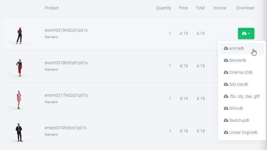

All the Metropoly® characters are available in the native Anima format (*.y) and, once purchased, you can download them from your user control panel under the Order or the Download sections.

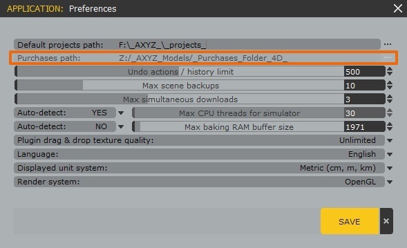

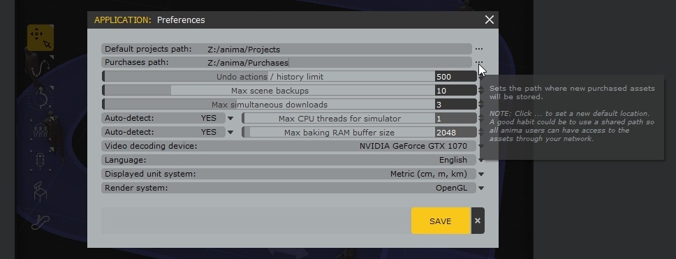

Both the purchased and the subscription models will be downloaded into the “Purchases” folder that is defined in the preferences panel (anima® icon menu > preferences).
To edit the path, click on the 3 dots icon at the right side of the setting and choose the new location:

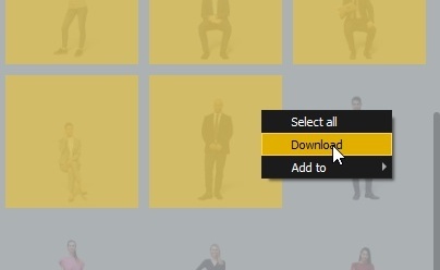

Also, since version 4.0 you can select and download multiple actors at the same time, they will be managed in an automatic download cue directly from inside the anima® library. You can do it using the right-click over any of the selected actors and then choosing either download or update, depending on the case.
They will be downloaded one after the other and installed automatically in your library right away, without needing to restart anima®. Also, any plugin instance will be notified through the alive™ connection, so it won’t be necessary to restart your 3D application anymore.

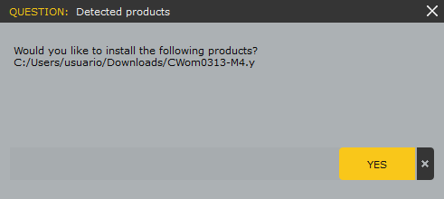

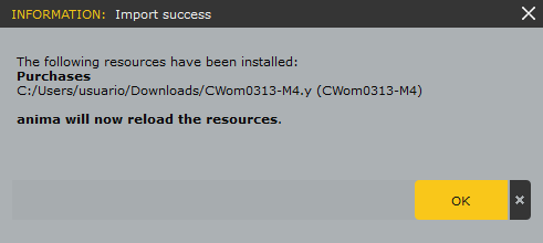

If you have downloaded your actors to your downloads folder, next time that you open anima®, a pop-up window will appear asking if you will like to install the new assets.
Note that anima® will automatically detect and install all the new *.y files found in the windows “downloads” folder. So if you downloaded a purchased collection or any other compressed model, you’ll need to extract it inside that same folder for anima® to detect it.
After clicking “Yes” another window will confirm that the product has been successfully imported.

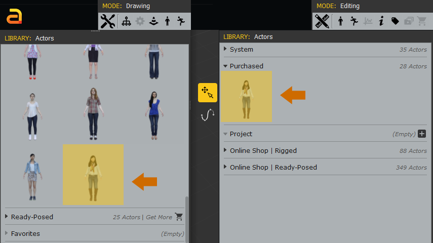

The new actor(.y) will be automatically Installed in the Purchases Folder. Depending on the type of model, it will be installed in the “models” (Posed, Ambient, Rigged) or the “streams” (4D models) subfolder.

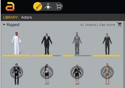

The thumbnail of the actor will be displayed in the actors’ library under the purchased tab in Editing mode and in the Rigged or ready-posed tabs in Drawing mode, depending on the model.

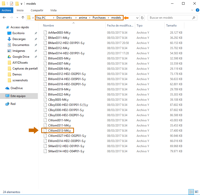

Manual Copy
You can install them by manually copying the “*.y” files directly in the corresponding “models” (Posed, Ambient, Rigged) or the “streams” (4D models) subfolder of the “Purchases” path that you have defined in your anima® Preferences, here:
