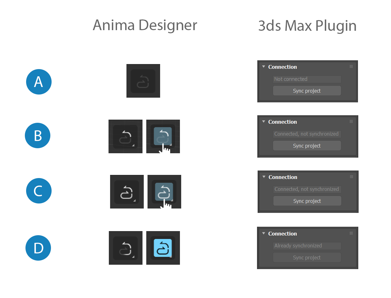

The first step to start an Anima Alive connection is to open Anima and your 3D application. If we only have one of both applications opened (either Anima or 3ds Max/Cinema 4D), the Anima Alive connection will stay disabled (see state A in the image).
After that, as soon as we have any project loaded in Anima or in the 3D app, the Anima Alive button can change to the following states:
  • Connected, not synchronized (state B)
    It means Anima Designer and the plugin are connected but there is no project loaded Anima Designer (default scene) or 3dsMax. A click in this state will start the synch.
  • Connected, not synchronized (state C)
    It means Anima Designer and the plugin are connected and there is a project loaded in both Anima Designer and 3ds Max. A click in this state will send to 3ds Max the same scenes loaded in the Anima Designer.
  • Already synchronized (state D)
    It means Anima Designer and the plugin are connected and the same Anima project is loaded 3ds Max, and all the scenes loaded on both sides are the same.

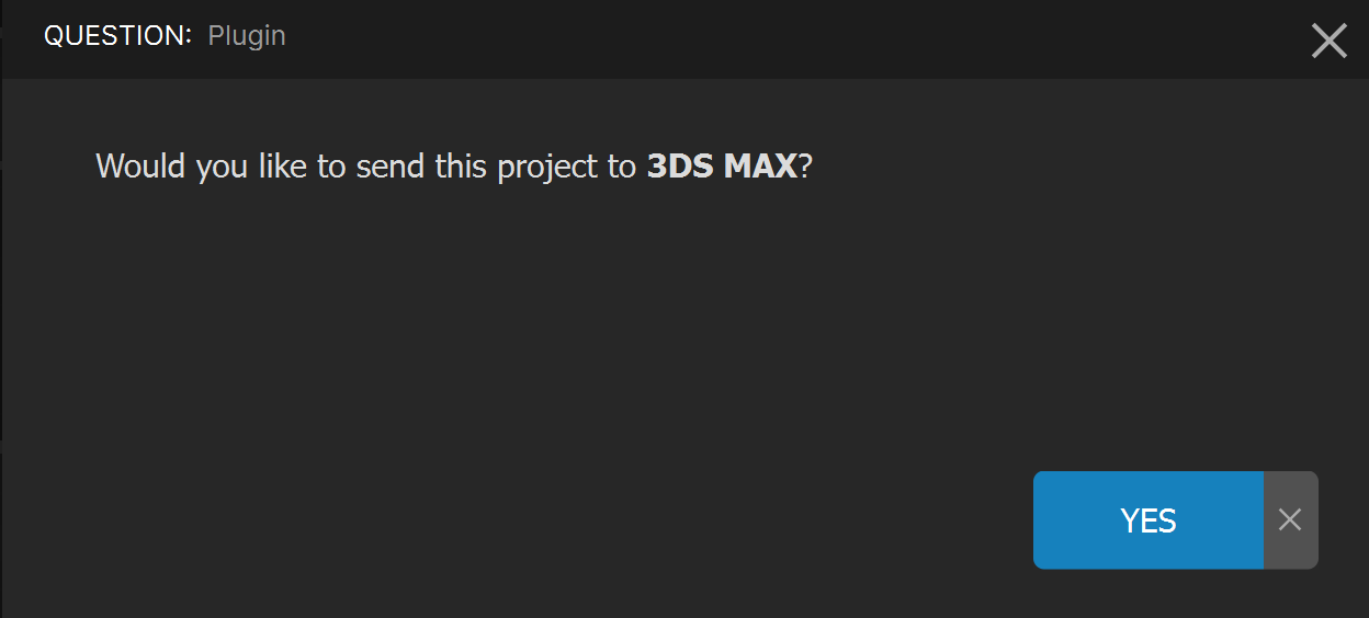

The most common way to get to this state is when you have already created and loaded the project you will work on into Anima and you want to send this project to the scene loaded into the 3D app. To do that you simply push the Anima Alive button (when you hover it will change from the first icon to the second one).
Then Anima will ask you to confirm the synchronization:
And when you click YES, Anima Alive will tell the plugin to load the same scene that is already loaded in Anima. This scene will be loaded into 3dsMax following the import process that you already know, but this time Anima Alive will spare you the tedious process of going to Menu>Import and searching the Anima scene path, and you’ll only have to confirm the material preset that you want to use.

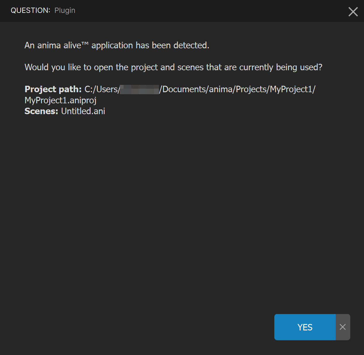

Every time that you load an Anima scene into your 3D app with the Anima application open, it will ask if you want to load also there the scene from your 3D app, with a message similar to this one:
If you click YES, then the project and the scenes that were already loaded into the 3D app will be loaded now also into the Anima Designer application.

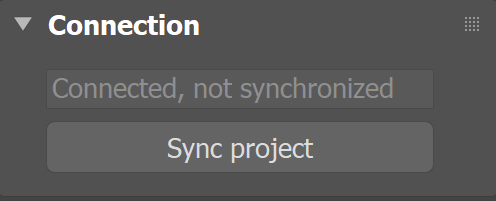

Sometimes it may happen that this message is shown at an inappropriate moment, for example, if you have been editing another scene and you still have not saved the changes. In this case, you can simply cancel the connection temporally (click X), save the scene where you were working, and then make Anima Alive to ask you again that same question. To do that you can go to the Anima Alive connection panel in the plugin and click the Sync project button:

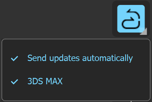

Although this workflow has been designed to update the scenes automatically, and the sync process is fairly quick, in some cases the user might find annoying the delay introduced by the synch process. This might happen, for example, when working with very big Anima scenes with thousands of actors.
For that reason, it is also possible to disable the automatic synchronization of Anima Alive and force it to be triggered manually, whenever the user needs it to happen. This can be done by unchecking the first option of the Anima Alive dropdown “Send updates automatically“.
With that option disabled, the synchronization will only happen whenever the user clicks on the Anima Alive button.
