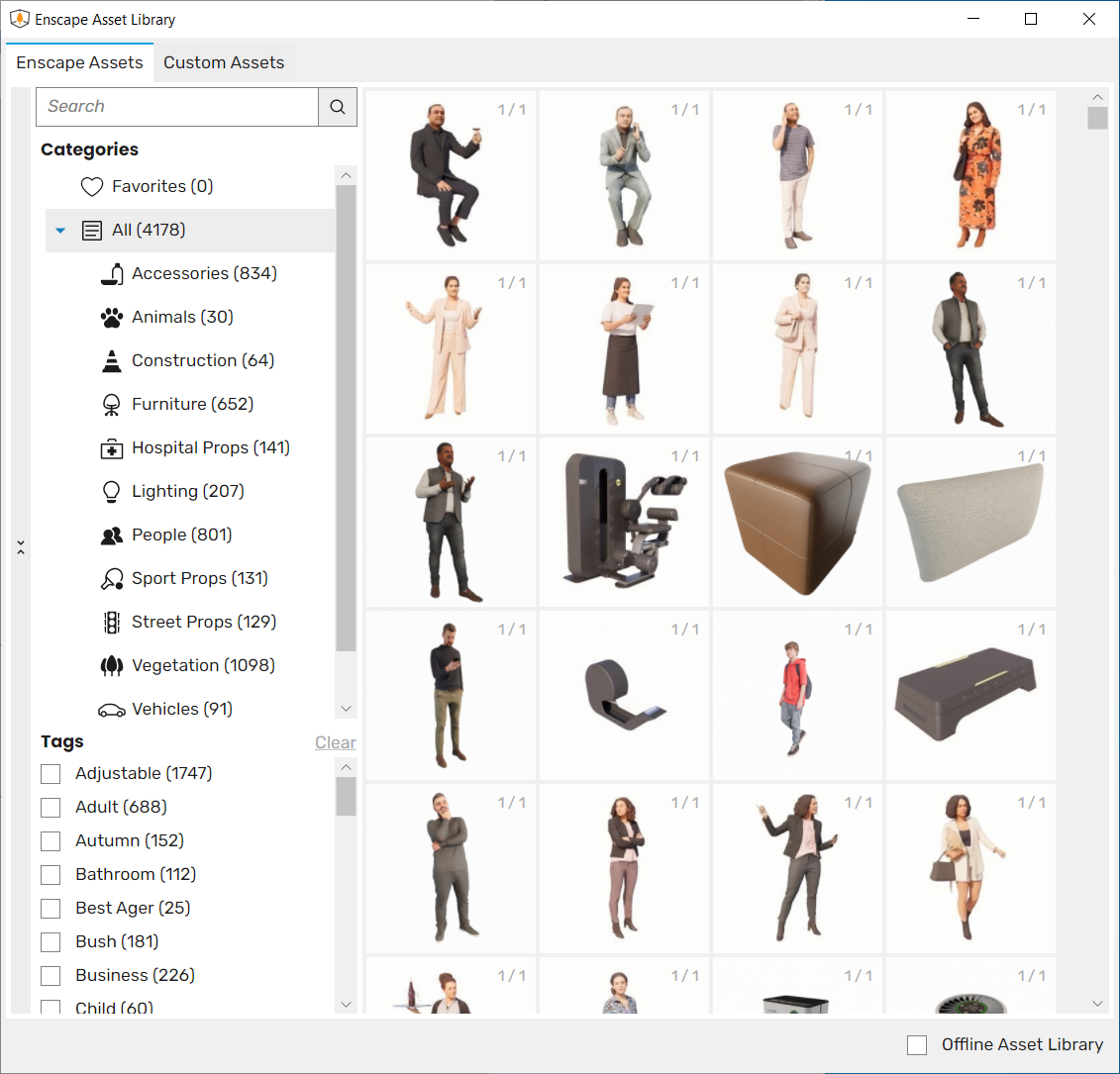

Once the associated button in the CAD is clicked, the Asset Library dialog will open and the library can be browsed for the asset you want to place within your project. Assets use simplified, white textured, placeholders for reference in the CAD viewport to keep project file sizes low. If you want to view the asset with textures, then you will need to start up Enscape, which can be done without having to close the Asset Library dialog. |
The Asset Library CAD dialog on initial opening |

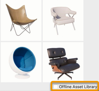

The Asset Library is a feature that functions online by default, but the assets are also available in an ‘Offline Mode’, meaning the assets can now be downloaded for offline use. To do this, check the Offline Enscape Assets checkbox to be found at the bottom right hand side of the Asset Library window. |
Offline Assets checkbox in CAD dialog |

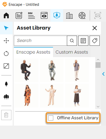

There is also an Offline Asset Library checkbox available from within the Asset Library panel in the Enscape Viewport UI. |
Offline Assets checkbox in Enscape |

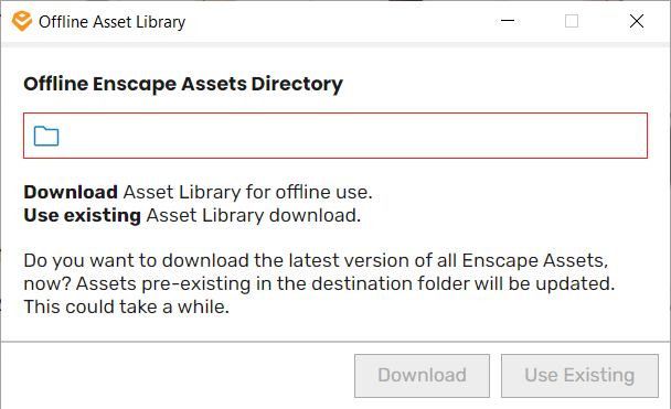

Once that is checked, a dialog will appear requesting that you define the location you would like the Offline Assets to be stored.
CAUTION: choosing a folder with existing content might result in loss of data. So please make sure to choose a dedicated folder that will only contain these downloaded Offline Assets, otherwise you may lose some files that you may otherwise have wanted to keep. |
Define the location to store the Offline Assets |

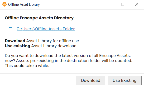

Another dialog will appear asking if you want to download the latest versions of all the Enscape Assets, or use the existing cached Assets, those being the Assets that have already been placed in the CAD and rendered once in the Enscape viewport. |
Choose between the latest version or locally cached version of assets to use. |

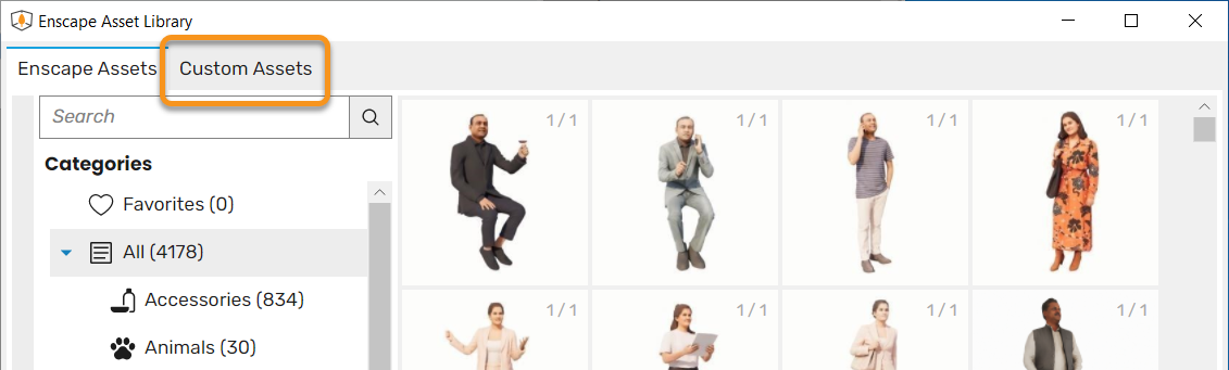

Custom Assets
Again, notice a tab for Custom Assets is available which allows you to upload and use your own assets in your projects and this is covered in depth here. |
Location of Custom Asset Library |

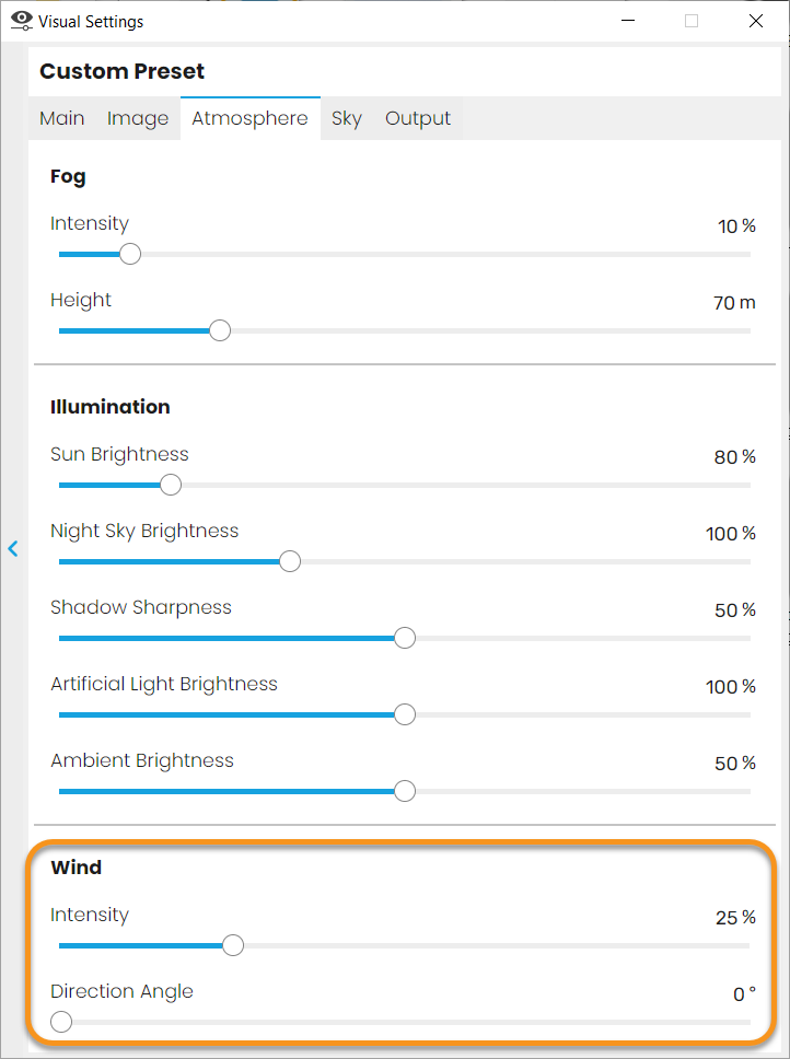

Only the tree assets are animated (although the Enscape special Grass material and the Enscape sky are also animated). The degree of animation of these assets is affected by the Wind Settings in the Visual Settings' Atmosphere tab, so you will need Enscape running to change these settings. The Intensity will affect how strongly the assets animate and the Direction Angle will affect the direction, in degrees, that the wind is blowing from. It’s worth mentioning that this feature does not affect any Custom Assets. |
Wind Settings in Visual Settings dialog |
