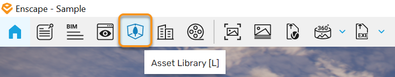

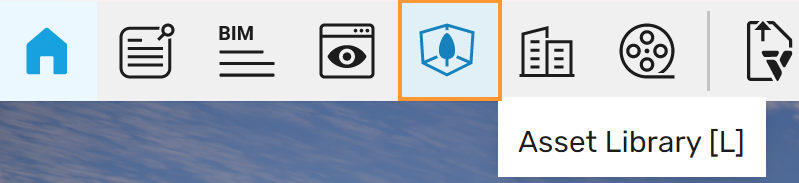

Asset Placement is achieved via the Enscape Asset Library which can be accessed in one of two ways. Either from within the CAD toolbar or from within the Enscape Viewport User Interface (UI) toolbar. This is covered in more detail in this article.

Asset Library button in Rhino
Asset Library button in the Enscape Viewport UI
Asset Library in Enscape

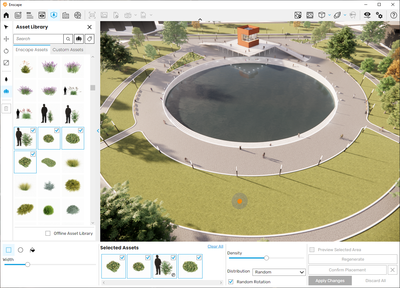

The Asset Library panel in the Enscape Viewport, once opened, has the following options available:
  • Search Assets function
  • Category and Tag filters
  • Asset Placement tools
  • Enscape and Custom Assets tabs
  • Offline Asset Library

To speed up the asset placement process on large surfaces you can use the Multi Asset Placement tool. After clicking on the Multiple Asset Placement icon additional options will become available below the Asset Library.
Multiple Asset Placement menu

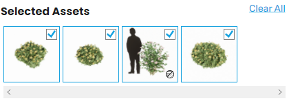

The first step to placing multiple assets is to select all the assets to be placed. Single or multiple assets can be selected and selected assets will receive a check box and will also be shown under the Selected Assets area at the bottom of the Enscape Viewport UI.
Selected Assets
Click the checkbox in the asset thumbnail either in the Asset Library panel or under the Selected Assets area to remove individual assets from the selection. To remove all assets at once click the Clear All option in the Selected Assets area.
If Confirm Placement is clicked, the current placement can be undone by clicking Discard All.
If assets are added, or removed by unchecking them, all assets in the current selection will be repositioned.

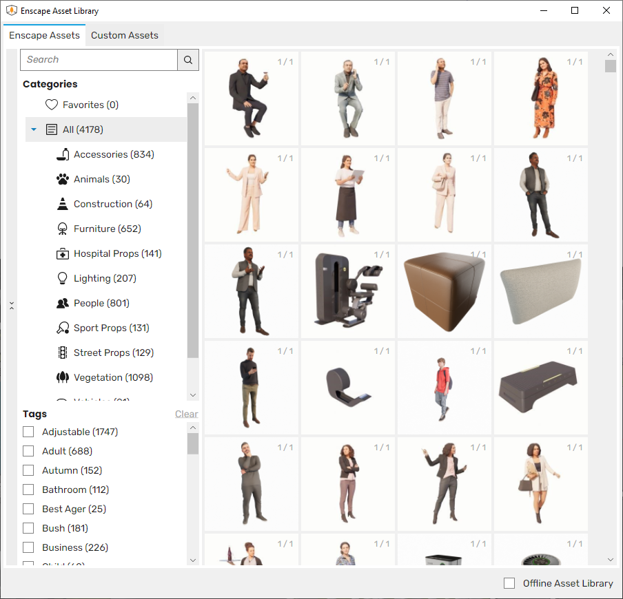

Asset Library in Rhino
When  the Asset Library is opened via Rhino, initial placement of assets must be performed in the Rhino UI and it is only possible to place single assets via this method. The tools provided within the Enscape Viewport UI to rotate, scale, and move an asset, as well as the Multi Asset Placement feature are only available when opening the Asset Library from within the Enscape Viewport UI.
What follows is a guide on how to place assets via Rhino. This is only possible by opening the Asset Library via the associated button available in the Rhino toolbar or menu and not from within the Enscape Viewport UI.
Lastly, the Asset Library when opened via Rhino does not require the Enscape Viewport to be open.
Rhino side Asset Library dialog

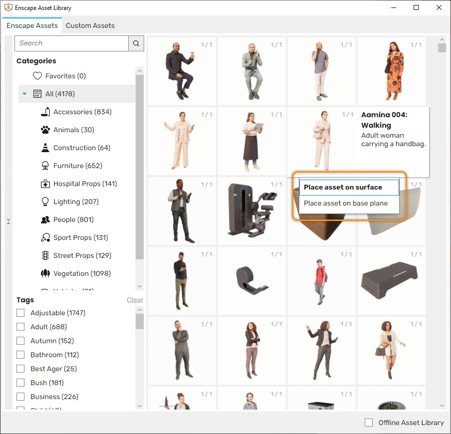

Rhino has two options to place assets:
Place asset on surface – where you select the surface in Rhino before placing the asset.
Place asset on base plane – which will place the asset on the base place (Construction or C-Plane).
Initial asset placement in Rhino
Using this option, open the Asset Library, click the menu next to the asset and choose Place asset on surface. Then, move the mouse into the Rhino viewport you want to use, choose the surface you want to place the asset on so that the surface is highlighted in yellow in the Rhino Viewport. In the active Rhino viewport, Rhino will indicate where the Asset can be placed
with a small cross hair and the text box ‘OnSrf’ will appear in the Rhino Viewport next to that small cross hair. Left click to place the asset. As long as Live Updates is enabled, the asset will show instantly in the Enscape viewport.
