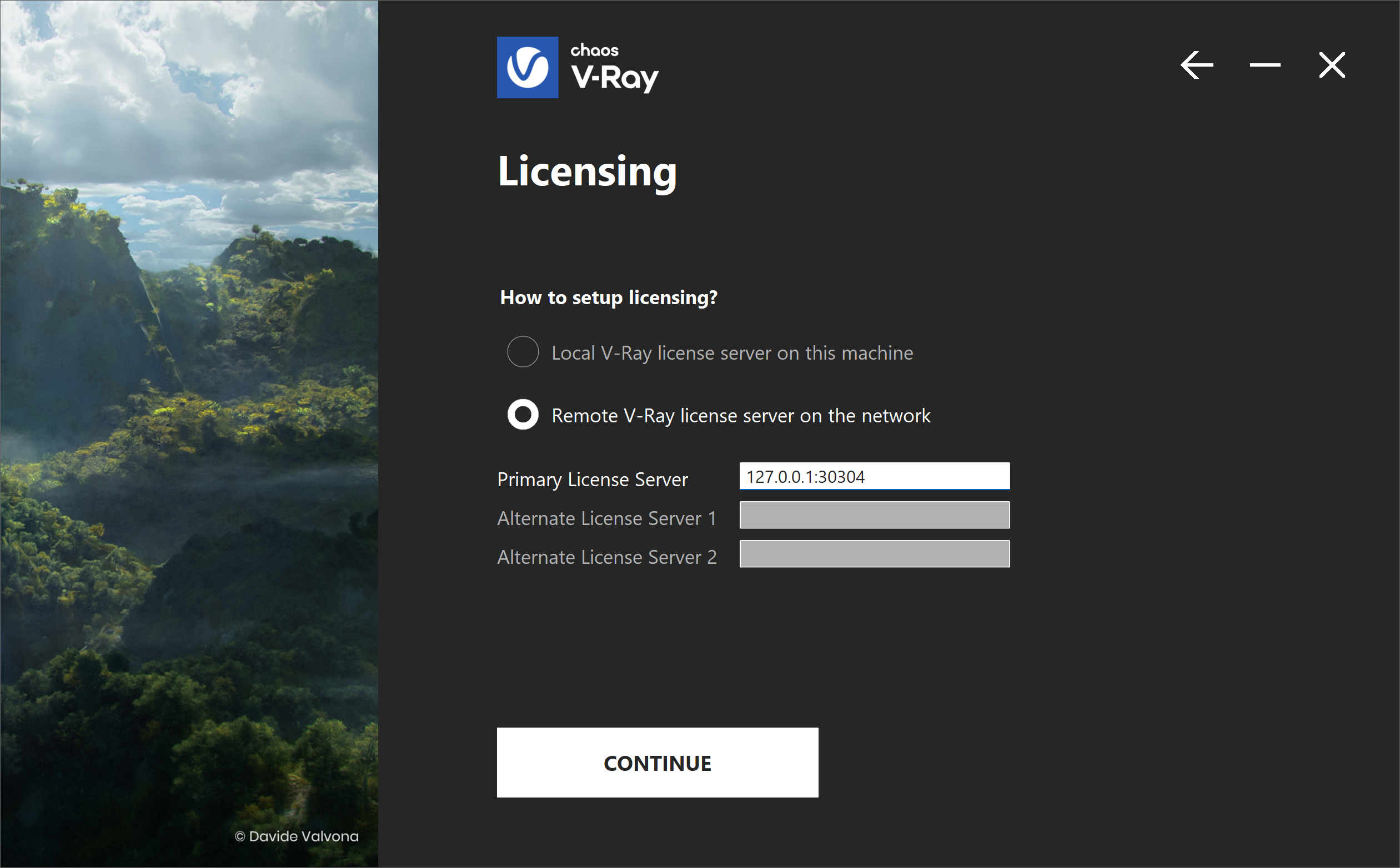

Network Floating Licenses
If you are connecting to a Floating Chaos License, which is set up to be shared within a network, follow these steps.
  • The administrator needs to give you their machine's IP address. This serves as your connection point to the Chaos License.
  • When installing your Chaos product, at the Licensing step, select Remote. In the Primary License Server field, type the server IP address that your license administrator gave you. At the end, add the :30304 port. See the Installation page and follow the steps for your Chaos installation.
  • You are automatically connected to the active licenses after completing the installation.
Read more about the licensing process and functionality in the Chaos Licensing documentation.
Example screenshot
Then, from the Render Properties, select V-Ray as the Render Engine.
