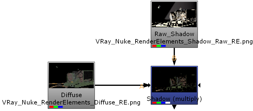

Compositing Formula
Shadow Raw x Diffuse = Shadow
