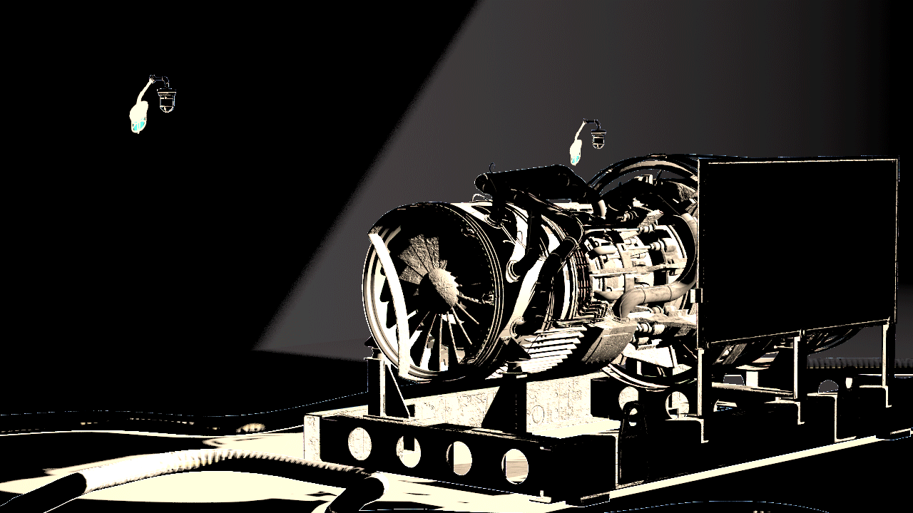

The Shadow Raw Render Element stores information about cast shadows calculated from the lighting in the scene. It is a "reverse" image in the sense that white areas indicate shadows while black areas indicate no shadow.

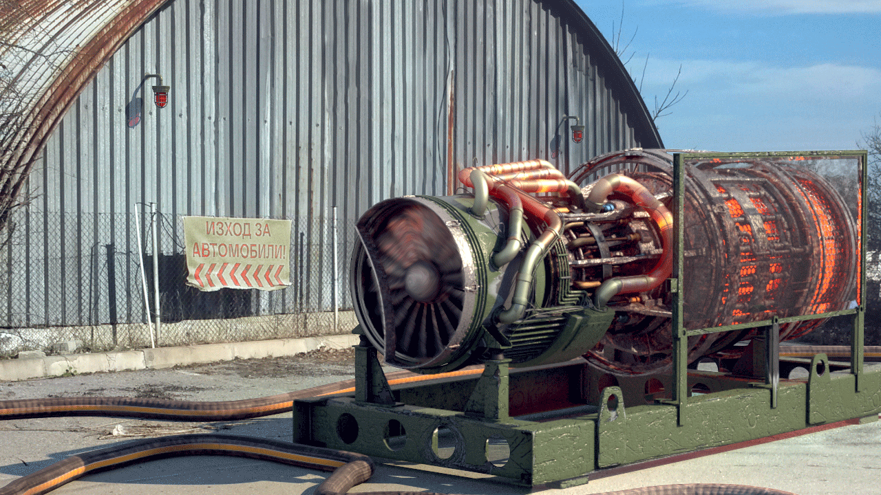

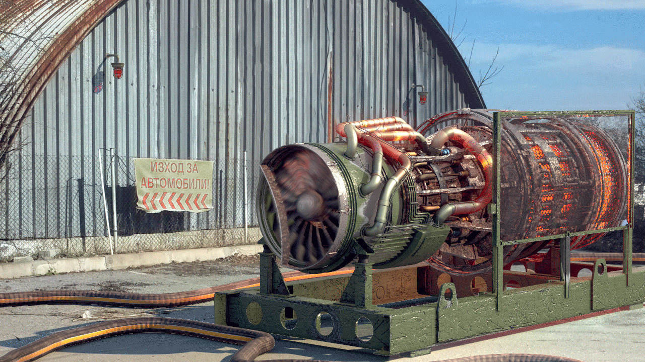

The Raw Shadows Render Element is useful for changing the appearance of shadowed areas after rendering in a compositing or image editing application. Below is an example of its use, where the Raw Shadows are added (plus) with the  vrayRE_Raw_Light pass.
Original Beauty Composite
Shadows lightened by adding the Raw Shadow Render Element

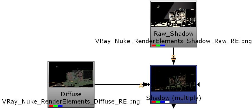

Underlying Compositing Equation
Shadow Raw x Diffuse = Shadow
