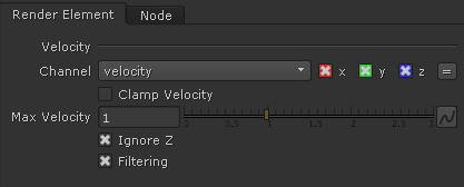

Properties
Clamp Velocity – Sets the limit for Max Velocity. When enabled, this option limits the max velocity value to 1 for floating point images, 255 for 8-bit images, or 65535 for 16-bit images. This option is useful only when writing to an 8-bit or 16-bit file format.
Max Velocity – Used to scale the velocity values written to the render element so that they fit within the range specified by the Clamp Velocity parameter. This is only useful if writing to an 8-bit or 16-bit file format.
Ignore Z – Disregards motion along the Z axis.
Filtering – Applies the image filter to this channel. Image filter settings are in the Image Sampler tab in the VRayRenderer properties.

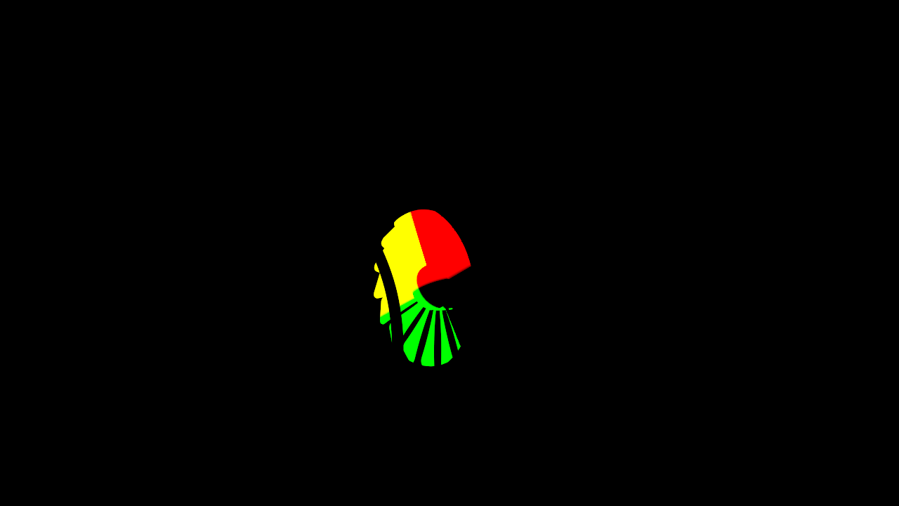

The Velocity Render Element is useful for adding motion blur in post production at a composite level without the need for re-rendering. In the composite shown below, motion blur was added based on the amount by which the color differs from medium gray. The Robot arms and the creature that were given a pale yellow color in the render element are the most blurred.
Original Beauty Composite with no motion blur added in composite
Beauty Composite with motion blur added
using the Velocity Render Element
