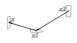

Different formulations of the rendering equation are possible, but the one proposed by Kajiya looks like this:
where:
L(x, x1) is related to the light passing from point x1 to point x;
g(x, x1) is a geometry (or visibility term);
e(x, x1) is the intensity of emitted light from point x1 towards point x;
r(x, x1, x2) is related to the light scattered from point x2 to point x through point x1;
S is the union of all surfaces in the scene and x, x1 and x2 are points from S.
What the equation means: the light arriving at a given point x in the scene from another point x1 is the sum of the light emitted from all other points x2 towards x1 and reflected towards x:
