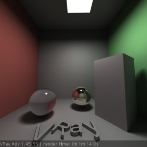

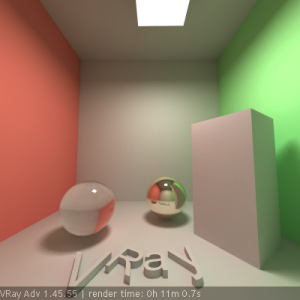

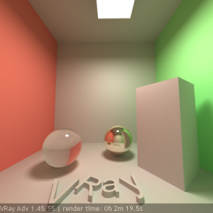

Brute force GI, 4 bounces.
The image is darker because only 4 light bounces are computed.
Notice the grain and the long render time.
 Render time: 25m 3.9s

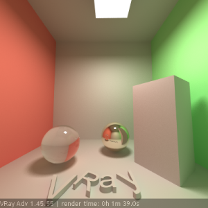

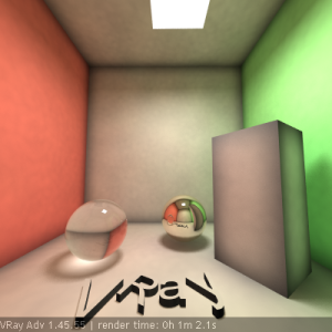

Irradiance map + brute force GI, 4 bounces.
The grain is gone, although the GI is a little blurry.
(see the GI caustics below the glass sphere).
 Render time: 5m 56.8s

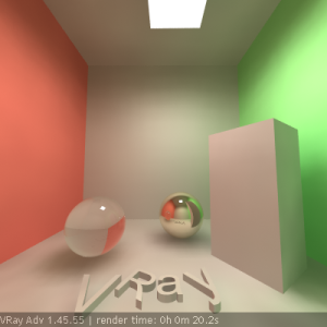

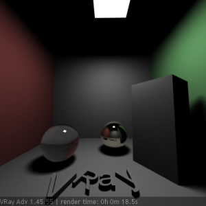

Light cache only.
Very fast, but shadows are blurry
(Store direct light for the light map is on).
Render time: 0m 20.2s

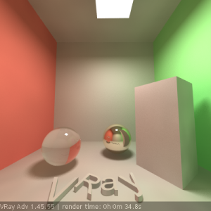

Light cache and direct lighting
(Store direct light is off).
Render time: 0m 34.8s

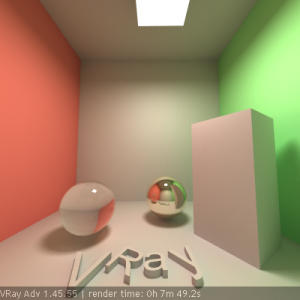

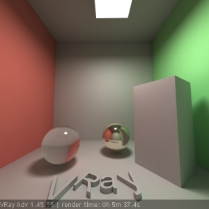

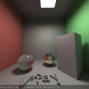

Brute force GI + light cache.
There is some grain in the GI but is a lot faster than brute force GI alone.
Render time: 5m 36.0s

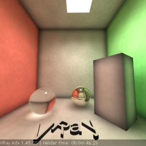

Photon map only.
Notice the caustics from the glass sphere, as well as the dark corners.
Render time: 0m 46.2s

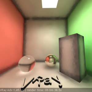

Photon map with precomputed irradiance only.
Splotchy, but faster than a raw photon map.
Render time: 0m 38.5s

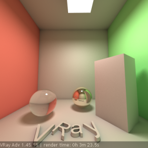

Irradiance map + photon map.
Notice the dark corners and incorrect shading on the letters.

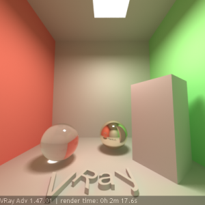

Irradiance map + light cache with GI caustics enabled.
Notice the slowdown due to the caustics.

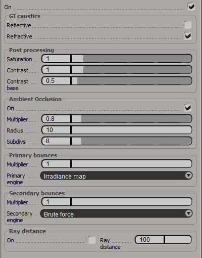

GI (Indirect Illumination) Parameters
On - turn indirect illumination on and off.
GI Caustics
GI caustics represent light that has gone through one diffuse, and one or several specular reflections (or refractions). GI caustics can be generated by skylight, or self-illuminated objects, for example. However, caustics caused by direct lights cannot be simulated in this way. You must use the separate Caustics section to control direct light caustics. Note that GI caustics are usually hard to sample and may introduce noise in the GI solution.
Reflective - this allows indirect light to be reflected from specular objects (mirrors etc). Note that this is not the same as Caustics, which represent direct light going through specular surfaces. This is off by default, because reflective GI caustics usually contribute little to the final illumination, while often they produce undesired subtle noise.
Refractive - this allows indirect lighting to pass through transparent objects (glass etc). Note that this is not the same as Caustics, which represent direct light going through transparent objects. You need refractive GI caustics to get skylight through windows, for example.

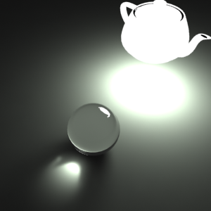

Example: GI Caustics
This example shows GI caustics generated by a self-illuminated object:
Post-processing
These controls allow additional modification of the indirect illumination, before it is added to the final rendering. The default values ensure a physically accurate result, however, the user may want to modify the way GI looks for artistic purposes.
Saturation - controls the saturation of the GI; a value of 0.0 means that all color will be removed from the GI solution and will be in shades of grey only. The default value of 1.0 means the GI solution remains unmodified. Values above 1.0 boost the colors in the GI solution.
Contrast - this parameter works together with Contrast base to boost the contrast of the GI solution. When Contrast is 0.0, the GI solution becomes completely uniform with the value defined by Contrast base. A value of 1.0 means the solution remains unmodified. Values higher that 1.0 boost the contrast.
Contrast base - this parameter determines the base for the contrast boost. It defines the GI values that remain unchanged during the contrast calculations.
Ambient Occlusion
These options allow you to add an ambient occlusion term to the global illumination solution.
On - enable or disable ambient occlusion.
Multiplier - the amount of ambient occlusion. A value of 0.0 will produce no ambient occlusion.
Radius - ambient occlusion radius.
Subdivs - determines the number of samples used for calculating ambient occlusion. Lower values will render faster, but might introduce noise.

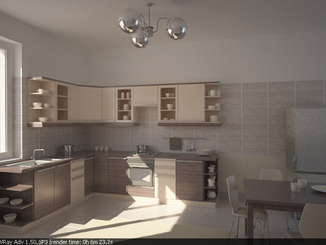

The first image to the right is rendered with the Light cache for both primary and secondary bounces, Fixed Filter type for the light cache, and Store direct light off. The second image in the center is rendered with the same light cache settings, but with global ambient occlusion enabled. The third image to the right is rendered without ambient occlusion, with Brute force GI engine for primary bounces, and the Light cache as a secondary engine with Nearest Filter type. The render times include the time for calculating the light cache. Note how ambient occlusion can produce a feeling of a more detailed image, even though the result is not entirely correct.
Ambient occlusion is off - lighting is good, but there is a lack of detail
Ambient occlusion is on - details are much more defined
Brute force GI, no ambient occlusion - details are fine, but render times is longer.
