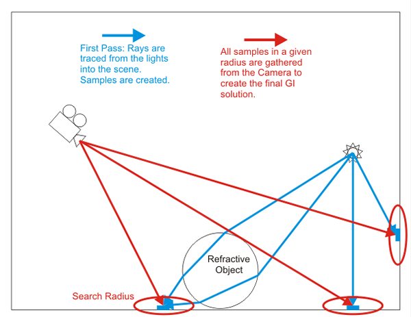

The following diagram shows the way the Photon Map is generated. In the first pass (Blue) rays are traced from each light into the scene which generates light samples across the entire scene. In the second pass all samples in a specified radius are gathered from the camera in order to create the final GI solution.

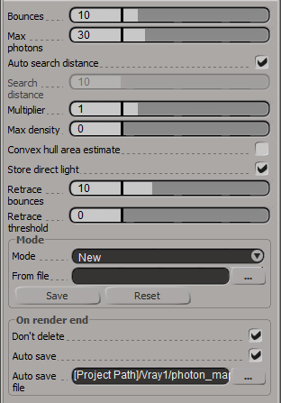

In order to have access to these settings you must enable the calculations of Global Illumination in the GI tab of the V-Ray Options and select Photon Map as either a primary bounces or secondary bounces engine.
Note that the photon map is also controlled by the photon settings of individual lights in the scene. All V-Ray lights have built-in controls for this.
Bounces - this parameter controls the number of light bounces approximated by the photon map. More bounces produce a more realistic result, but take more time and memory.
Max photons - this option specifies how many photons will be taken into consideration when approximating the irradiance at the shaded point. More photons mean a smoother (and more blurry) result and may also slow down the rendering. Smaller values mean a more noisy result but will render faster. When this value is 0, V-Ray will use all the photons in the given search range.
Auto search dist - when this is on, V-Ray will try to compute a suitable distance within which to search for photons. Sometimes the computed distance is okay, in other cases it might be too big (which will slow down the rendering) or too small (which will produce a more noisy result).
Search Distance - this option is only available when Auto search dist is off. It allows you to specify the photon search distance manually. Keep in mind that this value depends on the size of your scene. Lower values will speed up the rendering but may produce more noisy results. Larger values will slow down the rendering but may produce smoother results.
Multiplier - this allows you to control the brightness of the photon map.
Max density - this parameter allows you to limit the resolution (and thus the memory) of the photon map. Whenever V-Ray needs to store a new photon in the photon map, it will first look if there are any other photons within a distance specified by Max density. If there is already a suitable photon in the map, V-Ray will just add the energy of the new photon to the one in the map. Otherwise, V-Ray will store the new photon in the photon map. Using this option allows you to shoot many photons (and thus get smoother results) while keeping the size of the photon map manageable.
Convex Hull Estimate - when this is off, V-Ray will use a simplified algorithm for computing the area, covered by a number of photons (by only taking the distance to the farthest photon). This algorithm may cause corners to be darker. Using the convex hull area estimate avoids the dark corners problem, but is slower and not as robust.
Store direct light - when this is on, V-Ray will store direct illumination in the photon map as well. This may speed up the irradiance map or brute force GI, when used as a primary engine, and there are lots of lights in the scene. When this is off, direct lighting will be computed always by tracing the necessary rays. This may slow things down if there are lots of lights in the scene.
Retrace Bounces - controls how many bounces will be made when retracing corners. If Retrace Corners is 0.0, then this parameter is ignored. Typically this should be equal to the Bounces parameter.
Retrace threshold - when this is greater than 0.0, V-Ray will use brute force GI near corners, instead of the photon map, in order to obtain a more accurate result and to avoid splotches in these areas. This may slow down the rendering. When this is 0.0 , the photon map will be used always, which will be faster, but may produce artifacts near corners or in places where objects are close to each other.
Mode
Mode - determines the rendering mode of the photon map:
  • New - this will compute a new photon map for each frame of an animation.
  • From file - in this mode the photon map is loaded from a file. The photon map file does not include the prefiltering of the photon map; prefiltering is performed after the photon map is loaded, so that you can adjust it without the need to recompute the photon map.
... - specifies the file name to load the photon map from, when the Mode is set to From file.
Save - this button allows you to save the photon map to a file on disk, for later re-use. Note that the Don't delete option must be on for this to work - otherwise, the photon map will be deleted as soon as rendering is complete and it will not be possible to save it.
Reset - removes the current photon map from the memory
On Render End
This group of controls determine what happens with the photon map after rendering is complete.
Don't delete - when on (the default), the photon map remains in memory after the rendering. Turn this option off to automatically delete the photon map (and thus save memory).
Auto save - when on, the photon map will be automatically written to the specified file. Note that the photon map will be written as soon as it is calculated, rather than at the actual end of the rendering.
Auto Save File - specifies the file name to save the photon map to.
