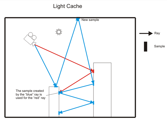

The following diagram shows the way the Light Cache is being generated. To get the lighting from the environment V-Ray traces many rays from the camera into the scene. Each bounce of light creates a sample in the light cache that can be used during the rendering. If one ray hits a sample that was created by another ray the tracing is stopped and the information from the sample is read instead. This speeds up the process a lot.

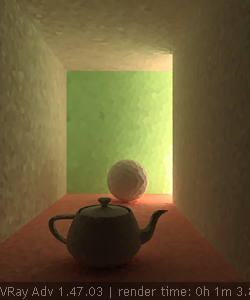

The Subdivs parameter controls the number of rays that are shot into the scene and the "noise" quality of the light cache samples.
Here is a scene rendered with different settings for the Subdivs parameter (all other settings are the same).
  • As we add more samples, the noise is reduced, but the render times increase. When the Subdivs parameter is increased twice, the light cache takes approximately 4 times as long to calculate.
