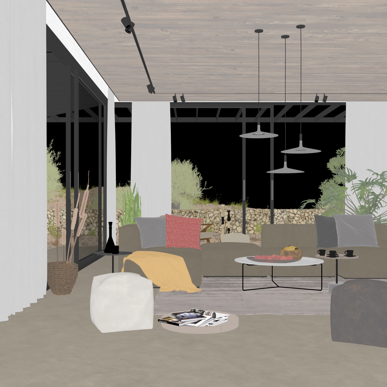

The Diffuse Filter Render Element shows the colors and textures used in materials, flatly applied to objects with no lighting information. The colors are the actual colors set in the material definition, and each texture appears as it does in the texture (file) itself. There are no highlights or shadows, and any background image is not included.

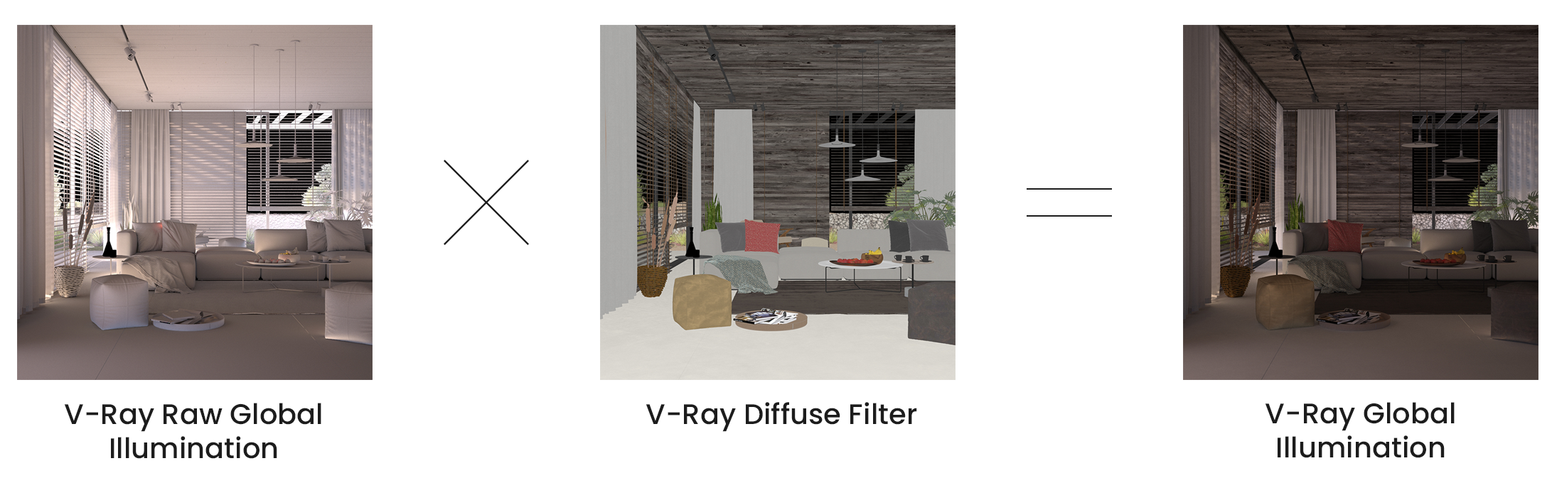

The Diffuse Filter Render Element is useful for changing the appearance of many passes, when it is combined with Raw render passes (like VRayRawGlobalIllumination, VRayRawLighting, etc.).
In the example, the Diffuse Filter is blended with the Raw Global Illumination RE in Multiply mode to provide the Global Illumination element. This way, color correction can be performed upon the raw pass, without the actual diffuse colors changing, making it possible to tint a pass in a realistic way without re-rendering.

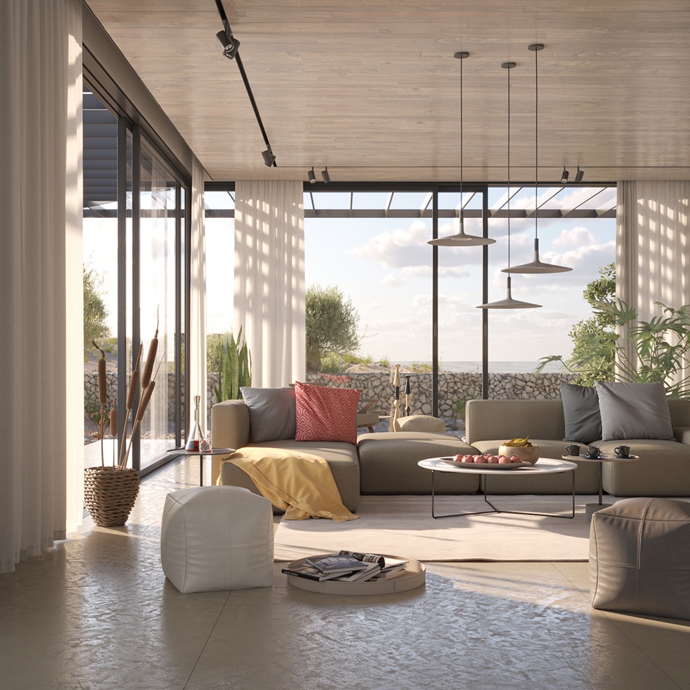

Original Beauty Render Element
