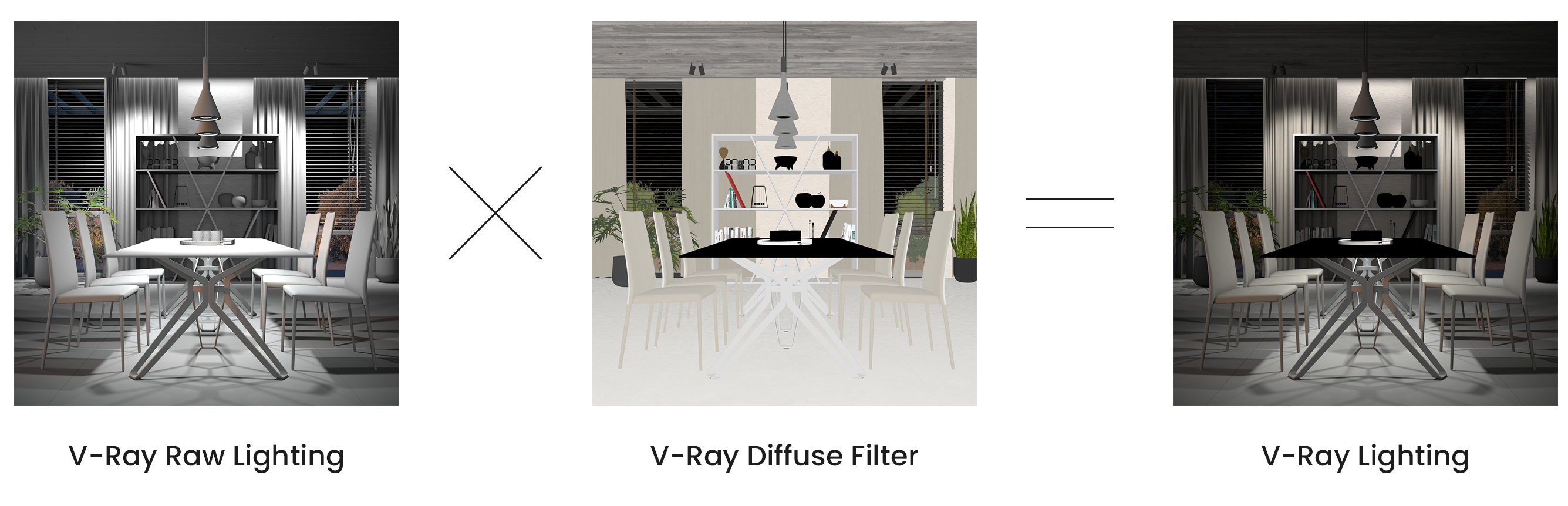

The Raw Lighting Render Element is useful for changing the appearance of direct lighting in a compositing or image editing software. In this example, you can see how the image looks before and after post-production.
Before
After
Underlying Compositing Equation
VRayRawLighting   x VrayDiffuseFilter = VRayLighting
