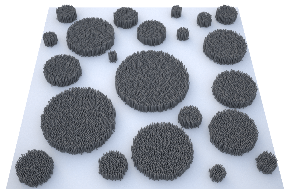

Editing the Expression
  1. If we edit the expression of the Length attribute through the Sigma button from this:
    $a=map('${DESC}/paintmaps/length');#3dpaint,200.0
    $a
    to this, we can invert the result of the map:
    $a = 1.0 - $a;
    $a
  2. Add a dome light with an HDRI dome tex to the scene, apply V-Ray Materials, and render. We should see something like this:
