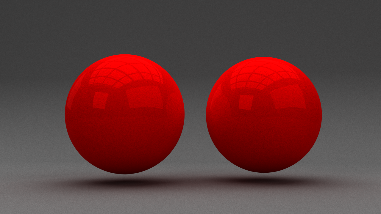

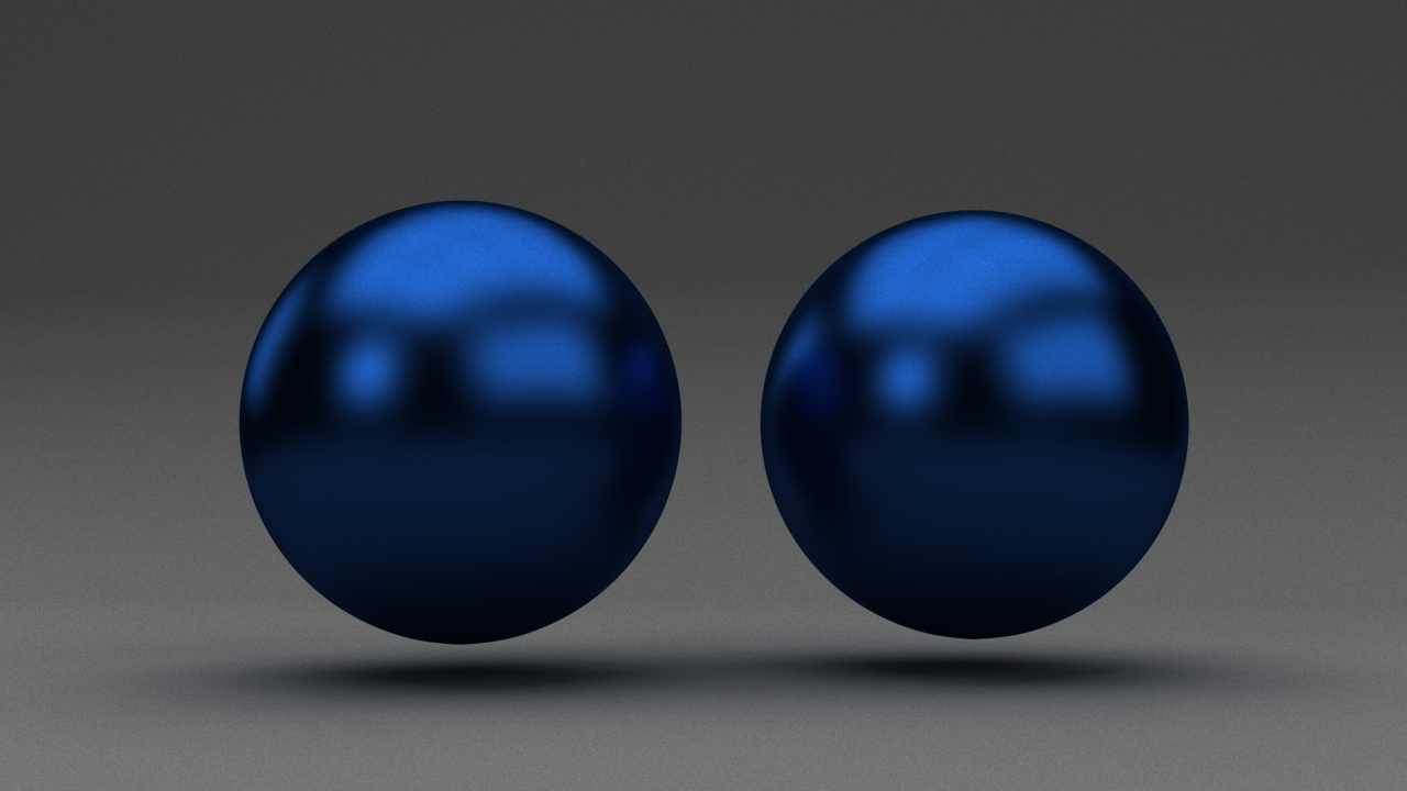

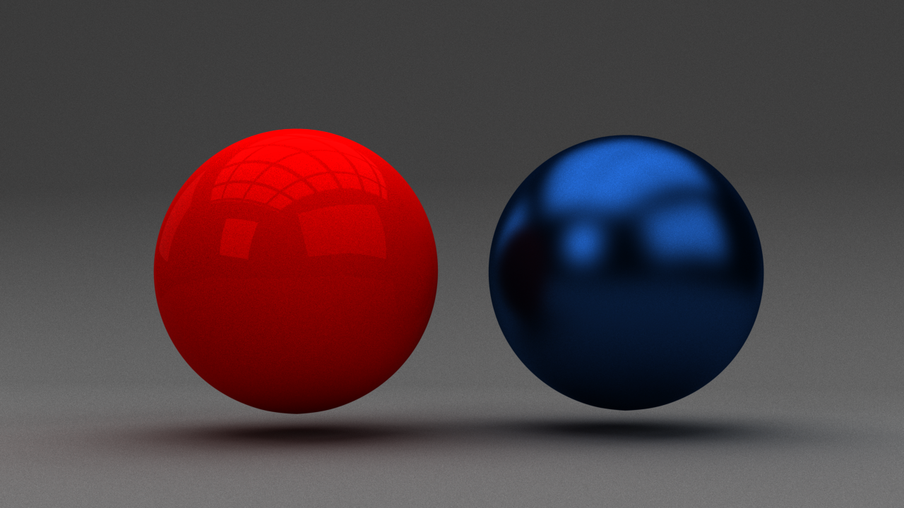

Here are some simple examples for overriding a material with Material Override.
Material Override is off
Single Object's material is overridden
Multiple Objects' materials are overridden

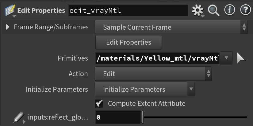

1. Go to the Geometry Spreadsheet panel and locate the material you wish to alter.
2. Right-click the material parameter in Details and select Edit Parameter. This automatically creates a new node - Edit Properties.
3. In the Edit Properties node parameters, tweak the material property. Repeat the steps for each material parameter you want to change.

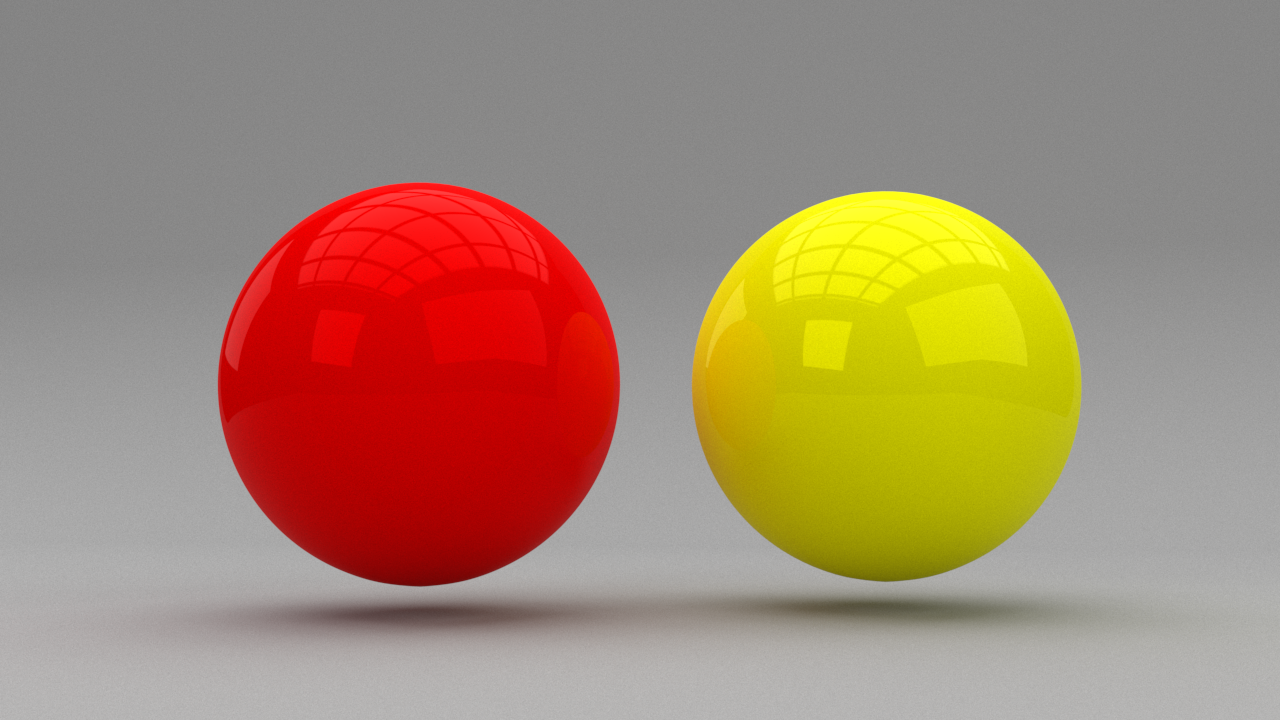

Original colors
Reflection Glossiness is reduced to 0 in the Edit Properties node
Reflection Glossiness of Yellow material is overridden

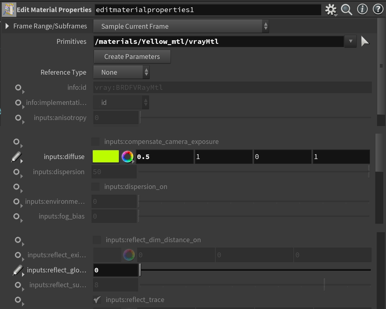

1. Create an Edit Material Properties LOP (right-click in /stage > Materials > Edit Material Properties) and chain it to the other nodes.
2. Add the path or directly drop the material/texture you want to edit into the Primitives.
3. Click Create Parameters.
4. Choose Set or Create for the USD parameters you want to override.
You can also fetch the material network and alternate whatever you want inside it. Note that this workflow works only for non-V-Ray materials such as MaterialX materials.

Original Materials
Diffuse Color is changed to green and Reflection Glossiness is reduced to 0 in the Edit Material Properties node
Diffuse Color and Reflection Glossiness of Yellow material are overridden
