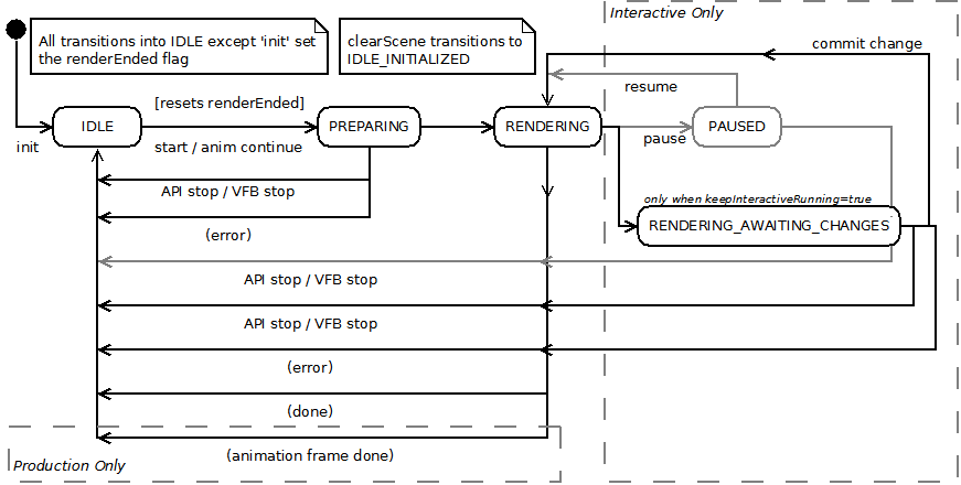

State Changed Event
The state change event is emitted every time the renderer transitions from one state to another, such as when starting to render, when the image is done or when an error occurs and it stopped. This is the main point to implement user logic related to initiating and completing renders.
Unless startSync() is used instead of the asynchronous start() method, no changes should be made to the scene and renderer while in the PREPARING state before transitioning out of it. Attempting to make changes will be rejected.
The final image is available when the renderer gets to the IDLE_DONE state. Intermediate images are also available during rendering.
