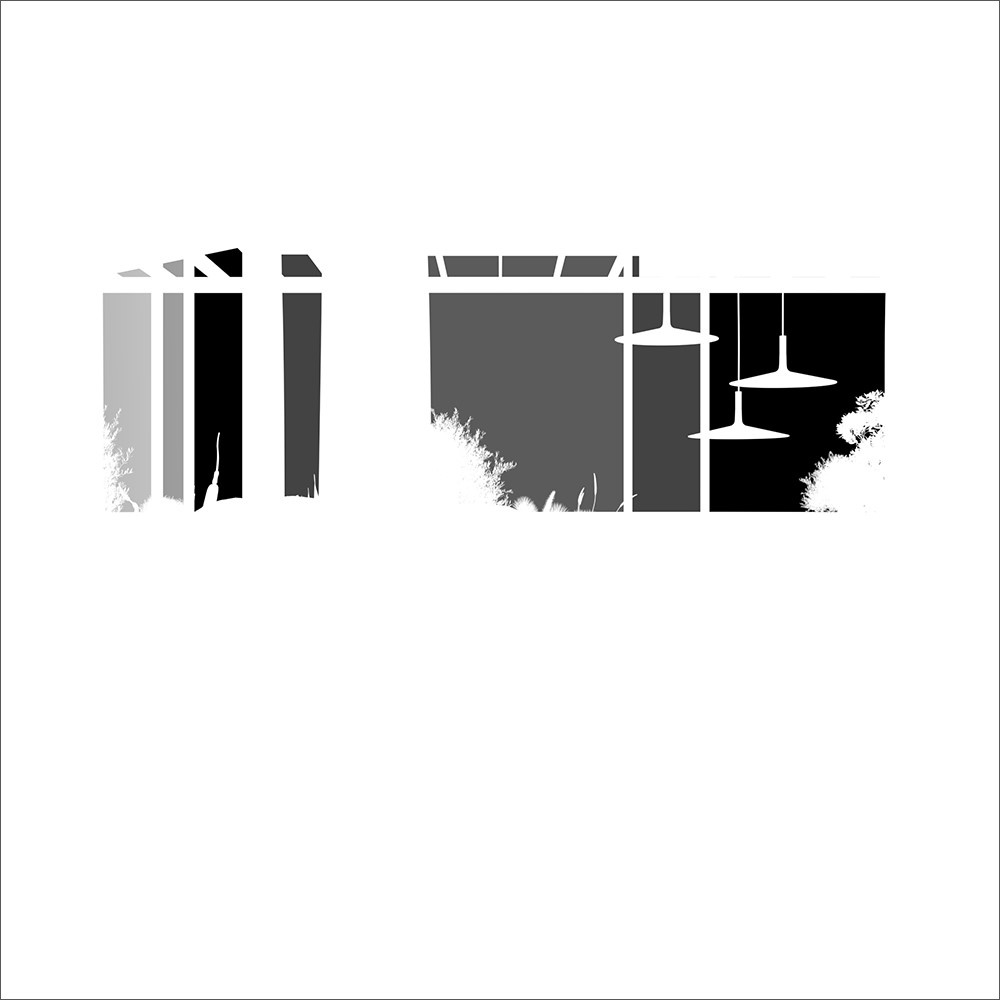

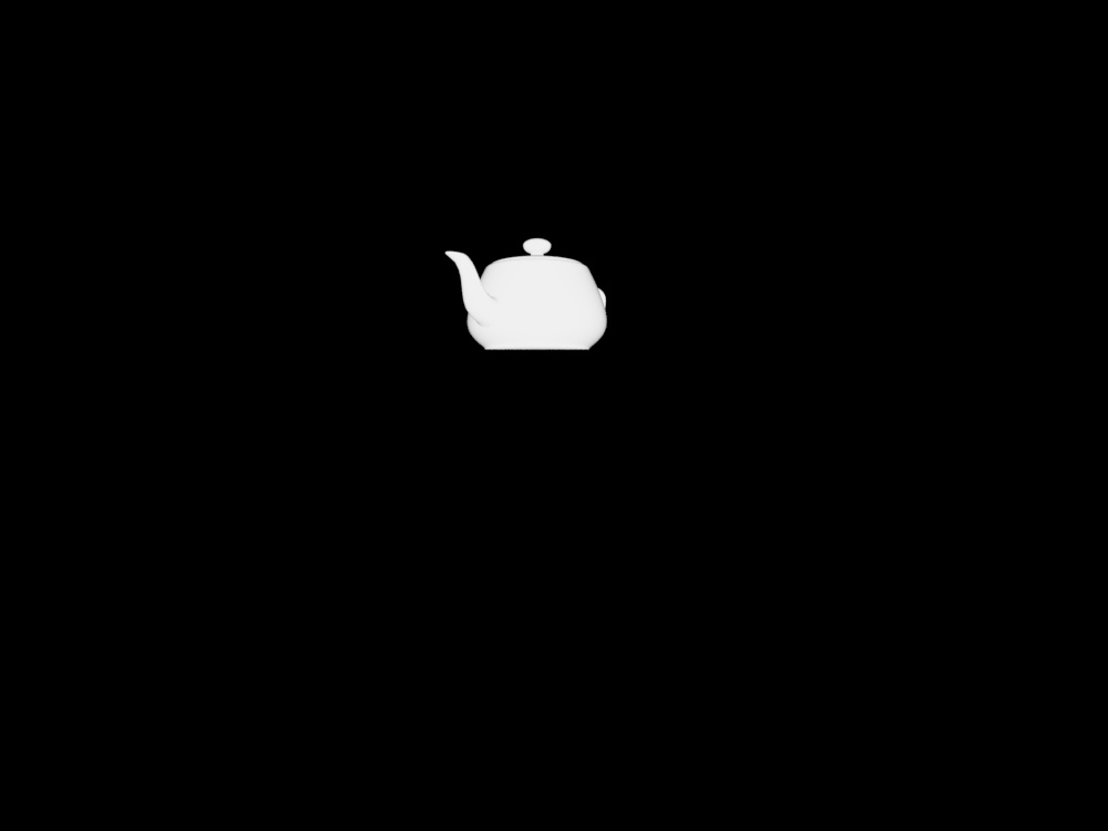

Alpha
Type: RenderChannelColor
The Alpha Render Element shows the transparency of objects in the scene as grayscale colors. Solid geometry is represented by solid white, while those areas not blocked by geometry within the scene are black. Pixels at antialiased edges have varying shades of gray, as do semi-transparent surfaces.
Common Uses
The Alpha Render Element is primarily used as a mask to enable other elements to be placed behind the Beauty composite, such as the Background Render Element. The Alpha Render Element shown below considers the glass's transparency in the windows, including the frosted glass made semi-transparent by a texture mask in the glass material.
Beauty composite with no background
New Beauty composite with the Background Render Element behind the original Beauty composite
When using transparent materials such as glass, make sure that the material is set up to treat the material as transparent with regard to the Alpha channel. For example, when using VRayMtl as the material, set the Affect channels parameter for Reflection (reflect_affect_alpha) and Refraction (refract_affect_alpha) to Color+alpha or All channels. Otherwise, the transparent surface will not be treated as transparent in the Alpha Render Element.

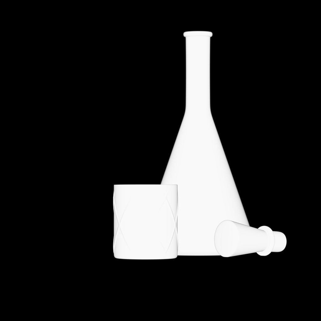

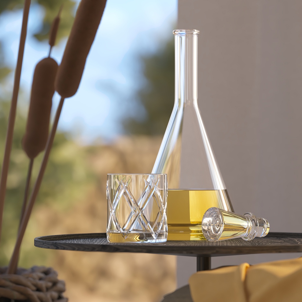

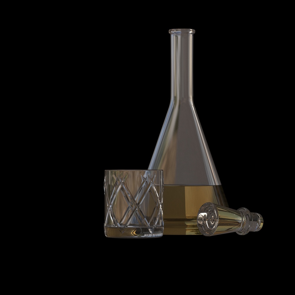

Background
The Background Render Element stores an image of the texture used in the background behind geometry in a scene as seen from the camera. Geometry that blocks the background image renders as black.
This render element interprets a background texture, such as the texture set in the Environment settings, as the background; other types of manually created backgrounds, such as a plane mapped with a texture set outside a window, is not interpreted to be the "background" for this render element.
The Background Render Element is primarily used for layering the Beauty element (or combined render elements) on top of the background image. The Alpha Render Element can be used to create a matte for such a composite.
Beauty Render Element without Background Render Element
When the background is behind a transparent or semi-transparent material such as glass or clear plastic, make sure the Alpha channel is enabled for the material for all render elements; otherwise, the background is not visible in the render element. For example, when using VRayMtl for a glass material, set the Affect channels parameter for both Reflection and Refraction to All channels to cause the background to appear in the Background Render Element behind the glass.

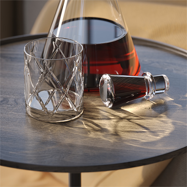

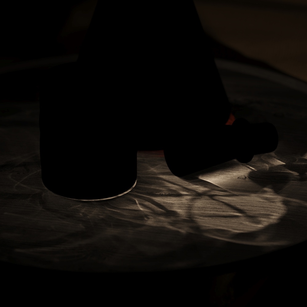

Caustics
Caustics is an effect that is produced when light rays are reflected or refracted by the materials within a scene, which can produce light patterns on the same object or on other objects. The Caustics Render Element stores the effects that are generated with Caustics photon mapping. This render element is useful for enhancing or toning down caustic effects in the composite.
The Caustics Render Element is useful for changing the appearance of caustic elements after rendering in a compositing or image editing application. Below is an example of its use.
Original Beauty Composite
Brightened caustics
The Caustics Render Element is added to the Beauty render to form the final image.

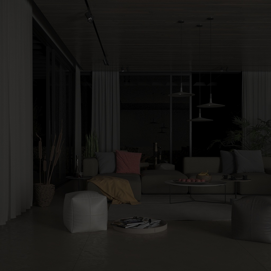

Self Illumination
The Self Illumination Render Element isolates self-illuminated materials, including V-Ray Mesh Lights, objects with the VRayLightMtl, and any objects with Self-Illumination enabled in their V-Ray material. This render element is useful for brightening or color-correcting self-illuminated materials in the final composite.
For example, the material VRayMtl has a parameter for self-illumination. If this parameter is set to a non-black color value, this render element shows the results of the self-illumination.
The Self Illumination Render Element is useful for changing the appearance of self-illuminated surfaces after rendering in compositing or image editing software. Below are two examples of its use.
Color of self-illuminated surface changed in composite
Intensity of self-illuminated surface reduced in composite
The Self Illumination Render Element is added to the Beauty render to form the final image.

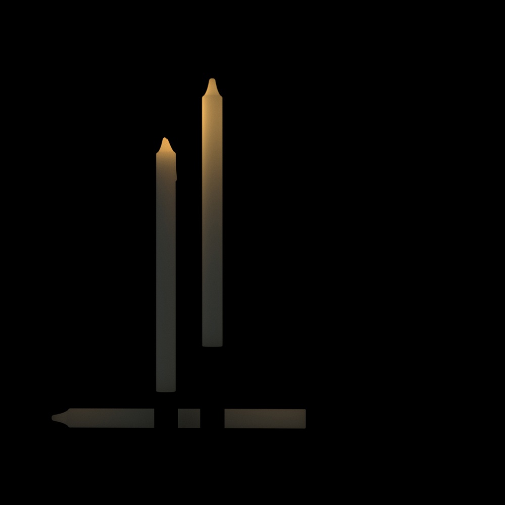

Subsurface Scattering
The Subsurface Scattering Render Element stores subsurface information from VRaySSS2 materials as an image. This render element can then be used to enhance or color-correct just the subsurface scattering component of the image during the compositing process.
The Subsurface Scattering Render Element is useful for changing the appearance of SSS2 elements after rendering in a compositing or image editing software. Below is an example of its use.
Color of Subsurface Scattering on the candles changed
The Subsurface Scattering Render Element is added to the Beauty render to form the final image.

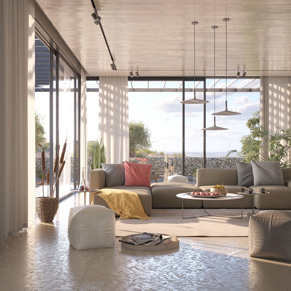

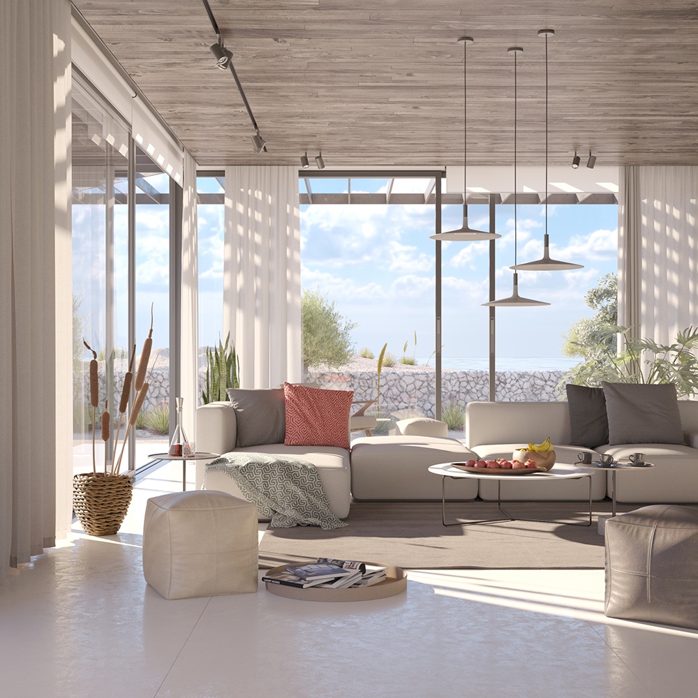

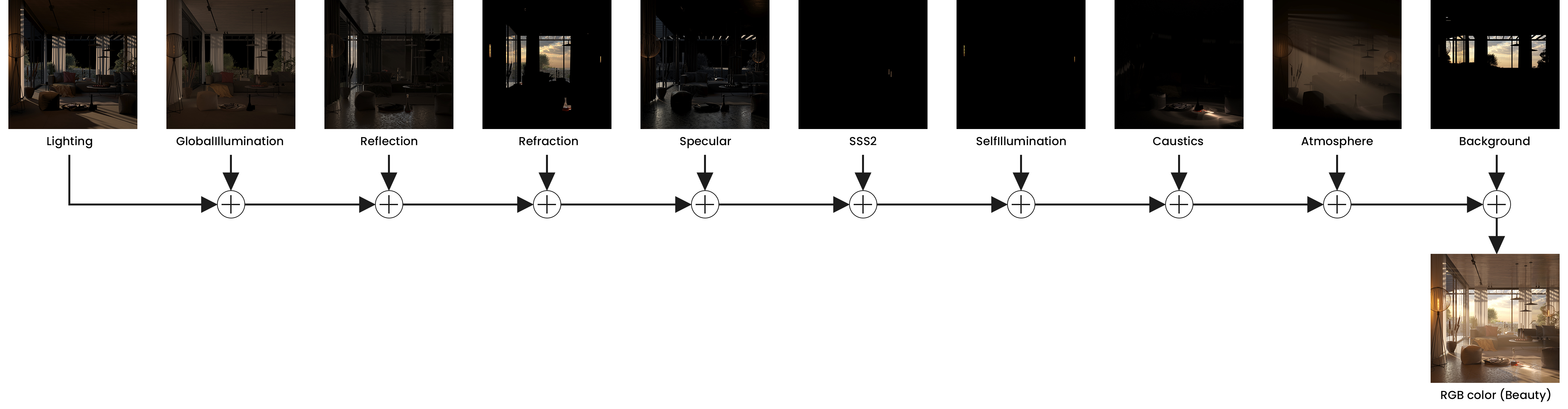

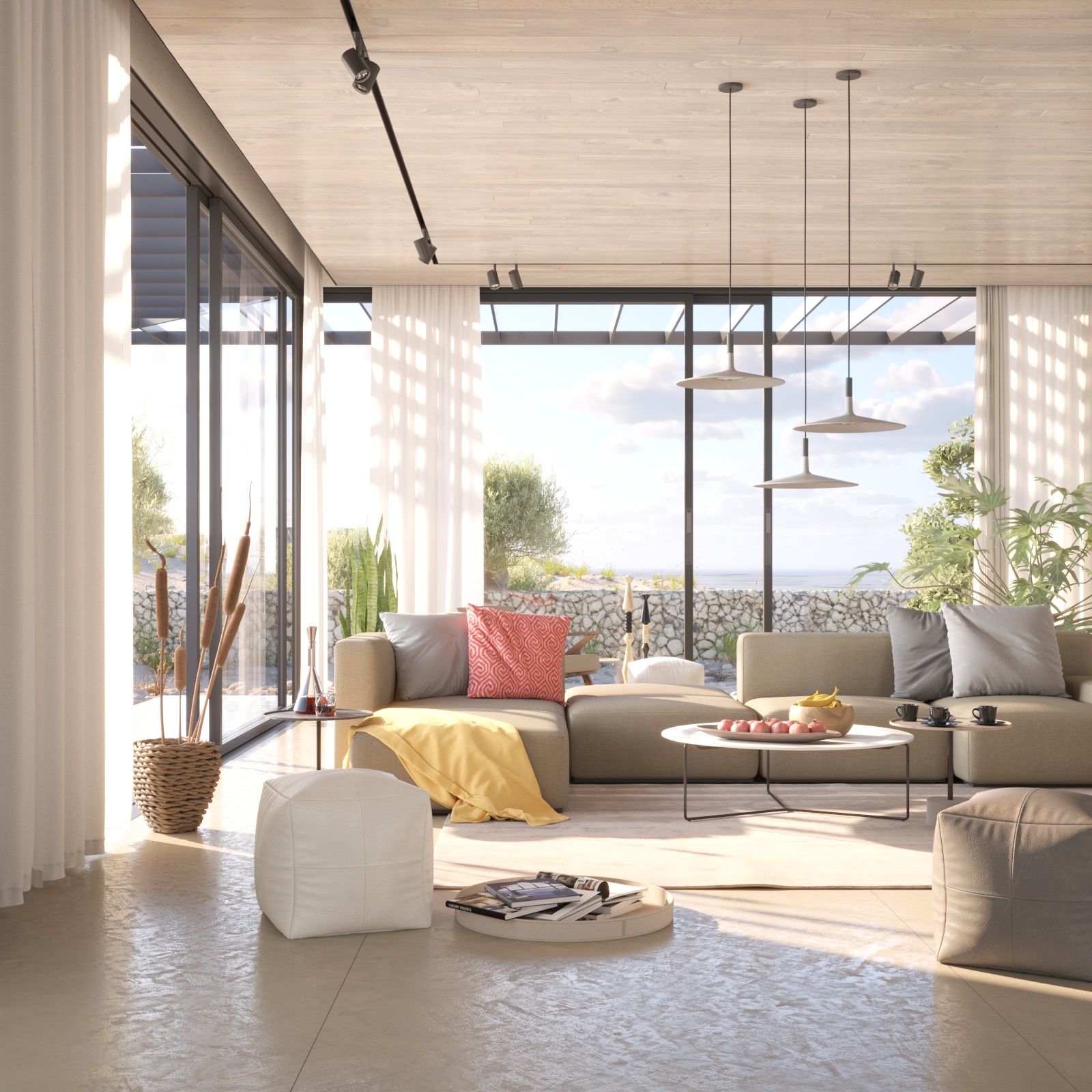

The Beauty Render (RGB_Color) is V-Ray's pre-composited final render and is usually the primary export when rendering a scene. This pass can be re-created manually in a composite by assembling the proper components and fine-tuning the components. This process is commonly called Back to Beauty Compositing.
The following is the base formula for reconstructing the Beauty pass. Some Render Elements can be excluded if the scene does not utilize them. Click the image to see the full-size version and zoom in to view all the render elements involved.
Lighting + Global Illumination + Reflection + Refraction + Specular + SSS2 + Self Illumination + Caustics + Atmosphere + Background = RGB_Color (Beauty)
Advanced Back to Beauty
Occasionally, there may be a need for more specific editing of the final image. There's a more detailed workflow than the standard back-to-beauty workflow for this. Click the image to see the full-size version and zoom in to view all the render elements involved.
Diffuse Filter x (Raw Lighting + Raw Global Illumination)) + (Raw Reflection x Reflection Filter) + ( Raw Refraction x Refraction Filter) + Specular + SSS2 + Self Illumination + Caustics + Atmosphere + Background = RGB_Color (Beauty)
There are two options for handling Motion blur and Depth of Field in the back-to-beauty composite. If Depth of field and Motion blur are enabled in the V-Ray Physical Camera, these effects will already be baked into all render elements. In this scenario, using the filter render elements in the advanced back-to-beauty composite can offer finer control of some render elements. Alternatively, many compositing and photo editing packages can add the effects post-rendering using specific tools that utilize VRayVelocity for motion blur and VRayZDepth for depth of field, with some limitations.

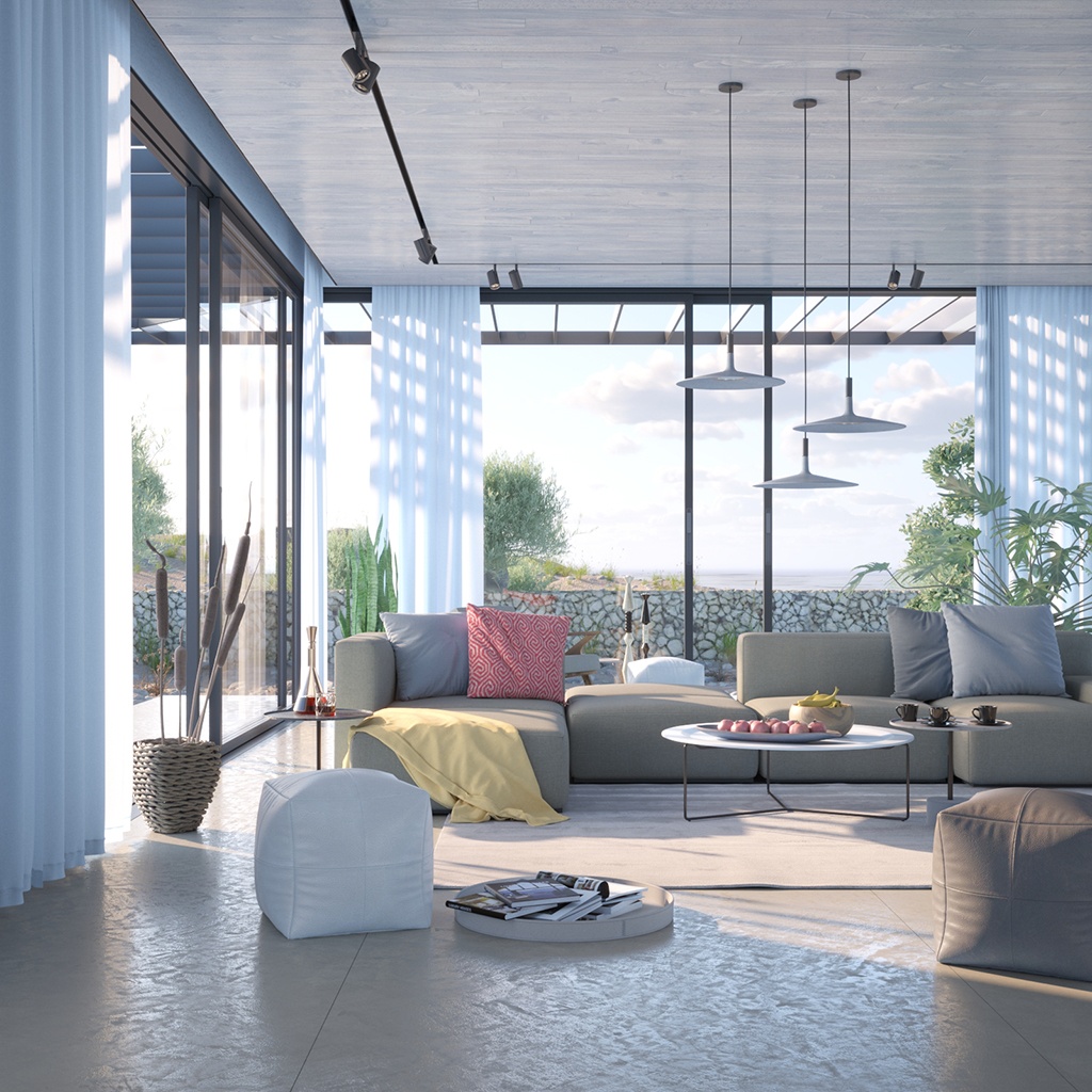

Global Illumination Render Elements
Global Illumination is the indirect lighting bouncing around within a scene to contribute to the overall illumination, as opposed to direct lighting from a light source. This page overviews the two global illumination render elements that may be created through V-Ray and how they are used in compositing. Specific usage for each of these global illumination elements is explained in the Overview.
GI
Raw GI
The Global Illumination Render Elements store indirect lighting information calculated in the scene. The following passes may be generated:
The Global Illumination Render Element (VRayGlobalIllumination) can be used in Back to Beauty compositing to add the GI lighting contribution to the scene. The GI contribution may be adjusted (tinted, brightened, darkened, etc.) in the composite without re-rendering the scene.
When even more control over the GI contribution to the final image is desired, this main Global Illumination Render Element can be re-created by multiplying the Raw Global Illumination Render Element with the Diffuse Filter Render Element:
Raw Global Illumination x Diffuse Filter = Global Illumination
Examples
When Raw Global Illumination is needed in the composite, please also render the Global Illumination element (VRayGlobalIllumination) and the Raw GI element (VRayRawGlobalIlumination).

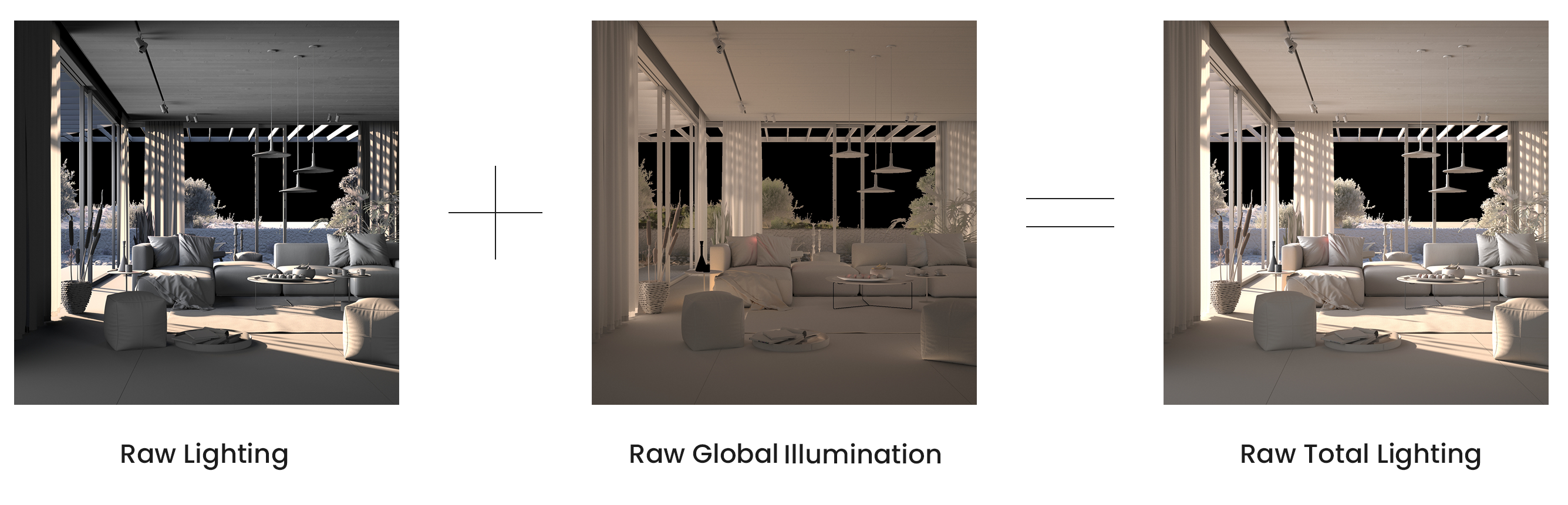

Lighting Render Elements
V-Ray Lighting Render Elements are a group of elements that store lighting information from the scene. Each element can be individually adjusted during the compositing phase to change the Beauty Pass without rerendering.
The Lighting Render Elements are:
  • Lighting (VRayLighting) – Stores direct lighting information from lights in the scene, including the diffuse contribution.
  • Light Select (VRayLightSelect) – Stores direct lighting information from user-selected lights in the scene; can be limited to the light's raw, diffuse, or specular contribution.
  • Raw Lighting (VRayRawLighting) – Stores the effects of direct lighting on scene objects without the diffuse contribution.

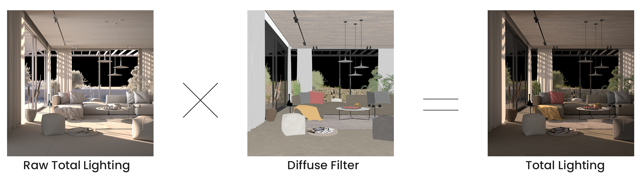

  • Total Lighting (VRayTotalLighting) – Stores the effects of both direct and indirect lighting on materials in the scene, including the diffuse contribution.
  • Raw Total Lighting (VRayRawTotalLighting) – Stores the sum of both direct and indirect lighting in the scene without the diffuse contribution.
All of them are of the type: RenderChannelColor
Examples
Lighting
Light Select - dome light
Light Select - plane light
Raw Lighting
 Total Lighting
Raw Total Lighting

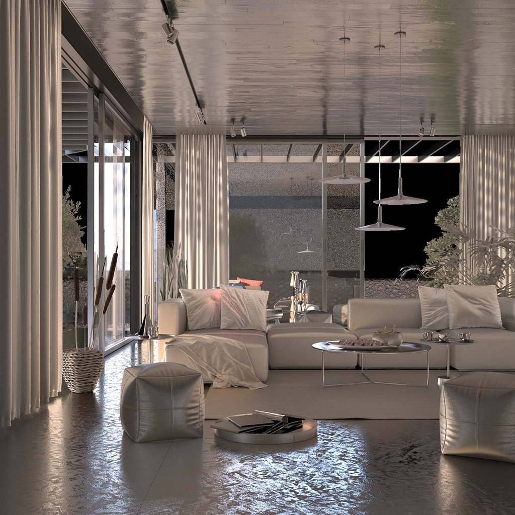

  • Lighting can be added or subtracted at a composite level using Lighting Render Elements.
  • Lighting can be color corrected.
  • When using Light Select, lights can be turned on and off at a composite level without rerendering.

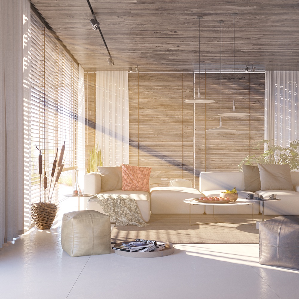

The Lighting Render Element is the same as Raw Lighting multiplied by Diffuse Filter.  Lighting Render Element is provided as a convenience to the compositor.
Brightened Lights
Tinted Lights
Raw Lighting x Diffuse Filter = Lighting

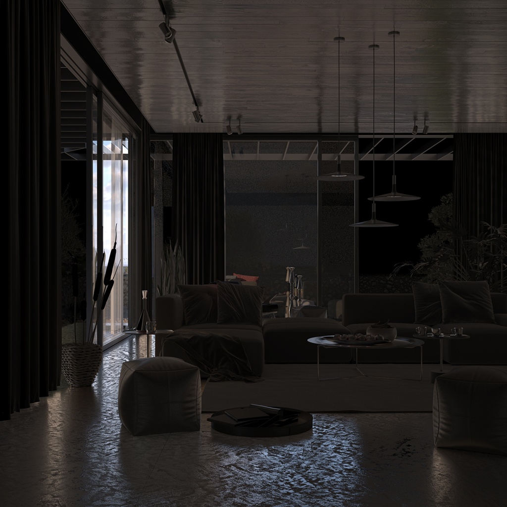

Light Select
Type: RenderChannelLightSelect
The Light Select Render Element represents the lighting contribution from one or more selected lights in the scene. Each Light Select channel can output selected lights' raw, diffuse, or specular contributions to the illumination or overall (normal) contribution. When multiple lights are selected, all the contributions from the selected lights are combined into a single render element. Multiple Light Select elements can be rendered for a single scene, and lights may be included in more than one Light Select element.
This element is similar to the Lighting Render Element. However, the Lighting element combines the effect of all lights in the scene, while the Light Select element allows for a user-selection light or set of lights to be broken out, showing their own individual effect(s) on the scene's illumination. Using these render elements, specific lights in the resulting render can be adjusted (color, temperature, brightness, etc.) in a composite without rerendering.
For example, by generating a Light Select element for all of the backlights in a scene, an artist may adjust the backlighting of the rendered scene easily in the composite without affecting the rest of the scene's illumination.
The following diagram shows the compositing formula to recreate all the light in a scene in its most basic form, but only when each light is accounted for in exactly one Light Select element for a particular mode. If a particular light is used in more than one Light Select element, this equation will result in brighter lighting than intended because that light will contribute to lighting more than once.

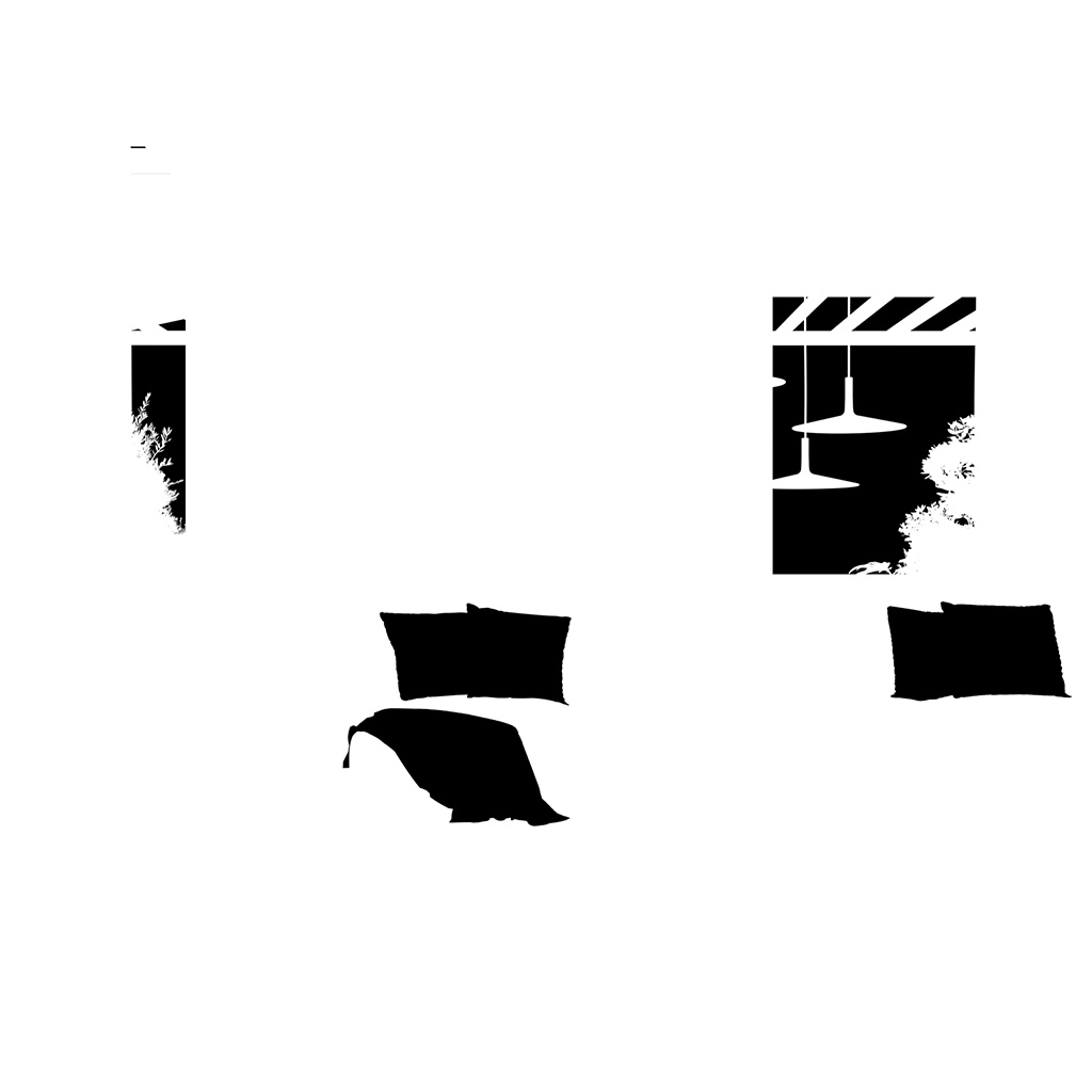

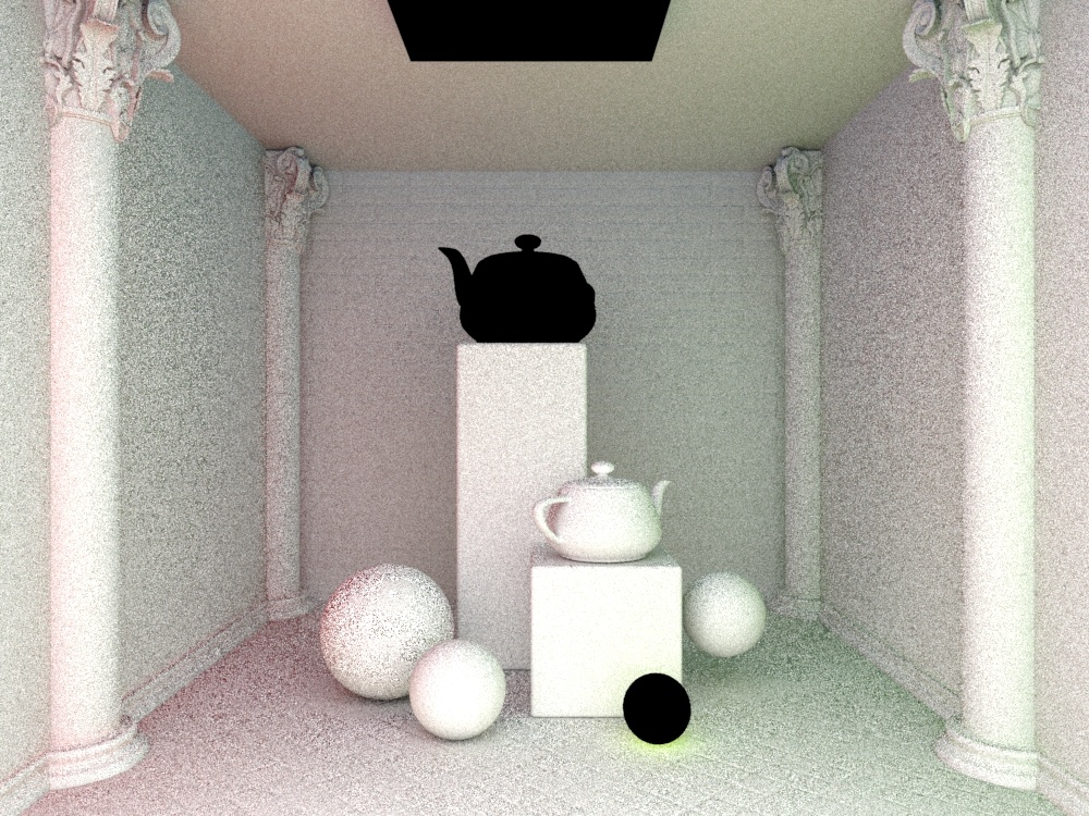

Shadow Select
The Light Select Render Element (RenderChannelLightSelect::light_select_mode) represents the lighting contribution from one or more user-selected lights in the scene. The shadow modes (Direct diffuse shadow and Direct specular shadow) render a color image that works as a reverse mask for shadows caused by a specific light(s). It can lighten, darken, or tint the shadows in post-production.
The Direct Diffuse Shadows channel outputs only the shadows cast by objects illuminated by pre-selected lights. This option has the same output as the Shadow render element. Works with all V-Ray materials that have diffuse (which excludes Stochastic Flakes and V-Ray Flakes 2). V-Ray Toon material is not supported.
The Direct Specular Shadows channel outputs the specular information from the shadows cast by objects illuminated by a pre-selected light. The objects that the shadows are cast on must have reflective material for this channel to be visible. It works with all V-Ray materials that have reflection and glossiness values less than 1.
The Matte Objects Only option (light_select_matte) renders object shadows generated by a predetermined light source onto a matte surface (object with matte properties assigned). It is available for the Direct diffuse shadow Type only. It can add 3D elements to the composite's background image or footage.
Example: Shadow Select

Raw Total Lighting x Diffuse Filter = Total Lighting
Raw Total Lighting
The Raw Total Lighting Render Element is the sum of all raw lighting (both direct and indirect) in the scene, without any diffuse details. This render element is useful for changing the appearance of the scene's lighting in a compositing or image editing application.
The Raw Total Lighting Render Element is useful for changing the appearance of the entire scene lighting after rendering, using a compositing or image editing application. Below are a couple of examples of possible uses. The first two images show the render element itself and the Beauty render put together. In the following examples, a Matte Render Element was used to isolate different parts of the scene. Then, the Raw Total Lighting Render Element was brightened and tinted differently to show the range of editing possible.

Raw Lighting + Raw Global Illumination = Raw Total Lighting

The Specular Render Element is added to the Beauty composite to form the final image.
We'll leave the advanced Beauty render elements - Atmosphere, Background, Caustics, Self Illumination, and Subsurface Scattering for the next chapter.

	// Intensity of GI before multiplication with the diffuse filter
	reManager.add('raw_gi');
	// Direct lighting without diffuse color
	reManager.add('raw_light');
	// Sum light without diffuse color
	reManager.add('raw_total_light');

	// --- MATTE ELEMENTS ---
	// Matte elements are used for masking out parts of the frame when compositing.
	// Color is based on material ID, see MtlMaterialID plugin
	reManager.add('material_id');
	// Color is based on the objectID of each Node
	reManager.add('node_id');
