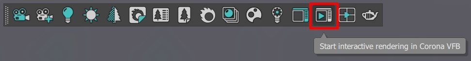

Starting Corona Interactive Rendering in a Floating Window
To start Interactive Rendering in a floating window, click the "Start Interactive rendering in Corona VFB (legacy)" button in the Chaos Corona Toolbar or go to the Render Setup > Scene tab and click the Start Interactive button:
Starting Corona Interactive Rendering in a floating window from the Chaos Corona Toolbar.

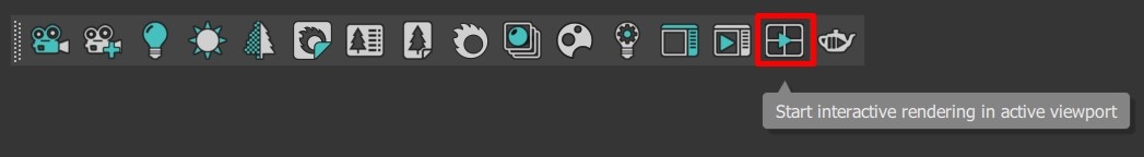

Starting Corona Interactive Rendering in the Active Viewport
To start Interactive Rendering in the active viewport, click the "Start Interactive rendering in active viewport" button in the Chaos Corona Toolbar:
Starting Corona Interactive Rendering in the active (docked) viewport from Chaos Corona Toolbar.
Corona Interactive Rendering docked in the viewport.
