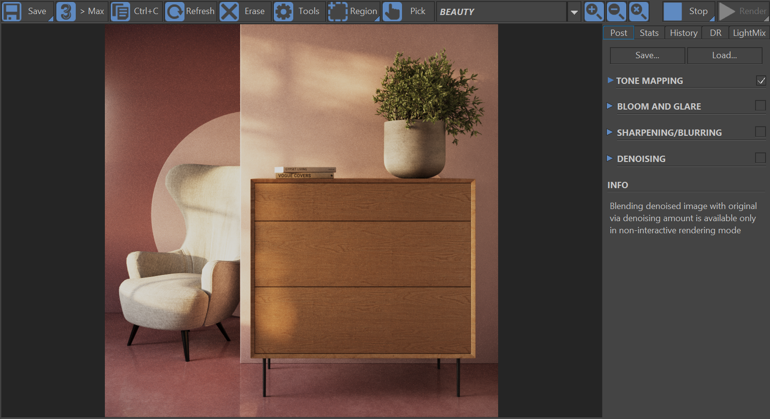

Corona includes its own Virtual Frame Buffer (VFB) window and interface that has been tuned to the most common needs of artists and can provide a very decent post-production experience and results.
Corona VFB (Virtual Frame Buffer)
Corona VFB Buttons
ButtonDescription
Saves the render element currently displayed in the VFB using a specified file format.
Press and hold the "Save" button:
Save allSaves each render element as a separate file using a specified file format.
Save CXR Stores all the information from the VFB (all render elements, including the LightMix, tone mapping, denoising data, etc.) inside a single CXR file.
Copies the content of the Corona VFB to the native 3ds Max VFB.
Copies the render element currently displayed in the VFB to the clipboard.
Useful for pasting the content of the VFB into other apps without saving the file.
Forces a VFB refresh. Useful mostly when using very high VFB update interval values.
Clears the VFB.
Toggles visibility of the side panel.
Toggles render region drawing mode.
Left-click and hold to draw a region. Drag region border with Control key to enable "fuzzy regions".
Holding the mouse over the Region button toggles all regions on and off (Disable All), and remove all (Remove All) existing regions.
Allows to pick object from VFB.
Left-click to select an object. Right-click to select and object or set camera focus to the selected point in scene. Works also in interactive rendering.
Selects the render element to be displayed in the VFB.
Zooms in.
Zooms out.
Resets zoom.
Stops the rendering process without discarding any additional data or post-rendering actions.
This is the same as the "Stop" button in the 3ds Max rendering dialog - when denoising is enabled, pressing this button stops the rendering process and proceeds to denoising.
However, Cancel button stops render and discard denoising or post-rendering actions as well as skips saving output files (if were set up).
Press and hold "Render" button:
Render – Starts render.
Start IR Starts Interactive Rendering.
Resume last – Resumes last render.
Resume file – Resumes rendering based on a previously saved CXR file.

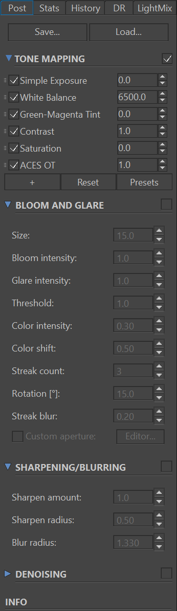

Post Tab
Tone Mapping
Basic
Contrast – Changes contrast - the difference in brightness between light and dark areas of the image. Values greater than 1 increase the image contrast, and values below 1 decrease it.
Photographic Exposure – Changes overall exposure of the image based on the settings of the currently used camera.
Saturation – C ontrols the overall image saturation, negative values decrease it.
Tint – S ets the overall color tint of the scene. The entire image is multiplied by this color. This can be used both to add and remove color tints from the image. To add a tint, select the color of the tint directly. To remove tint from any rendered object, pick its color using the pick inverse eyedropper in Corona Improved Color Picker.
Vignette – S imulates the real-world camera vignette by darkening the edges of the image.
White Balance Sets the white balance point using Kelvin temperature, often used in photography. Lower temperature leads to a bluish, cold appearance of the image, while higher temperature leads to a warm appearance.
Curve Control
Advanced Filmic Mapping Applies highlight compression and shadow saturation control using Filmic S-curve. Allows more control over the curve compared to the basic Filmic operator. When enabled, the output is always in the interval [0, 1] so the bright pixels are compressed.
Curves – Applies custom color mapping curves.
Filmic Mapping – Allows highlight compression and shadow saturation control using Filmic S-curve.
Tone Curve – Allows independent control of different tones of the image - shadows (the darkest areas), darks, light, and highlights (the brightest areas).
Highlight control
Reinhard Highlight compression – Compresses highlights in the image to reduce/remove burned-out areas. Increasing the value removes burned-out areas, and decreasing it amplifies highlights.
Final look
ACES OT (Output Transform) – Applies approximate ACES Output Transform which is consisting of Reference Rendering Transform (RRT) and Output Device Transform (ODT).
LUT – Changing the overall look of the image by applying a predefined LUT.
The effect of this operator may not be unmapped correctly in CoronaTonemapContol, especially with the logarithmic option enabled or opacity set lower than 1.
Bloom and Glare
Size Increases/decreases bloom and glare size.
Bloom intensity Increases/decreases bloom intensity.
Glare intensity Increases/decreases glare intensity.
Threshold Controls the minimum brightness which is considered for the Bloom and Glare effect. Increasing the threshold applies Bloom and Glare only to the brighter pixels. Reducing it allows the Bloom and Glare effect to be applied to pixels that are less bright.
Color intensity Controls how saturated the Bloom and Glare effect is. Higher values mean higher saturation.
Color shift Changes the hue of the coloring added to the Bloom and Glare effect.
Streak count Defines the number of streaks for the glare effect.
Rotation  Rotation of the glare effect in degrees.
Streak blur – D ecides whether the glare streaks should be sharper or more blurry.
Custom aperture  Launches an editor which can be used to fine-tune advanced Bloom and Glare options.
Sharpening/Blurring
Sharpen amount The value that is used to control sharpening.
Sharpen radius Defines the sharpness radius.
Blur radius Defines the radius of blur.
Denoising
Denoise amount The main value that is used to control denoising. It blends between the original (noisy) image and the fully denoised version of the image, where 0 is the original image and 1 is the purely denoised version.

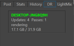

DR Tab
The DR Tab provides information on Corona Distributed Rendering.
Please note that the example image is for illustration purpose only and may not be an exact representation of the values you see.
DESKTOP - JNG8Q9H – Resolved name of the render node.
Updates Displays the count of how many times the render node has sent the rendered data to the master machine.
Passes – Displays the current number of passes render node has rendered.
Rendering – Shows the current stage of the rendering (Starting, Rendering, or Finished)
17.1 GB / 31.9 GB – Committed/Physical RAM installed in the system.
