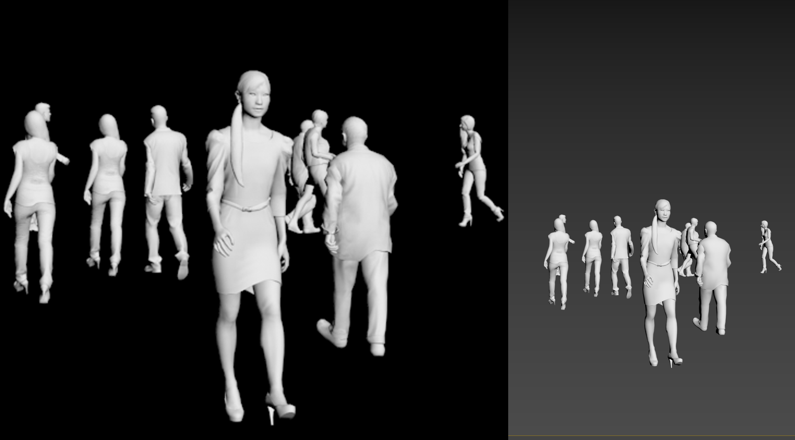

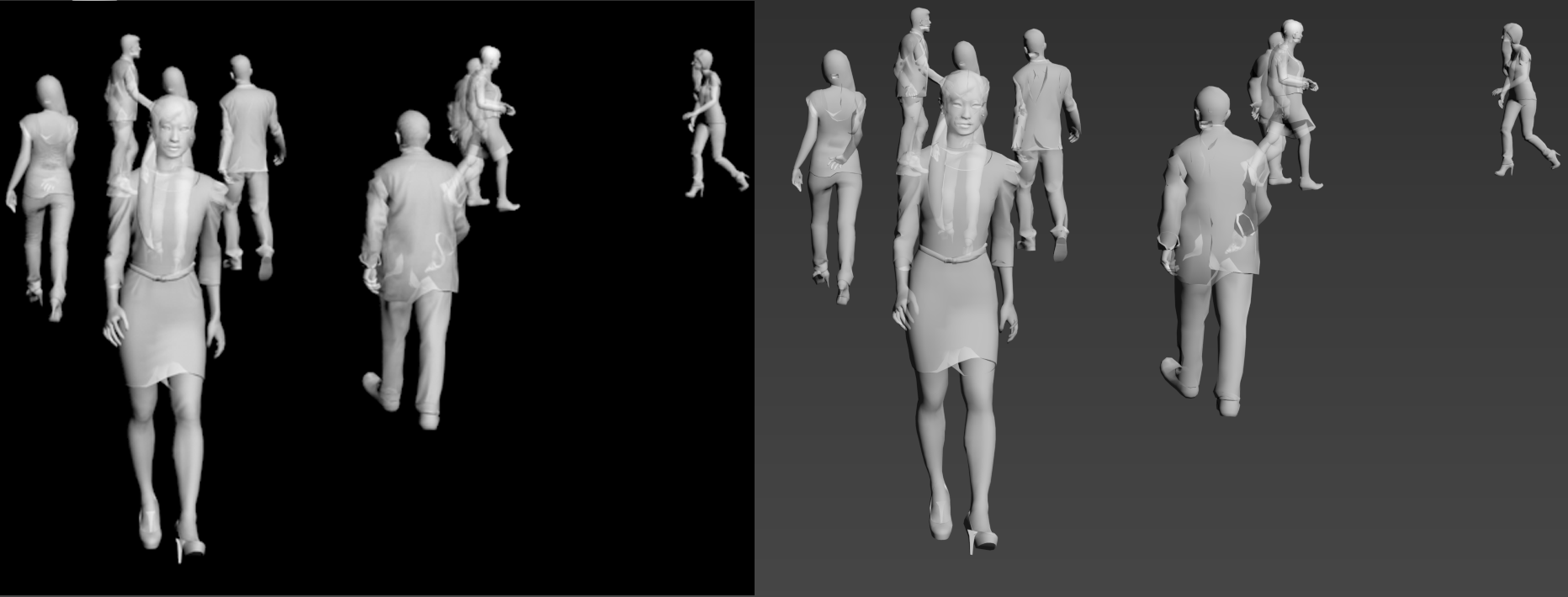

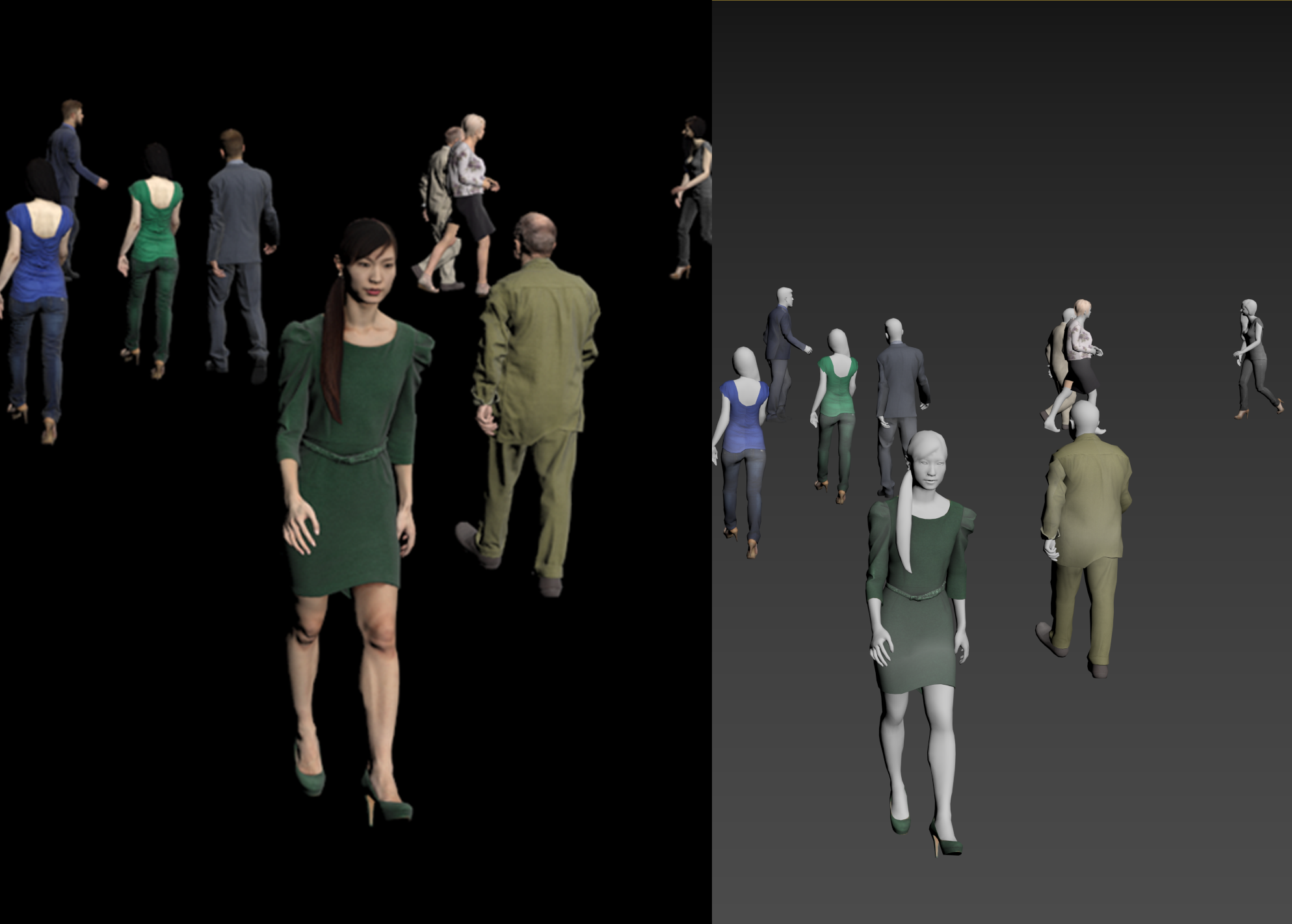

Material Types
After importing your Anima scene inside Cinema 4D, a pop-up window will display asking you if you want to assign materials to your actors.
  1. You will be asked to choose between 3 material presets, and the Regular material (color) option will be selected by default.
2. The Regular material (color) includes hyper-realistic textures, including normal, specular and opacity maps, ready for rendering.
3. Alternatively, you can select Plaster (white Lambertian) material to get a more neutral and abstract result.
4. Or choose the Semi-transparent option for an even more subtle presence of the actors in the renders.
