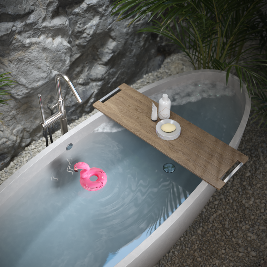

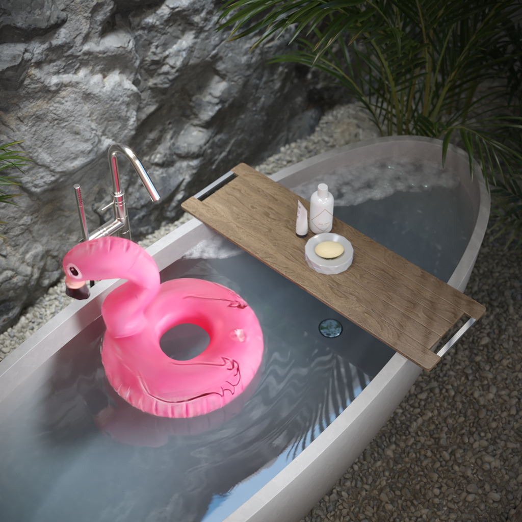

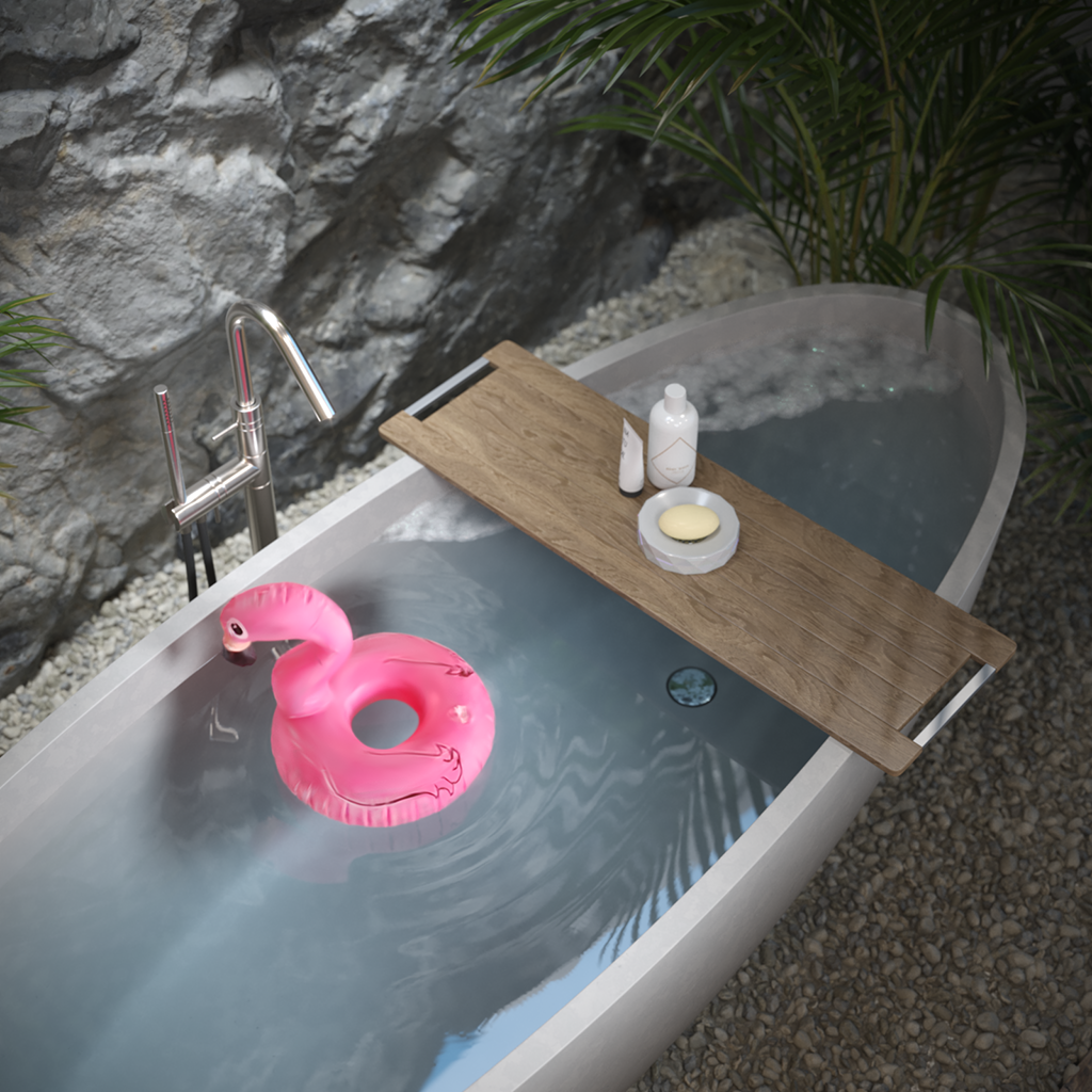

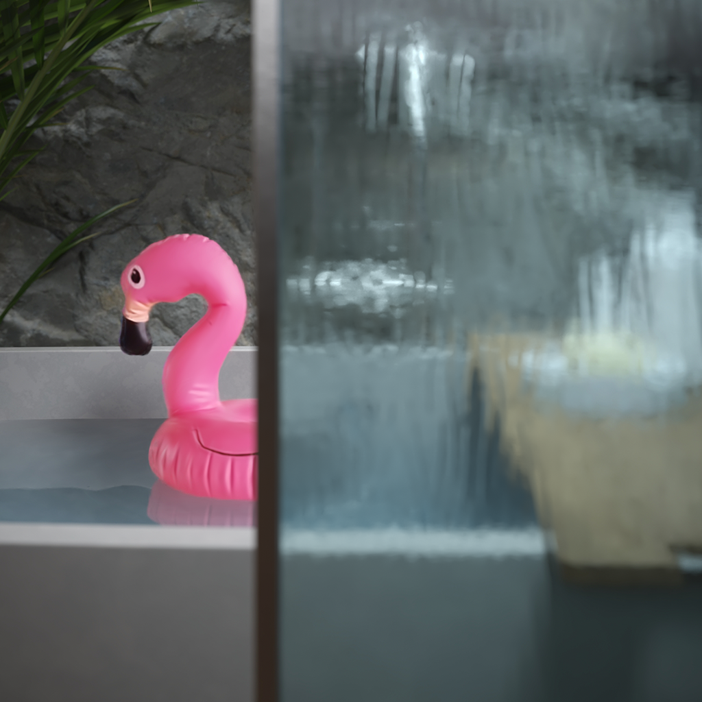

Example: scale
This example shows Gaussian Splat used as an individual object - the pink flamingo floatable in this scene. It can be scaled as any other object in the scene, using the scale parameter.
scale = 0.5
scale = 1
scale = 1.5

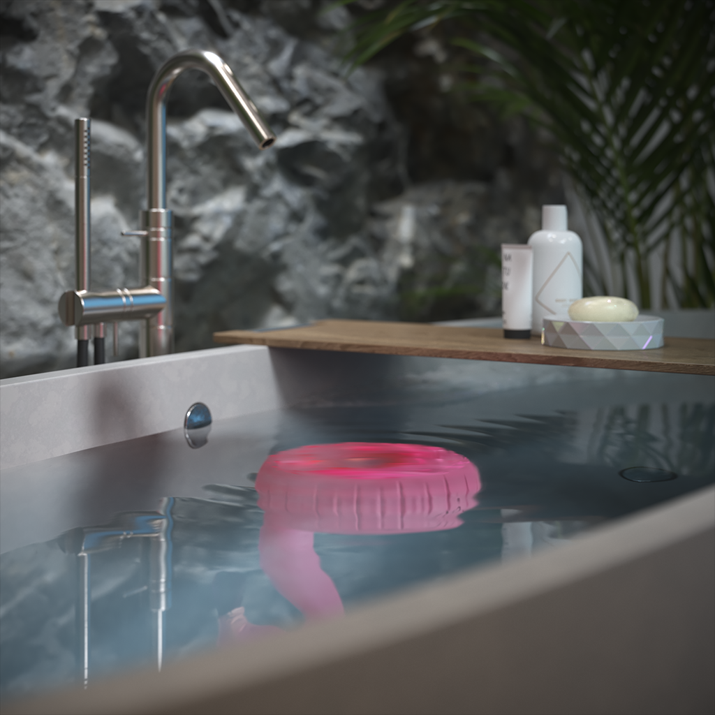

Example: affect_camera
The Gaussian Splat object can be hidden from the camera, like any other geometry object in the scene, by using the affect_camera option.
affect_camera is off
affect_camera is on

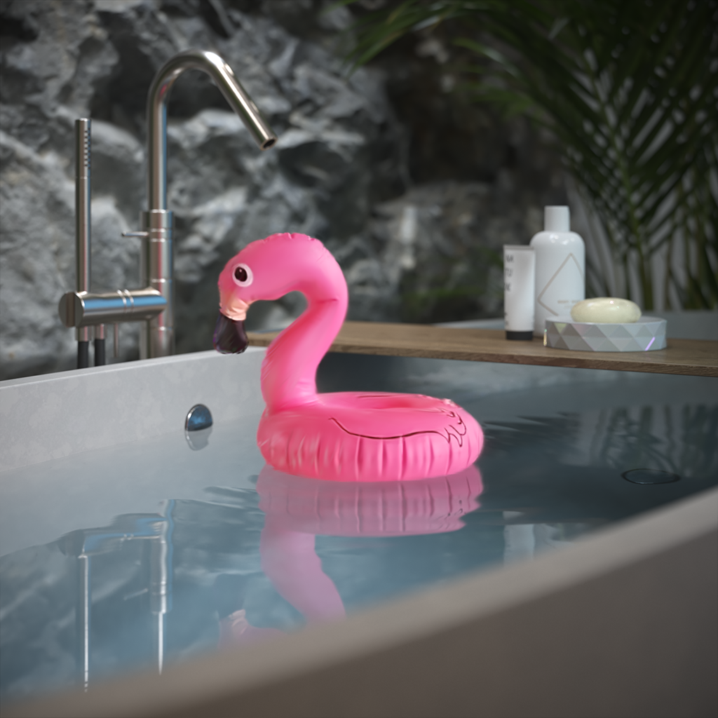

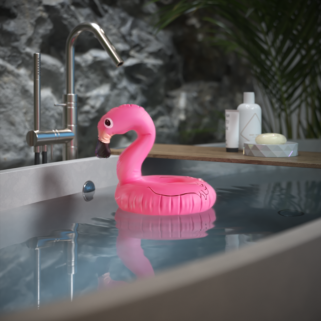

Example: affect_reflections
The affect_reflections option controls if the Gaussian Splat object is reflected in other objects in the scene.
affect_reflections is off
affect_reflections is on

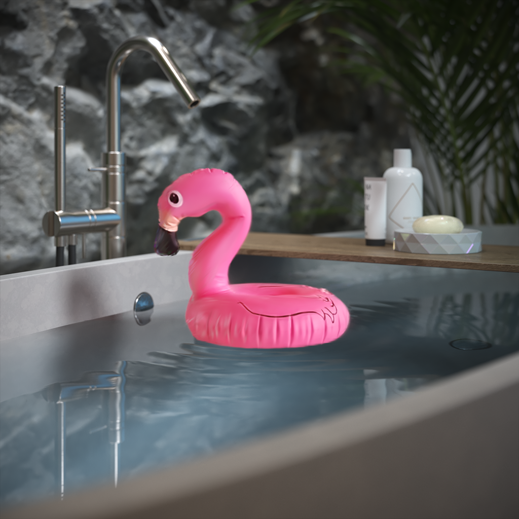

The affect_refractions option makes the Gaussian Splat object seen by other objects in the scene that exhibit refractive properties.
 affect_refractions is off
 affect_refractions is on

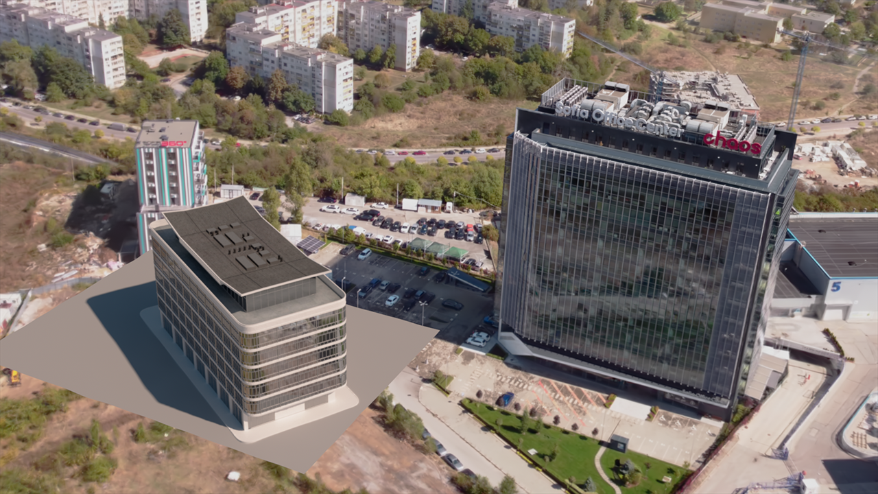

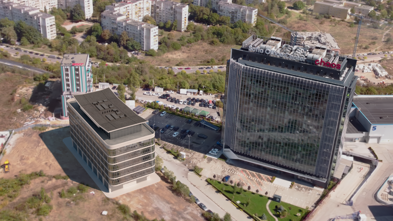

Example: affect_matte_surfaces
In this example, the Gaussian Splat is used as an environment. The left building in the rendering that casts shadows over the plane, is a Cosmos asset (mesh).
When the affect_matte_surfaces option is enabled, the Gaussian Splat is considered as background and receives shadows from the casting object.
 affect_matte_surfaces is off
 affect_matte_surfaces is on

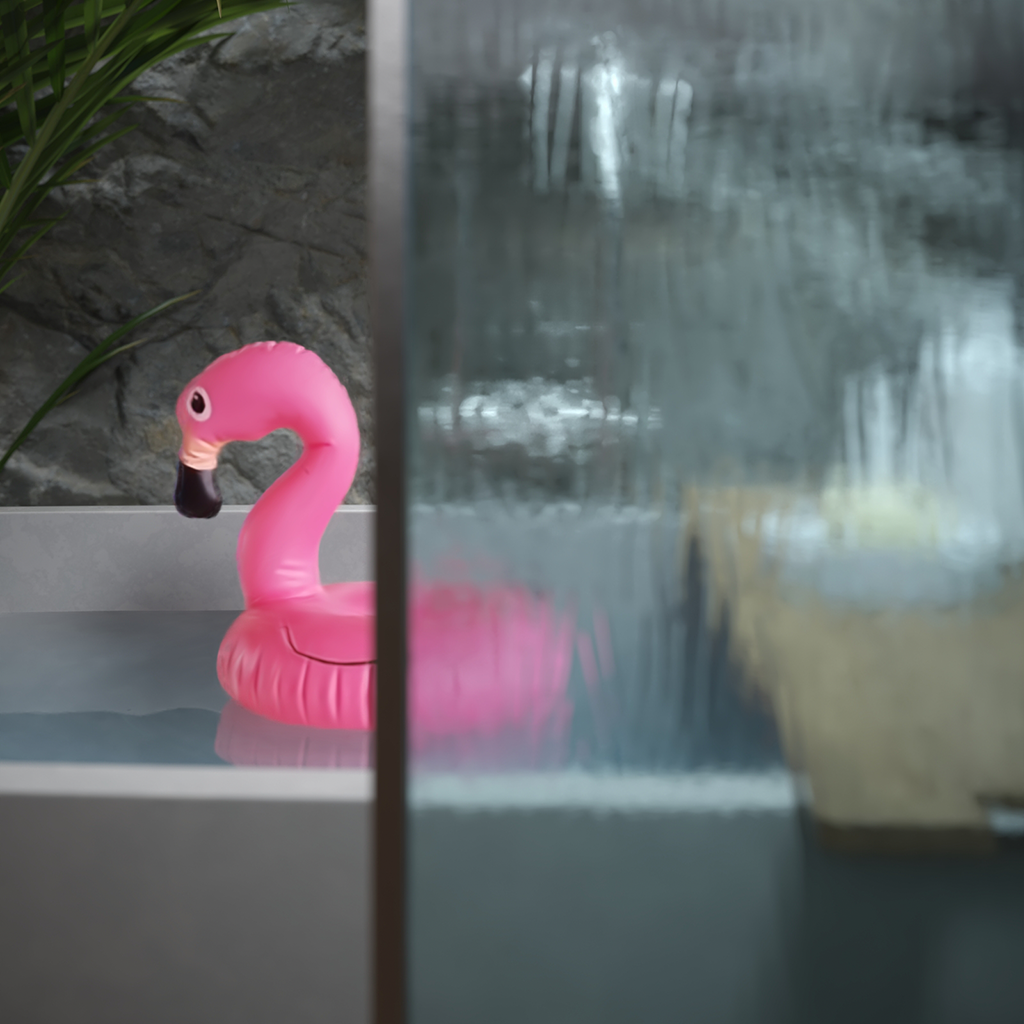

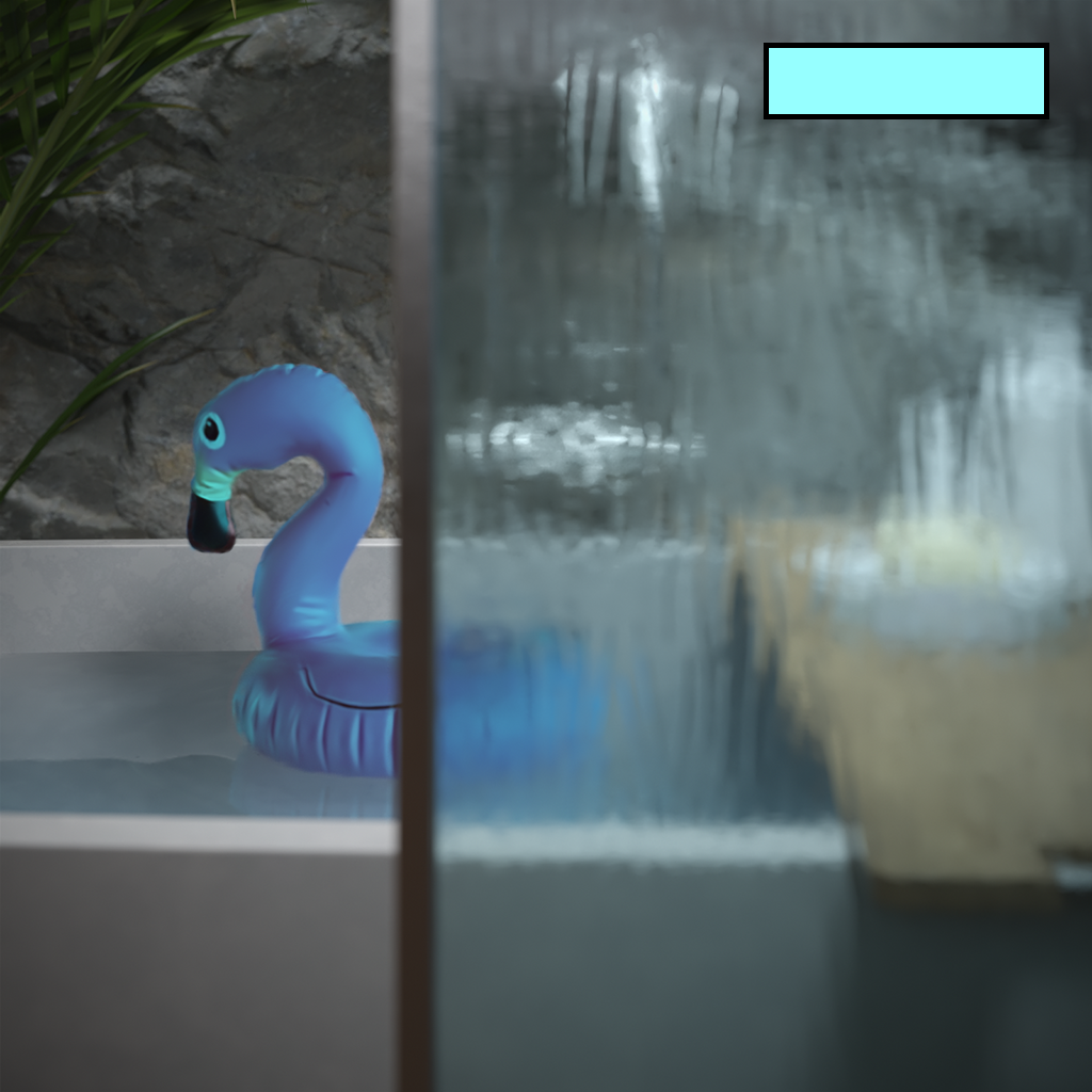

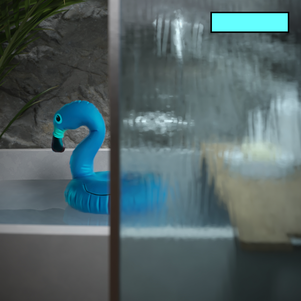

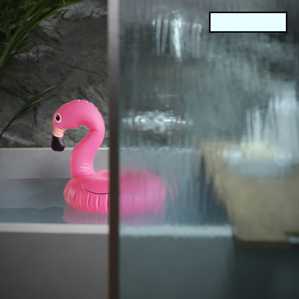

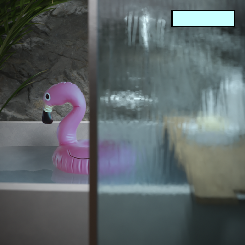

Example: color
The color shown on each render as a box is used as a filter for the original Gaussian Splat diffuse color.
