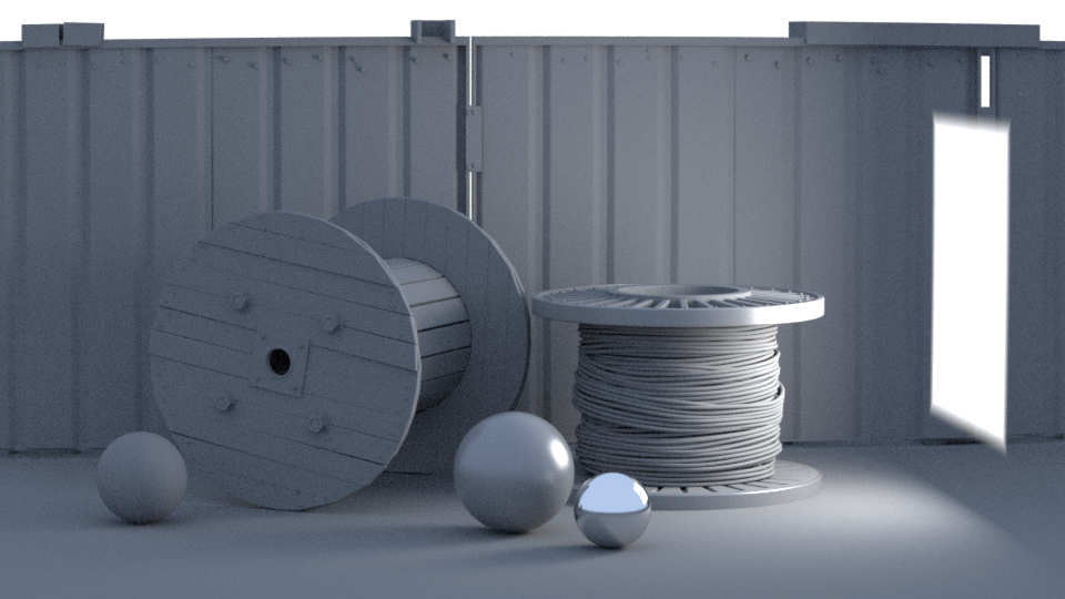

Rectangle light
Here's a picture of a textured rectangle light:
It can be rounded to a disc shape and also textured. The idea behind texturing a light is to simulate the imperfections of a real world light, instead of having solid color light among the whole light surface. Even studio softboxes are not perfect and their light contains darker spots in certain places. One can find textures of different softboxes online.
The texture files are re-sampled at a resolution controlled by a tex_resolution parameter which has a default value of 512 for dome and rectangle and 256 for mesh lights. So if the light texture looks too pixelated, especially on the dome environment, try increasing this resolution. This will of course increase memory usage and render time slightly.

The scene used for this render is called "Lighting_Rect.vrscene" and can be found in the scene bundle (comments to the different parameters available inside).
The scene used for this render is called "Lighting_Rect_tex.vrscene" and can be found in the scene bundle (comments to the different parameters available inside).
The scene used for this render is called "Lighting_Rect_tex_alpha.vrscene" and can be found in the scene bundle  (comments to the different parameters available inside).
