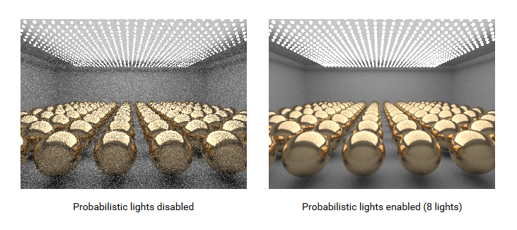

Example: Probabilistic Lights
It is highly recommended to use adaptive lights instead of probabilistic lights.
This is a scene with over 1000 spherical Area lights with the Cutoff threshold set to 0.0 (no cutoff). Both images were rendered with the Progressive image sampler for the same amount of time. When the Probabilistic lights option is disabled, the rendering is very noisy. When the Probabilistic lights option is enabled and set to 8 lights, the image is much cleaner as V-Ray is able to compute more GI rays, which are the main source of noise in this scene.

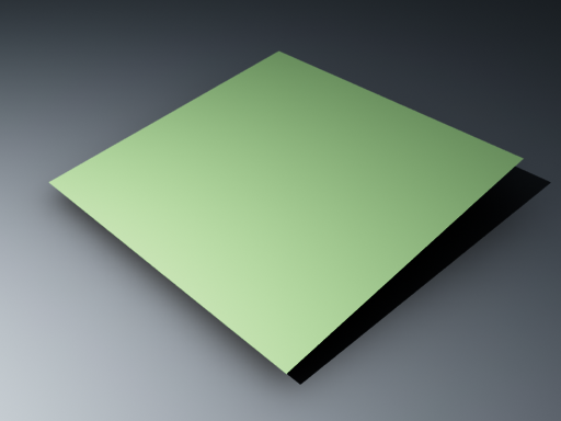

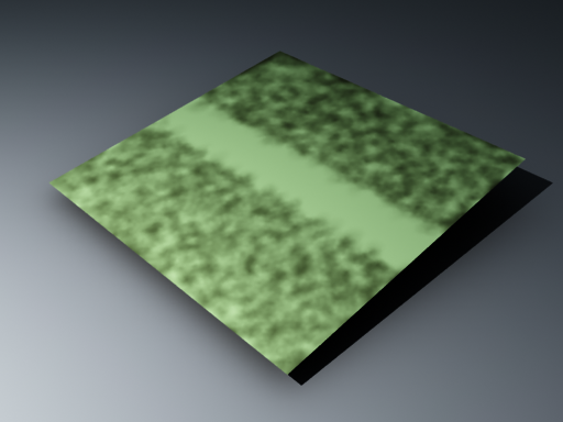

Example: Secondary Rays Bias
This example shows the effect of the Secondary rays bias parameter. The scene below has a box object with a height of 0.0, which the top and bottom of the box occupy exactly the same region in space. Due to this, V-Ray cannot resolve unambiguously intersections of rays with these surfaces.
The first image shows what happens when you try to render the scene with the default settings. You can see the splotches in the GI solution, caused by the fact that rays randomly intersect one or the other surface:
In the second image below, the Secondary rays bias is set to 0.001, which offsets the start of each ray a little bit along its direction. In effect, this makes V-Ray skip the problematic surface overlaps and render the scene correctly:
Note that the Secondary rays bias affects only things like GI, reflections, etc. In order to render the scene properly, the material assigned to the box has its 2-sided option checked. This is so that the object looks in the same way regardless of whether the camera rays hit the top or the bottom of the box. If the material did not have this option checked, it would appear "noisy" even though the Secondary rays bias is greater than 0.0:
