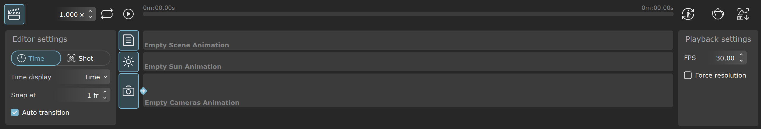

UI
The Animation Editor can be accessed by clicking on the Animation Editor button(Vantage_Bottom_Bar_Editor.png) in the bottom toolbar:
Compressed
Expanded
ButtonDescription
Expands the Animation Editor.
Sets the playback speed.
When enabled, loops the animation.
Plays the animation. (Shortcut: Space)
Sets start of animation sequence.
Sets end of animation sequence.
When enabled, automatically updates image sequences and animated meshes for the current frame of the timeline or when scrubbing the timeline. Does not update when playing the animation from the Play button. Not available in Live Link. (Shortcut: U)
Saves a high quality snapshot of the current view in the project folder from where the scene file has been imported.
You can crop your animation sequence using the Set Start and Set End markers.
Animation Editor Parameters

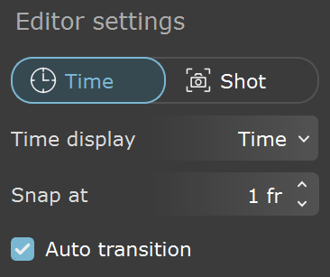

Left Side Parameters
Time – Sets the animation editor in Time mode. For more details see below.
Shot – Sets the animation editor in Shot mode. For more details see below.
Time display – Sets the time display for the animation.
Time – Sets the timeline to minutes, seconds [0m:00.00s].
Frames – Sets the timeline to frames [0fr].
Combined – Sets the timeline to minutes, seconds and frames[0m:00s;0fr].
Snap at – Specifies the number of frames the camera clip automatically snaps to when moved or extended/shortened.
Auto transition – When enabled, automatically creates transition between the last and previously added camera. The default duration for the transition is set in Edit > Preferences > Interaction > Cam transition time.

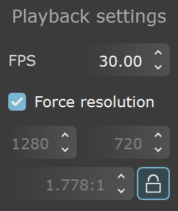

Right Side Parameters
FPS – Specifies the frames per second for the animation. Animation length in [0m:00.00s] is preserved, only frames count is changed.
Force resolution – When enabled, sets the resolution for the animation and overrides added cameras' aspect ratios and resolutions.
Width – Sets the width of the animation sequence in pixels.
Height – Sets the height of the animation sequence in pixels.
Aspect – Sets the aspect of the render resolution.
Lock aspect – Locks the proportional relationship between the Width and Height, so when changing one of them, the other adjusts itself keeping the Aspect unchanged.

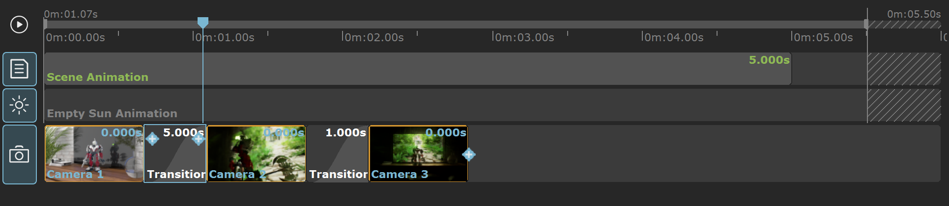

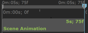

Timeline
ButtonDescription
Displays the length of the animation. On the left side is displayed the current time/length of the animation. On the right side is displayed the entire length of the animation. Length and current take into account the trim markers' position.
Trims the animation length. On each marker is displayed how much of the animation is trimmed.
Enables/disables the Scene Animation track.
Enables/disables the Sun Animation track.

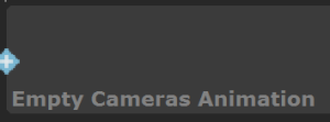

Enables/disables the Cameras Animation track.
A track where imported animation from .vrscene is placed. It is automatically populated when a .vrscene animation is present.
A track where you can place your saved cameras from the Camera tab.
Helps navigating through the animation when zoomed in.

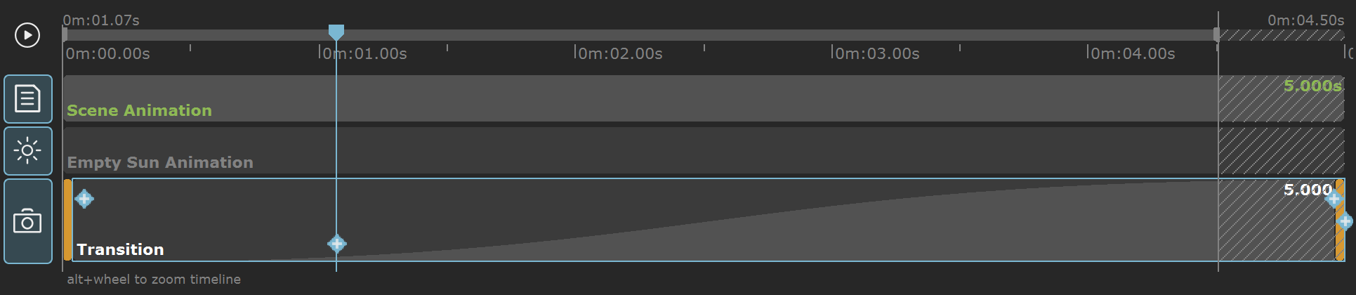

Time Mode
Time mode of the animation editor enables the following workflow:
  • Drag-n-drop cameras in the camera track.
  • Add a transition element between added cameras. When Auto transition is enabled, a transition element is automatically added between the last and previously added camera. The default duration for the transition is set in Edit > Preferences > Interaction > Cam transition time. The transition element has 4 interpolation types: Linear, In/Out Quad, In Quad, Out Quad.
  • Add a pause element to lengthen the duration of a static camera or to make the last frame of a recorded camera.
  • Element's length is visible both visually on the timeline and the exact duration is marked in the upper right corner. Duration can be set with right-click > Set Duration. Time units are dependent on Time Display option.
  • Elements can be added with the (+) button at the start or end of a selected element, or from a context menu with a right-click.
  • While on a transition element, a new camera with the current view in the viewport can be created with the (+) button on the playhead. The new camera is added in the camera list and the transition is split into two which summed duration equal the original.
  • Playhead and trim markers go over the scene and camera tracks. Trim markers hatch the part of an element that will not be rendered in the final sequence.
  • Elements have the following visuals:
    • Single Camera is represented as a frame with orange fill and a 1frame length.
    • Recorded camera has length, shaded with a red label, and camera thumbnail preview if the width allows it.
    • Transition element has length, shaded with two tones of grey fill that represents the set type of interpolation.
    • Pause element has length, shed with a grey fill.

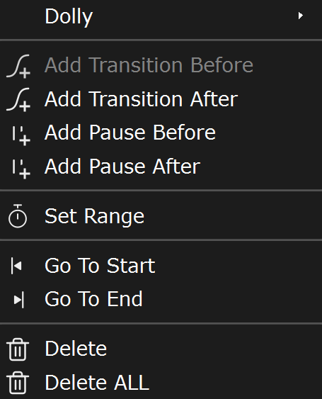

Right-click on camera clip
Add Transition BeforeAdds a transition item before the selected camera clip.
Add Transition AfterAdds a transition item after the selected camera clip.
Add Pause Before – Adds a pause item before the selected camera clip.
Add Pause AfterAdds a pause item after the selected camera clip.
Set Range – Sets a key frame range on the timeline for the cameras. The following options are available:
Start time – Sets the beginning time for the camera.
Start frame – Sets the beginning frame for the camera.
End time – Sets the end time for the camera.
End frame – Sets the end frame for the camera.
Framerate – Shows the frames per second for the camera. Cannot be edited.
Go To Start – Moves the slider to the start of the selected camera clip.
Go To EndMoves the slider to the end of the selected camera clip.
Delete – Deletes the selected camera clip.
Delete ALL – Deletes all elements in the track.

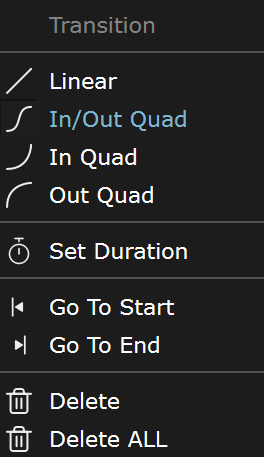

Right-click on transition item
Different interpolations between camera clips:
Linear – Creates a uniform transition between camera clips.
In/Out QuadCreates a smooth transition between camera clips. Creates a transition rate that is slow at the beginning and end, but fast in the middle.
In QuadCreates a transition rate that is slow at the beginning and accelerates in the end.
Out QuadCreates an accelerated transition rate at the beginning that gradually slows down.
Set Duration – Determines how long the transition item should be.
Go To Start – Moves the slider to the starting point of the transition item.
Go To End – Moves the slider at the end of the transition item.
Delete – Deletes the transition item.

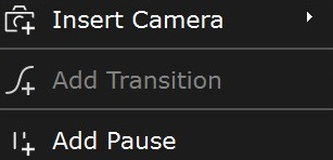

Right-click on blue transition/camera marker
Insert Camera – Adds a frame with a new camera shot, selected from a dropdown list with available camera shots.
Add Transition – Adds a transition item.
Add Pause – Adds a pause item.
