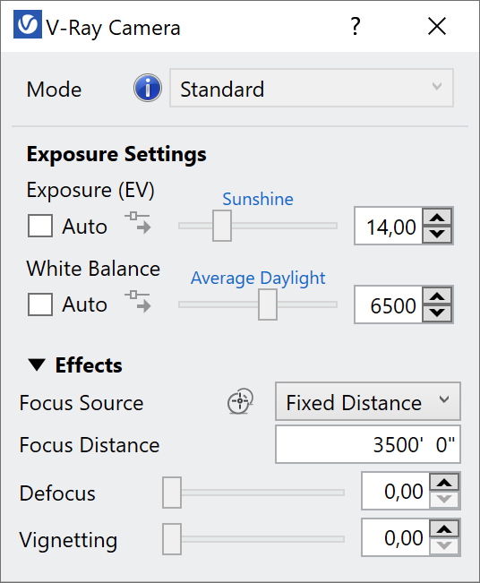

Camera
UINative nameV-Ray plugin nameSupport
V-Ray CameraCameraPhysical
Mode:
Standard
VR Spherical Panorama
VR Cubemap
SettingsCamera/type=0
SettingsCamera/type=9
SettingsCamera/type=10
(tick)
(error)
(error)
Stereo:
Side-by-side
Top-bottom
 RenderView/stereo_on
(error)
(error)
(error)
Exposure (EV)combination of ISO, f_number, shutter_speed(tick)
Exposure (EV) AutoSettingsCamera/auto_exposure
(error)
White Balancewhite_balance(tick)
White Balance AutoSettingsCamera/auto_white_balance
(error)
Focus Source:
Fixed Distance
Fixed Point
(minus)
(minus)
Focus Distancefocus_distance(tick)
Defocuscombination of ISO, f_number(tick)
Vignettingvignetting(error)

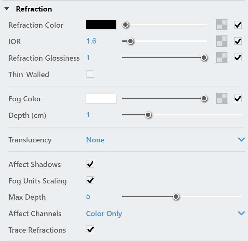

Refraction Colorrefract(tick)
Refraction Color Texturerefract(tick)
IORrefract_ior(tick)
IOR Texturerefract_ior(tick)
Refraction Glossinessrefract_glossiness(tick)
Refraction Glossiness Texturerefract_glossiness(tick)
Thin-Walledrefract_thin_walled(tick)

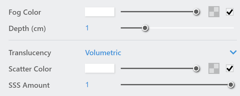

Fog Colorfog_color
(tick)
Fog Color Texturefog_color(error)
Depth ()cm / Scale (cm)fog_mult
(tick)

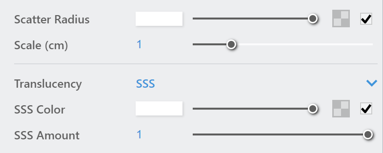

Translucency:
None
Volumetric
SSS
translucency=0
translucency=5
translucency=6
(error)
(error)
(error)
Scatter Color / SSS Colortranslucency_color
(error)
Scatter Color Texture / SSS Color Texturetranslucency_color
(error)
SSS Amounttranslucency_amount
(error)
SSS Amount Texturetranslucency_amount
(error)
Affect Shadowsrefract_affect_shadows(tick)
Fog Units Scalingfog_unit_scale_on(error)
Max depthrefract_depth(error)
Affect Channels:
Color only
Color+alpha
All Channels
refract_affect_alpha=0
refract_affect_alpha=1
refract_affect_alpha=2
(error)
(error)
(error)
Trace Refractionsrefract_trace
(error)

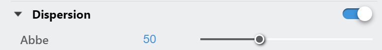

Dispersiondispersion_on(error)
Abbedispersion(error)

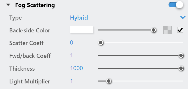

Fog Scatteringtranslucency(error)
Type:
Hard (wax) model
Hybrid
Back-side Color
Scatter Coeff
Thickness
Light Multiplier
translucency=1
translucency=3
translucency_color
translucency_scatter_coeff
translucency_thickness
translucency_light_mult
(error)
(error)
(error)
(error)
(error)
(error)
Back-side Colortranslucency_color(error)
Back-side Color Texturetranslucency_color(error)
Scatter Coefftranslucency_scatter_coeff(error)
Fwd/back Coefftranslucency_scatter_dir(error)
Thicknesstranslucency_thickness(error)
Light Multipliertranslucency_light_mult(error)

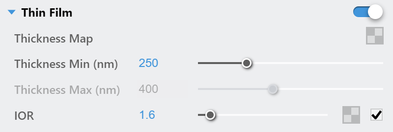

Thin Film
Thickness Map
Thickness Min (nm)
Thickness Max (nm)
IOR

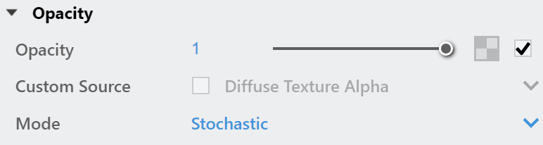

Opacityopacity
(error)
Opacity Textureopacity
(tick) 1
Custom Source:
DIffuse Texture Alpha
Opacity Texture Alpha
opacity/TexCombineFloat
opacity/TexAColorChannel/mode=3
(tick)
(error)
Mode:
Normal
Clip
Stochastic
opacity_mode=0
opacity_mode=1
opacity_mode=2
(error)
(tick)
(error)

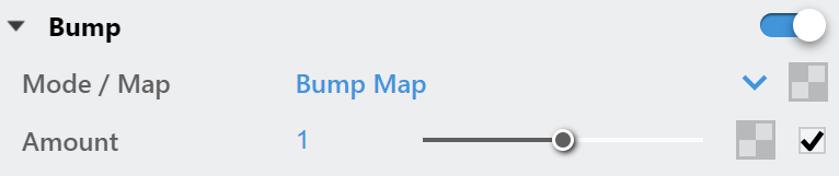

Bump Mode:
Bump Map
Normal Map
bump_type=0
bump_type=1
(tick)
(tick)
Bump Map Texturebump_map
(tick)
Bump Amountbump_amount
(tick)
Bump Amount Texturebump_amount
(error)

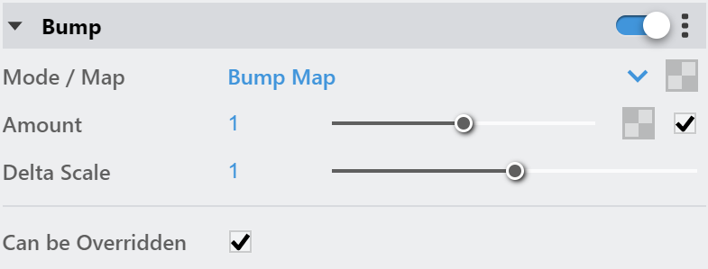

 BumpBRDFBump
Basebase_brdf(tick)
Map:
Bump Map
Bump Texture Channel
Normal Map
bump_tex_color
map_type=0
map_type=5
map_type=1
(tick)
(tick)
(tick)
(error)
Normal Map Type:
Tangent Space
Object Space
Screen Space
World Space
map_type=1
map_type=2
map_type=3
map_type=4
(error)
(error)
(error)
(error)
Amountbump_tex_mult_tex(error)
Delta Scalebump_delta_scale(error)
