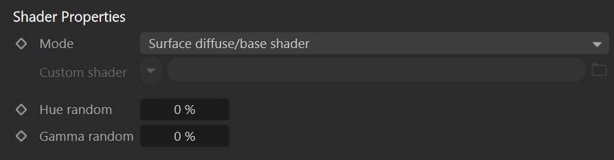

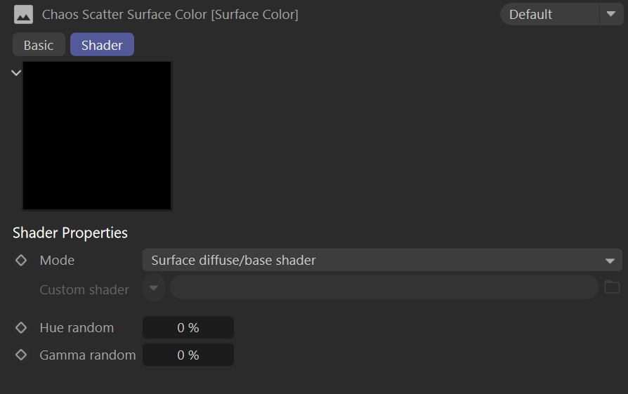

Shader properties
Mode – Allows setting the mode for the Surface Color shader
  • Custom shader – Uses a custom shader as the surface color. You can then randomize this map's hue and gamma using the built-in controls.
  • Surface diffuse/base shader – Automatically uses the distribute-on object's diffuse/base shader.
Hue random – Controls randomization of the resulting color hue. The value specifies the maximal distance from the original hue (in the range of 0-100%), where 0% disables hue randomization and 100% applies maximal hue randomization.
Gamma random – Adds additional randomization of mid-tones (gamma) to the result (in a range of 0-100%), where 0% disables randomization and 100% applies maximal reasonable gamma randomization.
The Chaos Scatter Surface Color shader is located under the plugins > ChaosScatter category when loading a shader using Cinema 4D's built-in material editor. If you're using the Corona Node Material Editor, the shader is located under the New Shader > ChaosScatter category.

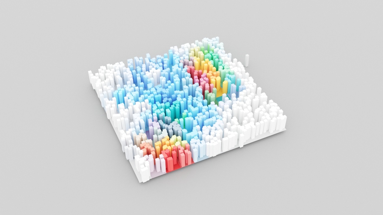

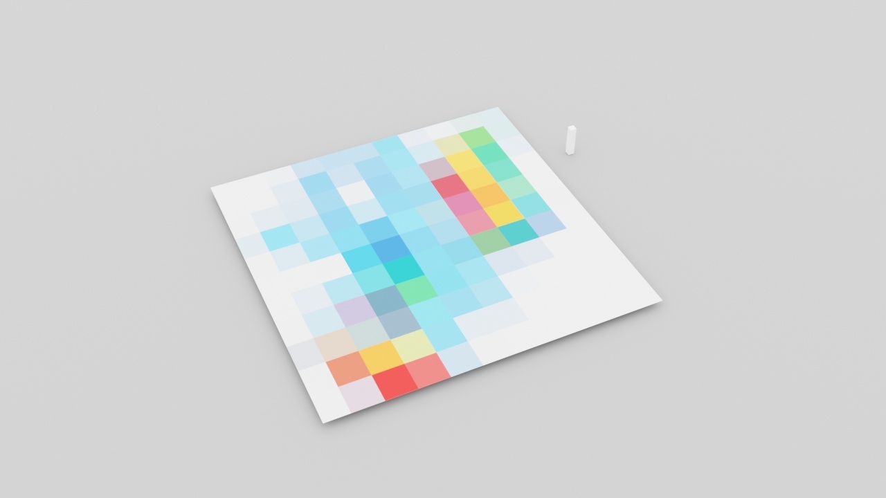

The Chaos Scatter Surface Color texture map is applied to the scattered objects on the distribution surface.
Scattered objects - NO
Scattered objects - YES
