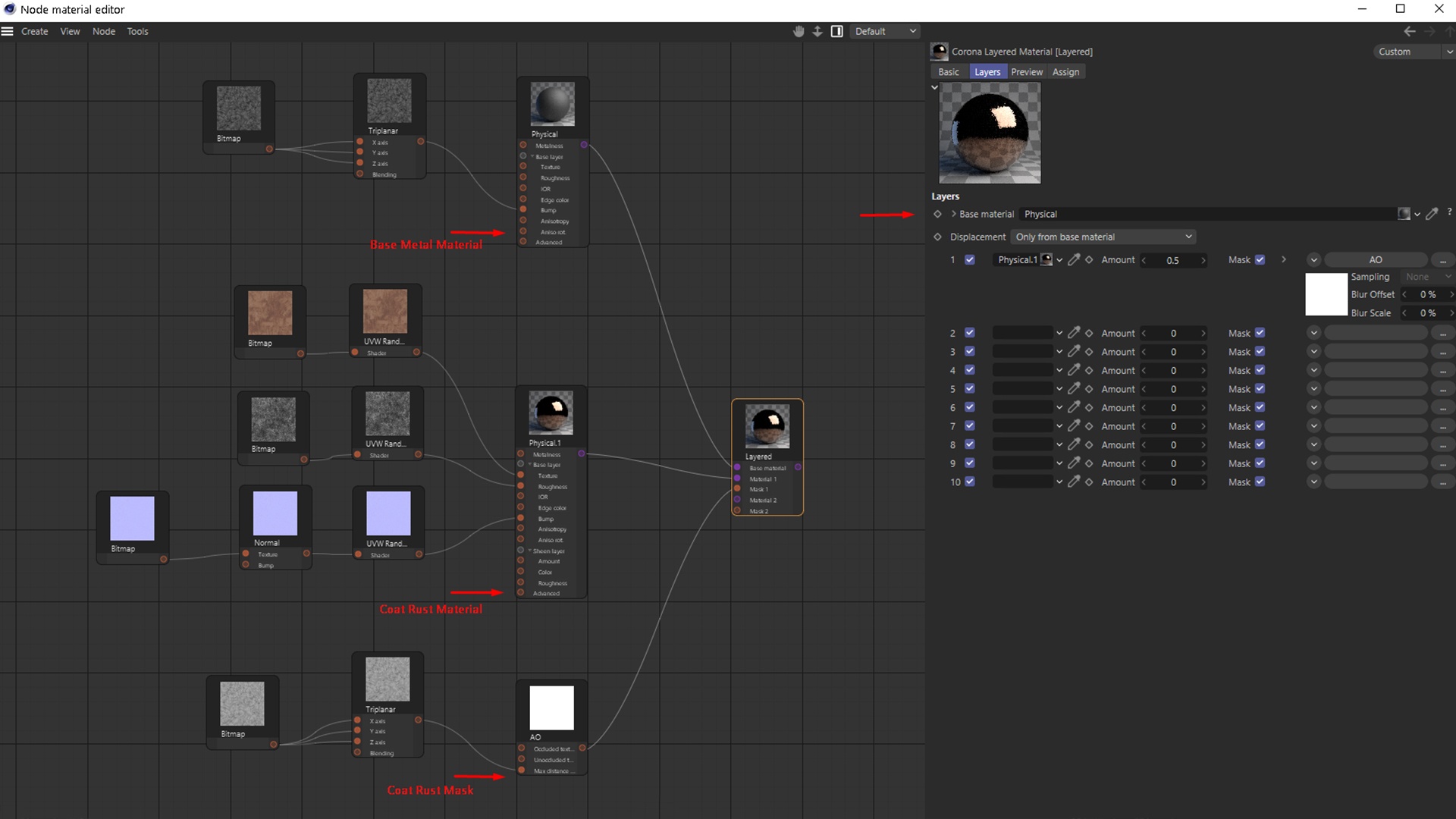

The Corona Layered Material offers stacking of multiple materials on top of each other in order to mix them. The resulting material depends on the blending amount or the masking shader used for each material layer. You can use a shader or a texture map to mask out the material layers in order to control what parts appear in the render - for example: rusted spots on a metal surface, exposed bricks below a cracked concrete surface, or a glossy pattern on a matte painted surface.

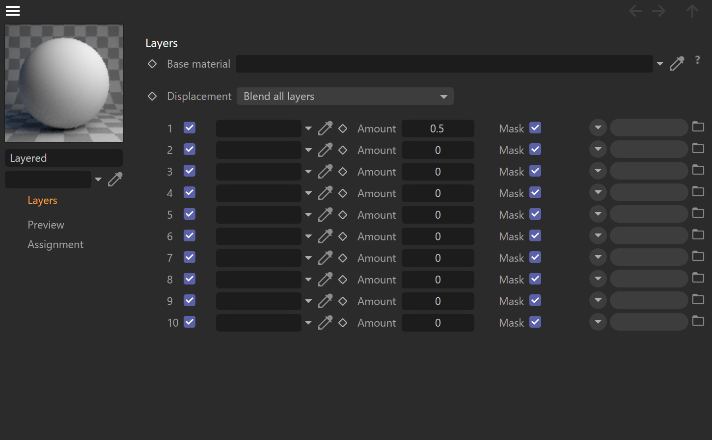

Layers
Base material – This slot defines the base material of the surface. Other layers are stacked on top of it.
A base material is required for the Layered Material to work properly. If the base material slot is empty, the base material is rendered as a simple material with the wire (object) color set as its diffuse color.

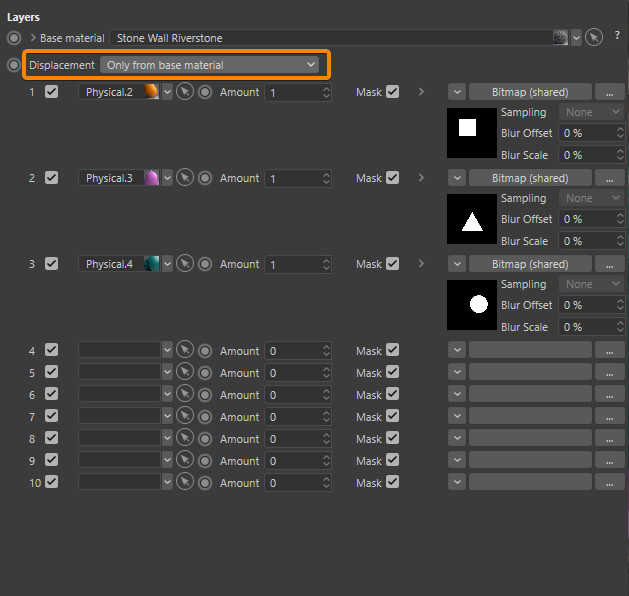

Displacement – This parameter specifies what displacement blending mode to use for the layered displacement. The base displacement is always used.
Only from base material – This mode only uses the base material's displacement.
Blend all layers – This mode blends displacement from all layers including the base material.

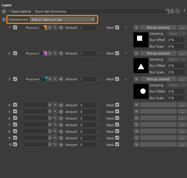

Add all layers on top – This mode adds each layer's displacement on top of each other.
Layers – These are the layers that are stacked on top of the base material. Each layer can be enabled or disabled.
Amount – This is the intensity (also considered as the visibility) of the layer.
Mask – This parameter allows the load of a texture map or shader to be used as a mask for the layer.

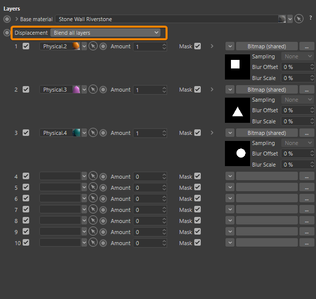

Displacement – Blending modes

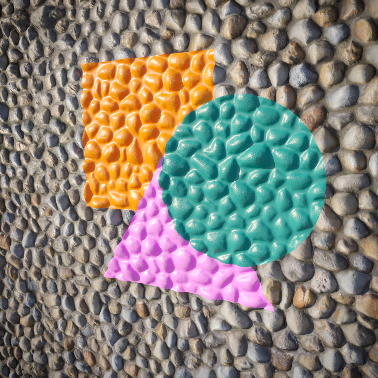

Displacement mode: Only from base material
In this mode, the displacement only from the base material is applied to the object.
Displacement mode: Blend all layers
This is the default mode for displacement. This is like stacking displacement maps from the base material and layered materials like layers on top of each other without any special blending mode; then they can be mixed by changing their opacity.

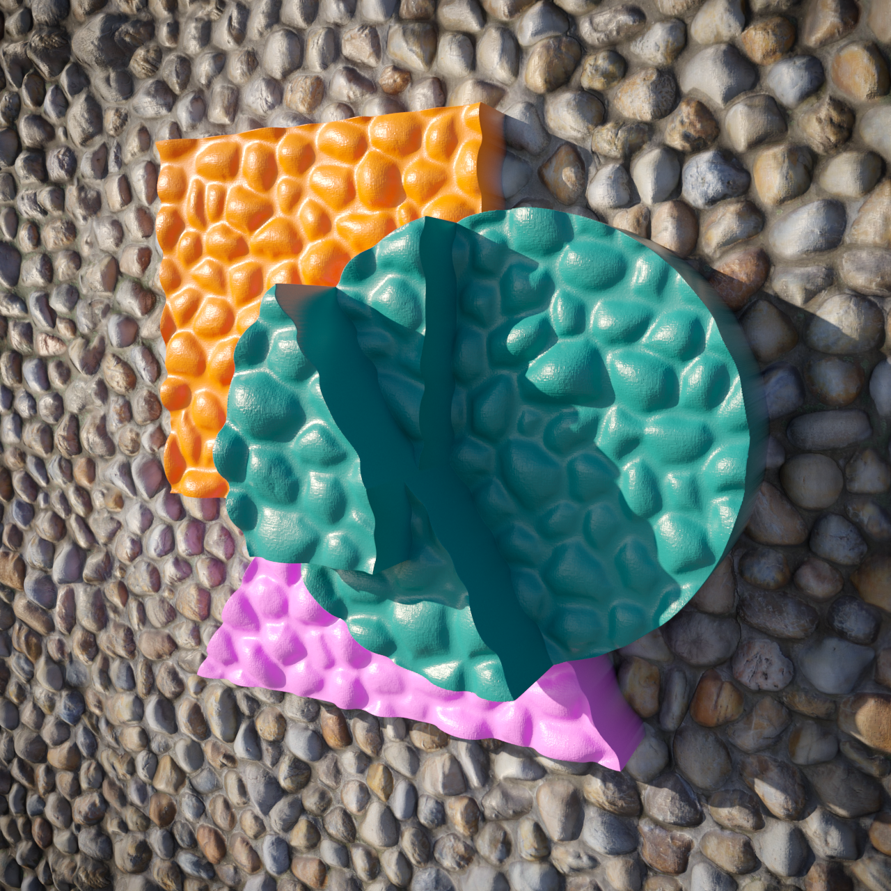

Displacement mode: Add all layers on top
This is like stacking displacement maps like layers on top of each other and using the Add blending mode to mix them (then their strengths can be affected by the Amount value).

Corona Layered Material: Example A

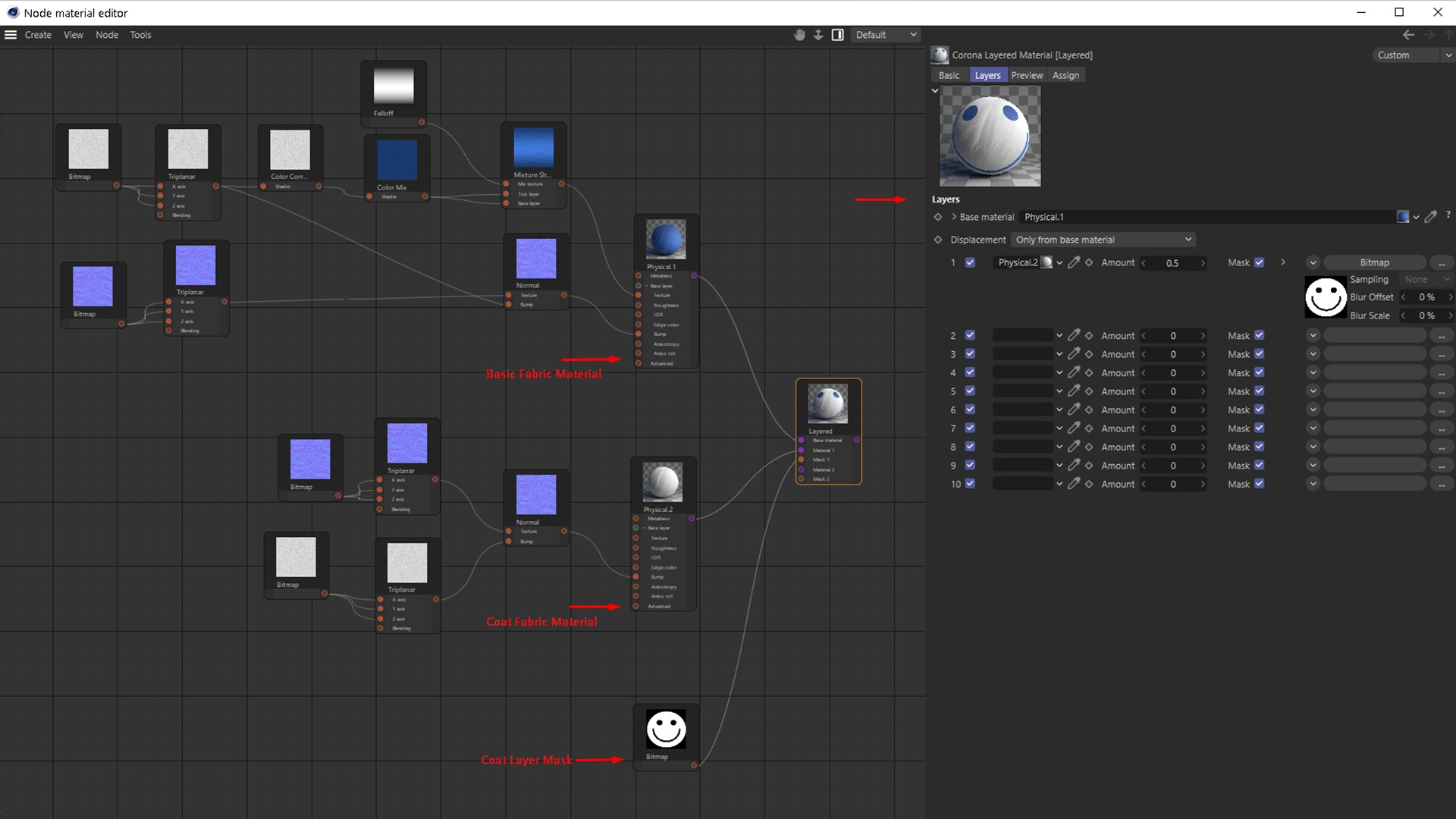

Corona Layered Material: Example B
