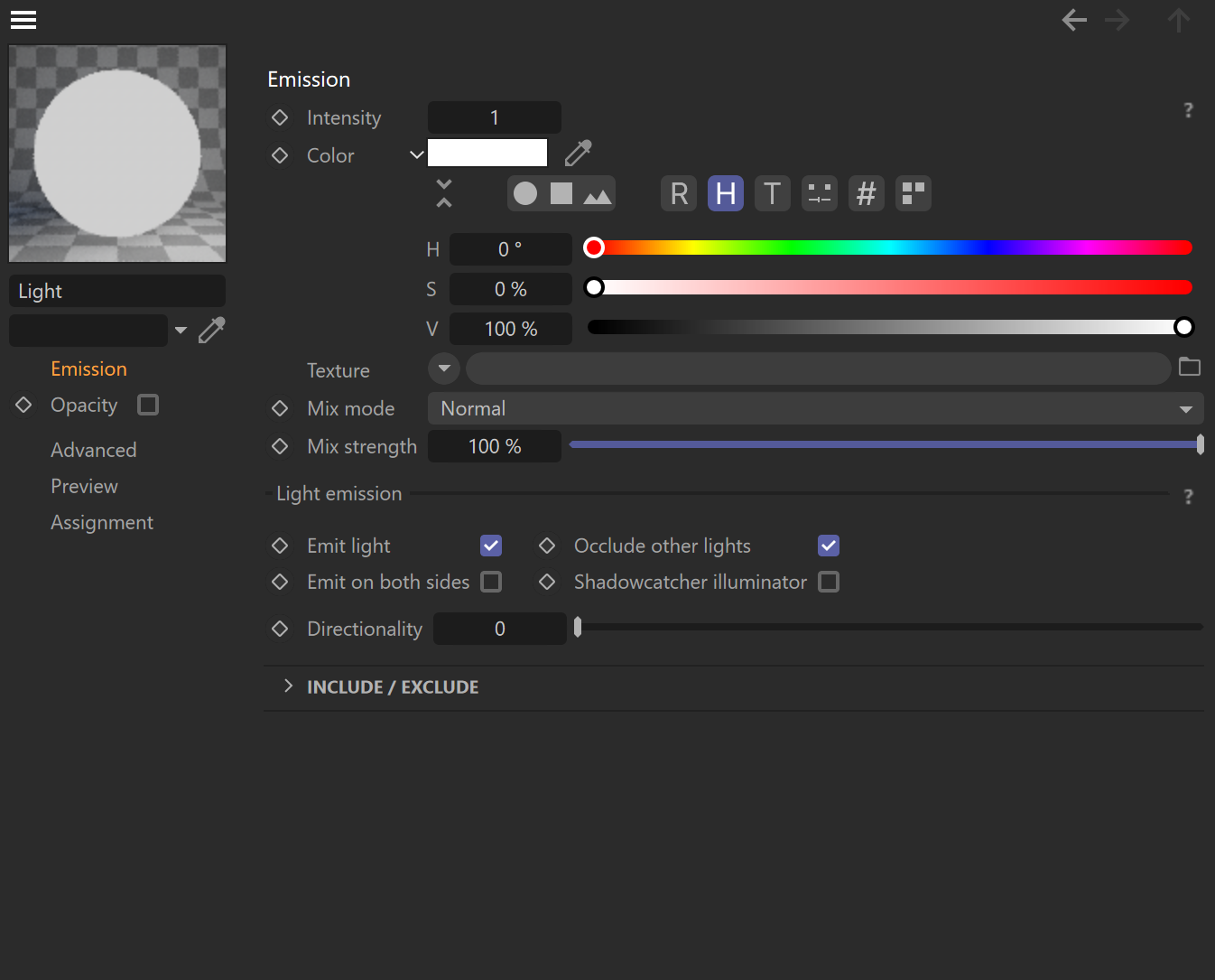

Emission
Intensity – This option controls the intensity of the light. The intensity is the result of multiplying the color or the texture map and the intensity value.
Color – This is the color that is used for light emission.
Texture – This slot defines the texture map or shader that is used instead of the above color.
Mix mode – This parameter controls the blending mode of the texture map or shader over the color.
Mix strength – This value controls the intensity of the texture map or shader that is used.
If the Mix strength is set to 100%, the texture map or shader completely overrides the color unless the Mix mode is set to a different blending mode than Normal.
Light emission
Emit light – When the Light Emission is enabled, then this light is a proper emitter, casting illumination into the scene. It can be disabled to create a camera back-plate that does not alter the scene lighting.
Emit on both sides – When checked, the material also emits light on the reverse side of the normals from the objects that are using this material. When disabled, it only emits light using the normal front side.
Occlude other lights – When enabled, the light blocks shadow rays from other lights in the scene. It is geometry that casts shadows when other lights shine at it.
Shadowcatcher illuminator – Used in combination with the Shadow Catcher Material. If enabled, this light illuminates the shadow catcher instead of casting shadows on it. Enable for CG lights that are added to the footage and are not present in the 2D backplate/footage.
Directionality – This parameter controls how concentrated the light emission is around the normal. Higher values create a spotlight effect.
Include/Exclude – This parameter lets you include or exclude objects from the influence of the Corona Light Material (the excluded objects do not receive light from this Light Material).

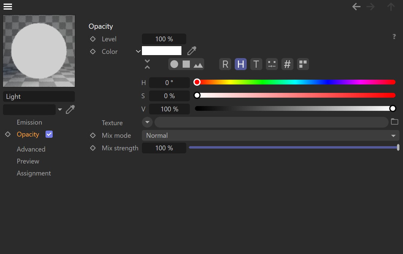

Opacity
Level – This is the intensity (also considered as the visibility) of the color.
Color – This is the color that is used for the opacity channel.
Texture – This slot defines the texture map or shader used instead of the above color.

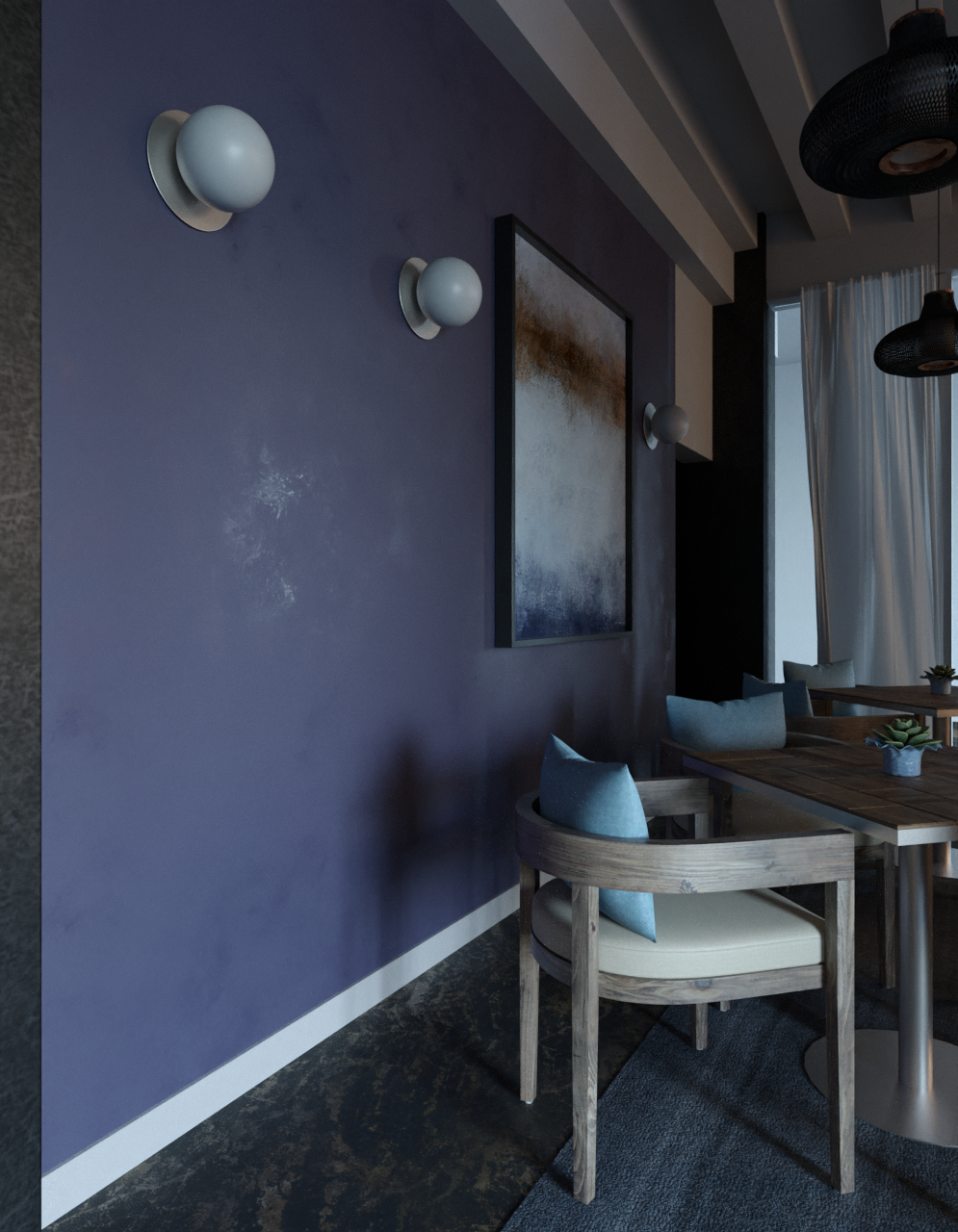

 In this example, the outdoor lighting comes from a Corona sky object placed in the scene. The lamps on the wall were imported from the Chaos Cosmos library and are only using a translucent lampshade material with no illumination.

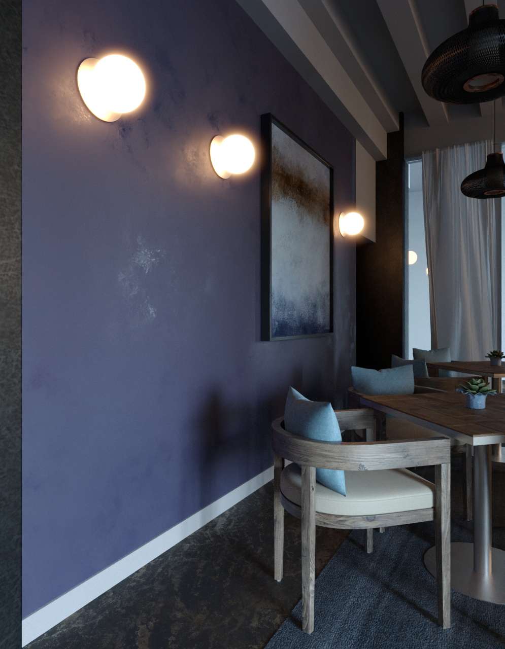

In this example, a Corona Light material is applied to the lamps on the wall, and the "Emit light" option is enabled (you can clearly see the light contribution on the wall, but also on the ceiling, chairs, and other objects). The resulting image has a little bit of noise.

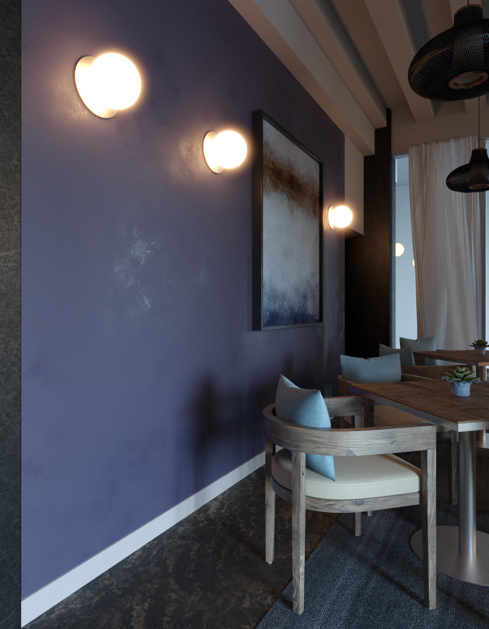

Finally, a Corona Physical material using the Self-Illumination channel is assigned to the wall lamps (there is subtle light contribution), and the resulting noise level is higher compared to the other examples.

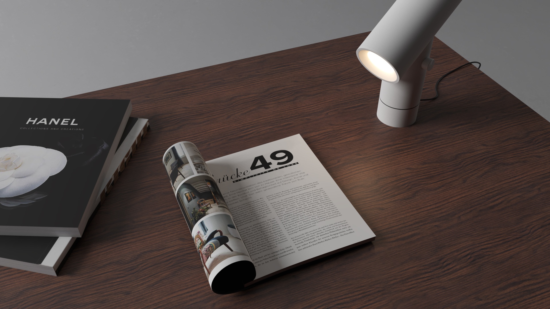

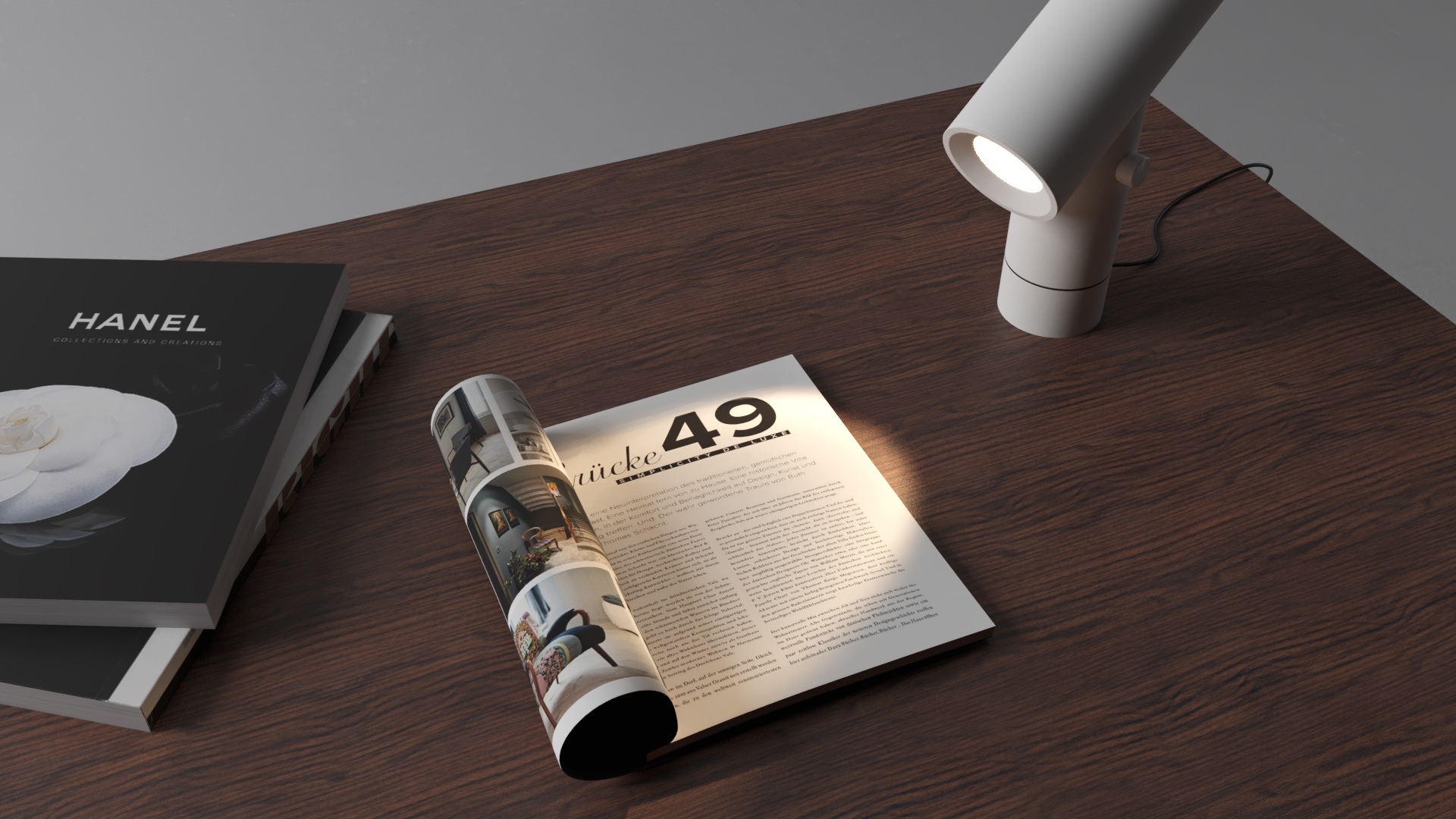

Corona Light Material: Directionality
Directionality = 0
Directionality = 0.5
Directionality = 0.8
Directionality = 1
