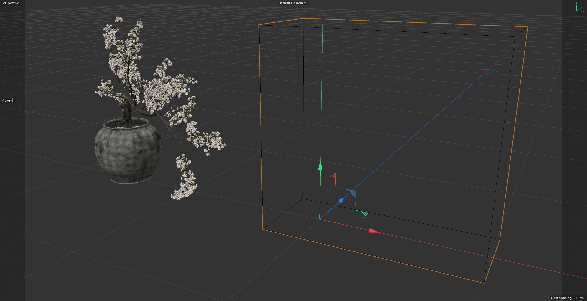

Solid bounding box – Using this option displays the proxy object as a solid box.

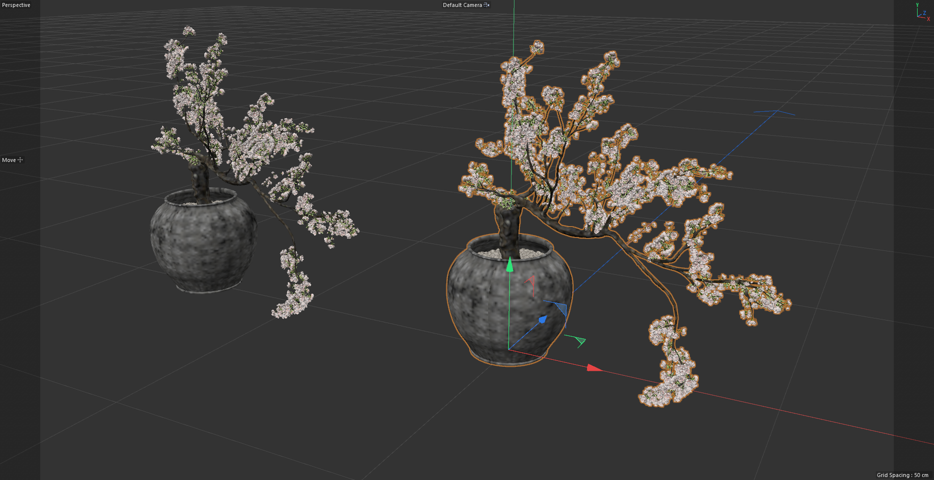

Full mesh – Using this option displays the entire geometry that the proxy object contains as if it wasn't a proxy object.
The Full Mesh option should not be used in cases involving complex geometry, as it does not bring any viewport performance improvement compared to displaying the original geometry.

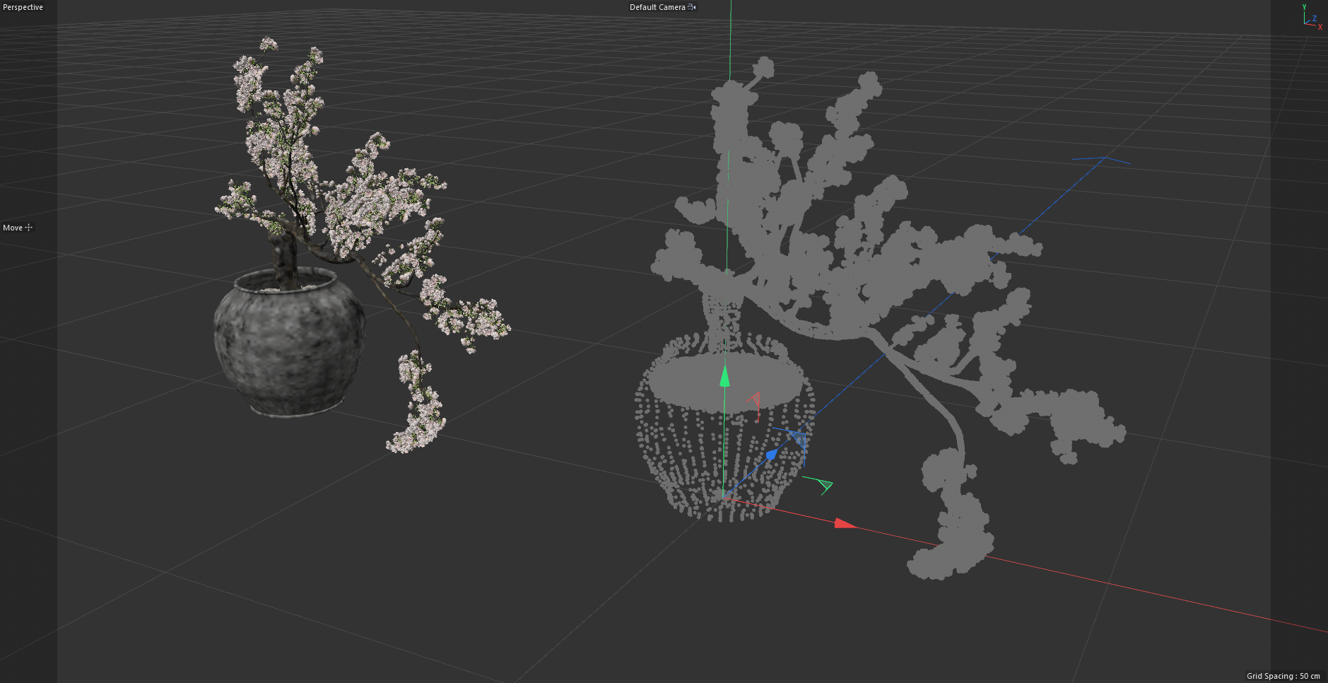

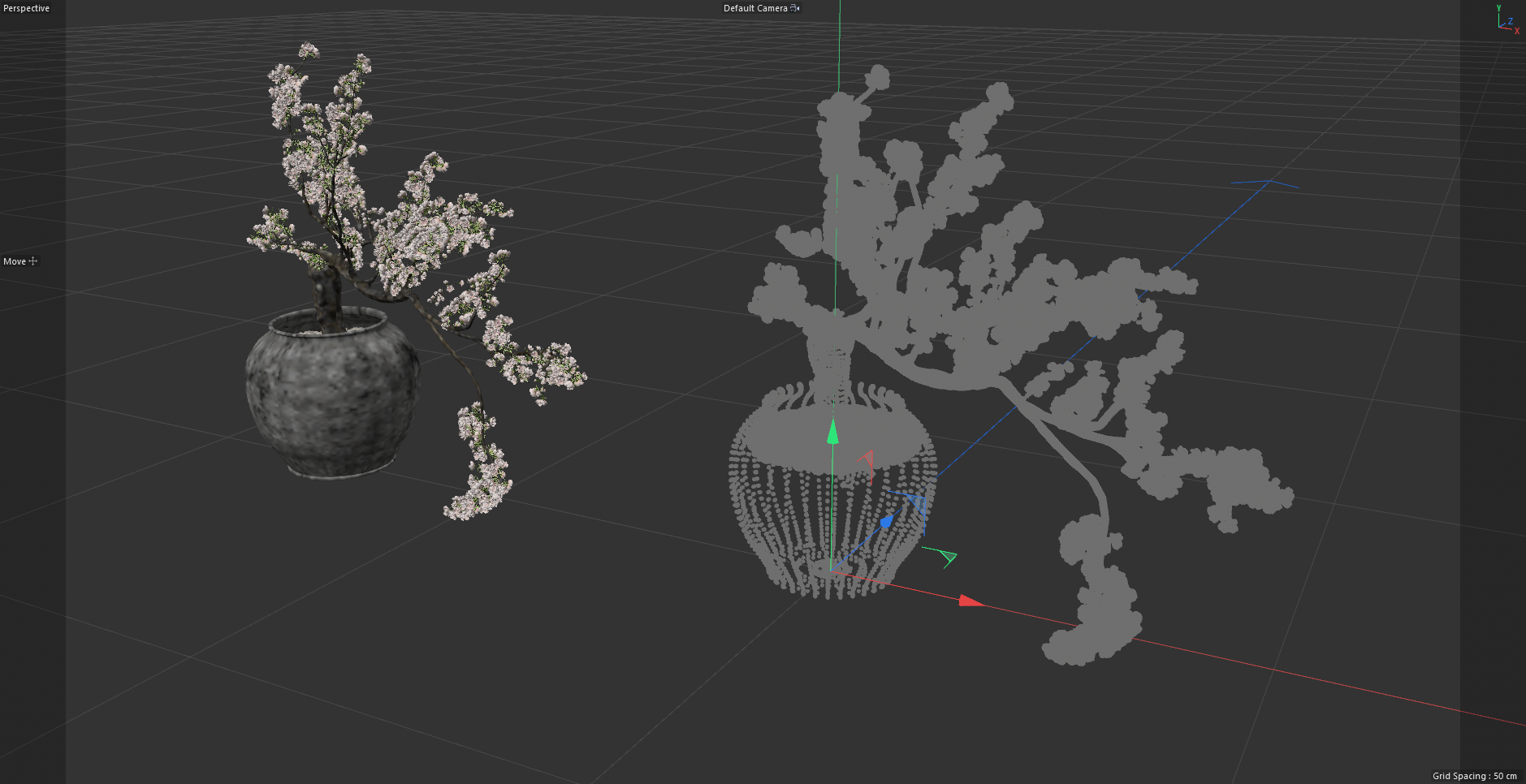

Point cloud displayed – Defines the level of visibility for the Corona Proxy object in a viewport.
The Point cloud displayed parameter is only available when the Visualization method is set to Point cloud.

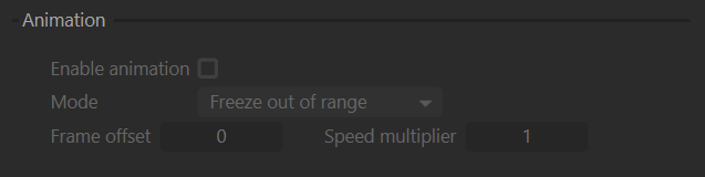

Animation
Enable animation – When enabled and if there's animation data included in the proxy file, then the object's animation will start playing.
Mode – These options allow you to select the animation playback method.
Frame offset – Offsets the animation starting point for the Corona Proxy object.
Speed multiplier – Speeds up or slows down the animation playback for the Corona Proxy object.
The animation options are only available if animation data is included in the proxy file.

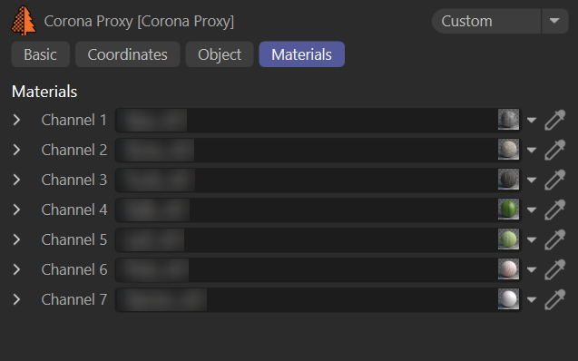

Materials
Channel 1, 2... n – All materials applied to a Corona Proxy object are listed in this tab in the form of channels. A single material must be assigned per channel. The total number of channels used for a Corona Proxy will vary depending on the materials originally applied to the mesh.
Eyedropper tool – The use of this tool allows for selecting a material to be applied to a specific material channel.
When manually loading a previously saved Corona Proxy, it will appear grey in the viewport. To resolve this, simply copy and drag only the material tags onto the proxy object. Other tags, such as the Polygon Selection, UVW, Phong, and Normals, are copied internally to the proxy. There is no need to duplicate them to the mesh.

Visualization mode = Solid bounding box

Visualization mode = Full mesh
Point cloud displayed = 1%
Point cloud displayed = 10%
Point cloud displayed = 50%
Point cloud displayed = 100%
