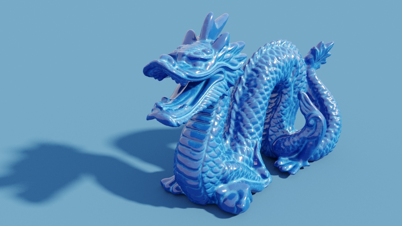

No Corona Wire shader used
A dragon object using a simple reflective material.

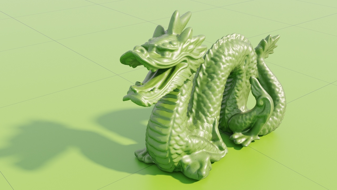

Edges Only
A new material is applied to the dragon object, with a Corona Wire shader plugged into its diffuse color. Object edges are now rendered.

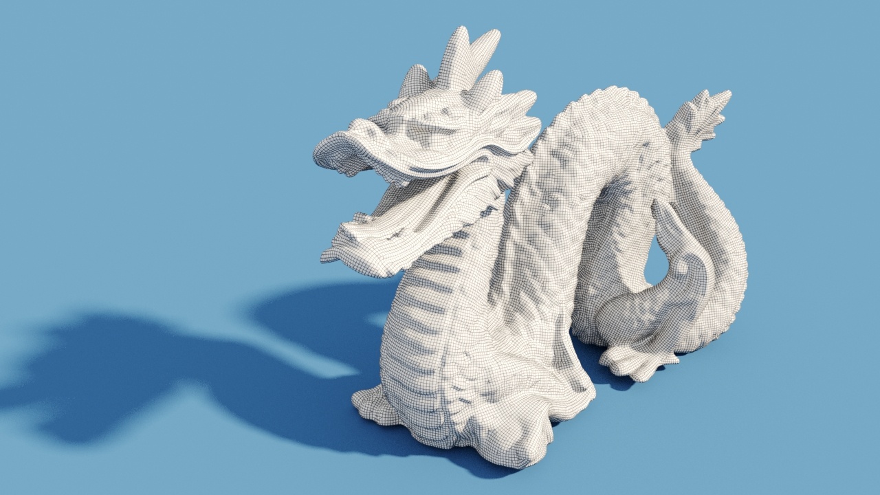

Material Override
The material override option is enabled in the General tab of the Render Settings window, overriding all scene materials to one using the Corona Wire shader. Note that both the dragon object and the ground object are affected. This is useful for rendering the whole scene with a material displaying its wires.

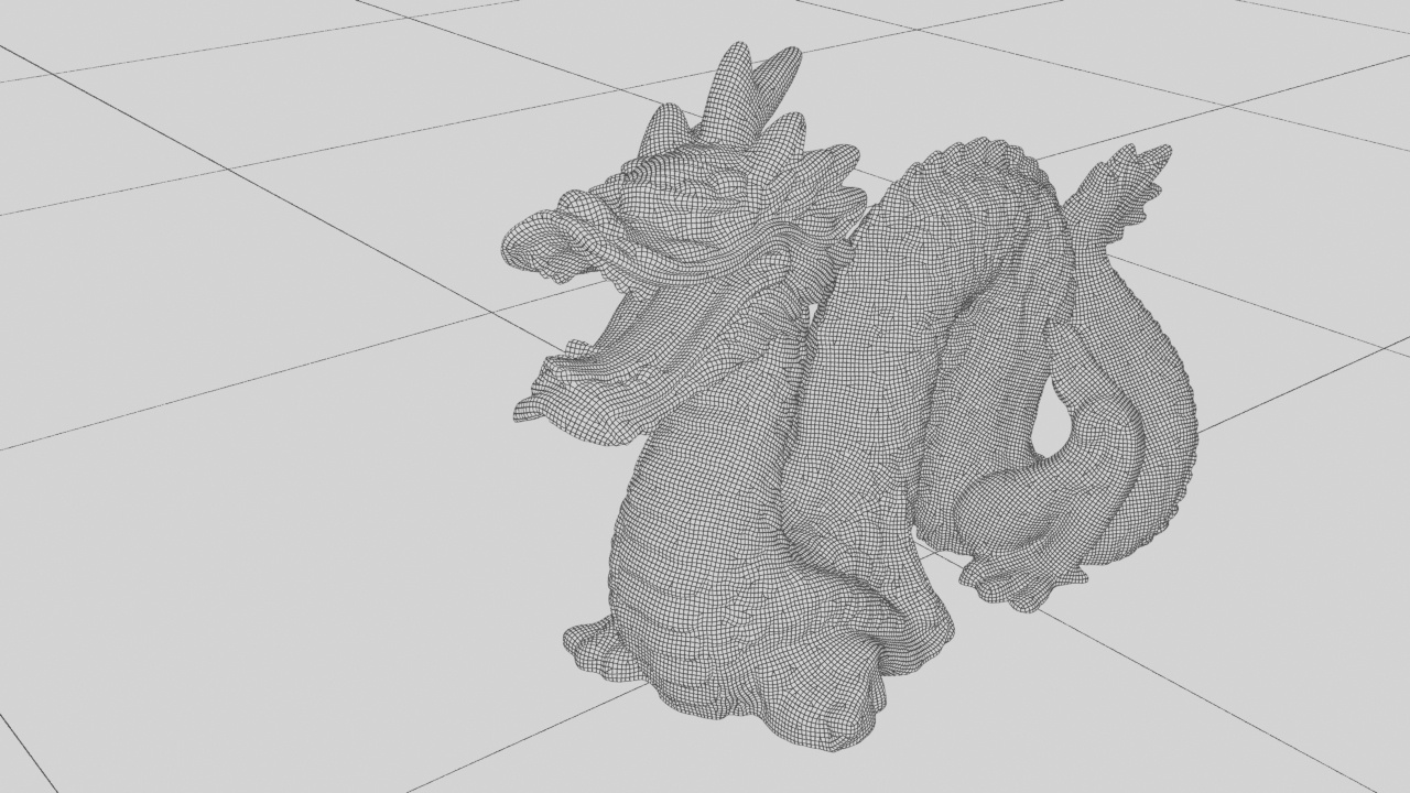

Texmap Render Pass
Texmap render pass using a Corona Wire shader. This renders the whole scene with just a single shader applied to it (in this case a Corona Wire shader). Note that there is no shading at all, since we are rendering a texture rather than the full image with shadows, reflections, and other lighting effects. This is mainly useful for checking scene geometry and for toon-style renders.
