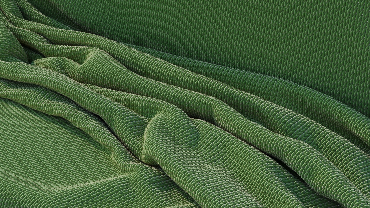

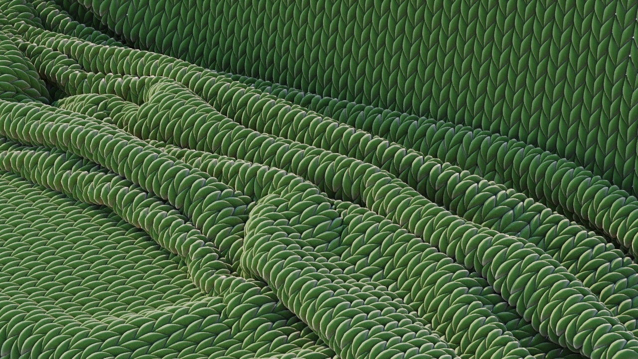

Tiling
Tiling controls the number of pattern tiles on the base object. It works exactly the same as tiling in the case of 2D textures.
U and V tiling 50.
U and V tiling 100.
U and V tiling 200.
U tiling 100, V tiling 25.

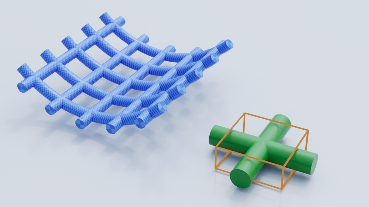

Auto-generate Caps
Green - pattern object. Blue - base object. The orange box represents the Pattern Crop Box.
Note that for the capping effect to work, the pattern object must be closed (all holes capped) and the Crop Box must be intersecting with it.
Autogenerate caps off
Autogenerate caps on

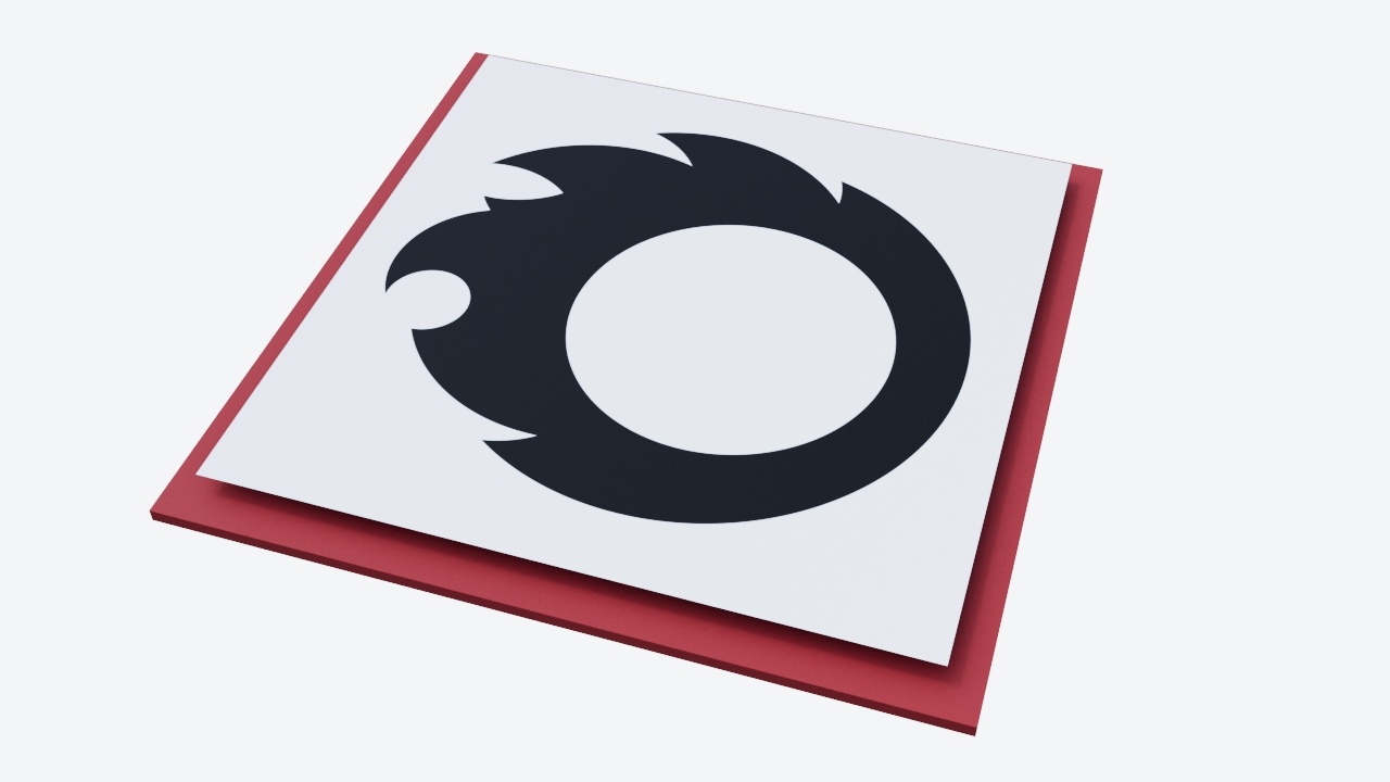

On/Off Map
In this example, the Corona Pattern Modifier is applied to the plane with the Corona logo texture. There is a red box underneath to better showcase the effect of the "Render base object" option.
The same Corona logo texture is used for the plane and the pattern "On/Off map".
Corona Pattern Modifier Disabled.
Corona Pattern Modifier Enabled.
"On/Off map" enabled. "Render base object" disabled.
"On/Off map" enabled. "Render base object" enabled.

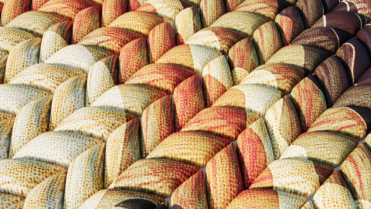

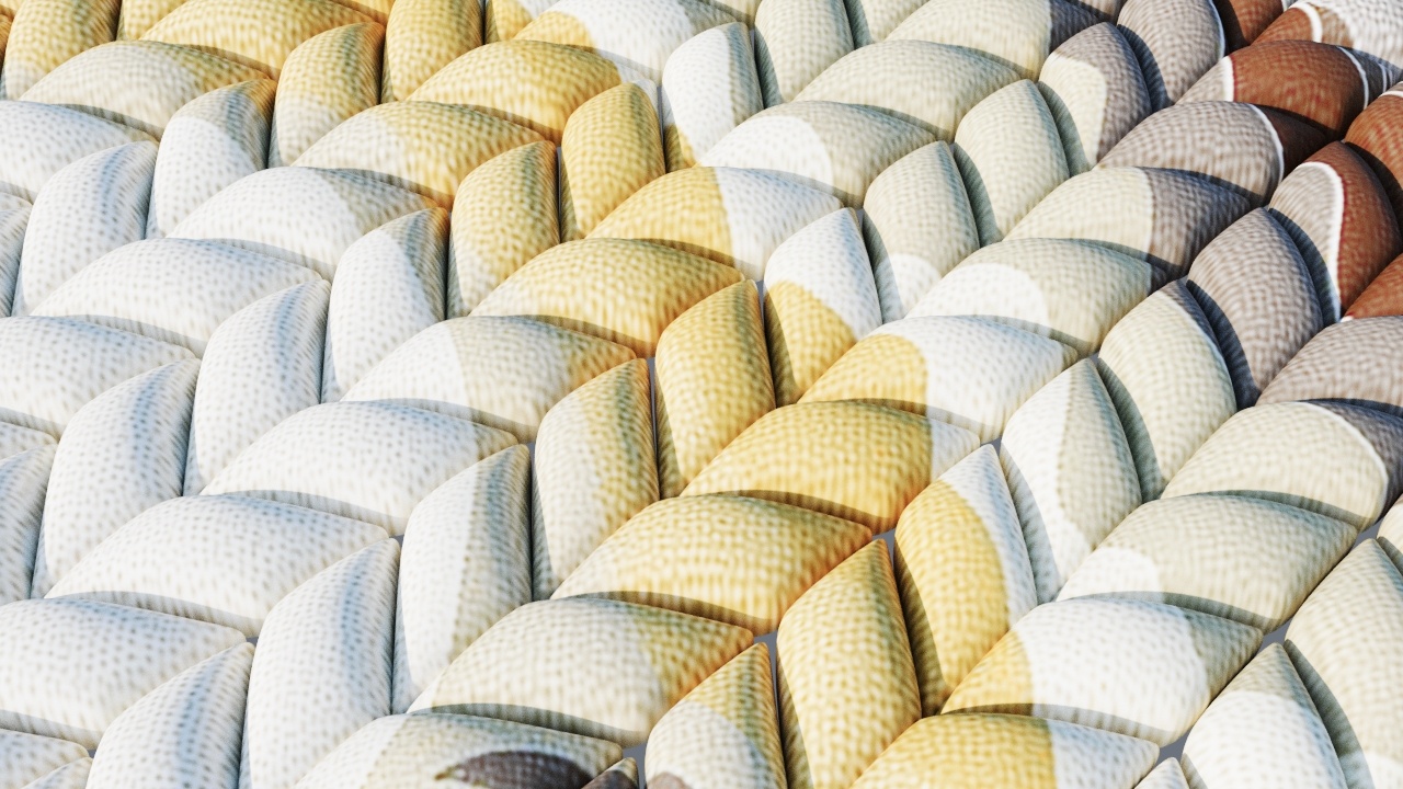

UV Mode
In this example, different textures are mapped on the pattern object and the base object. The two different mapping modes are also blended together in a single material.
To learn more about the different UV modes of the Corona Pattern Modifier and how to blend textures using them, see the Corona Pattern Modifier article in the Chaos Help Center
UV mode set to "Pattern object". The detail texture is mapped using the pattern object UVWs.
UV mode set to "Base object". The large-scale texture is mapped using the base object UVWs.
UV mode set to "Alternate both". The detail texture and the large-scale texture using different mapping types are blended together within a single material.
