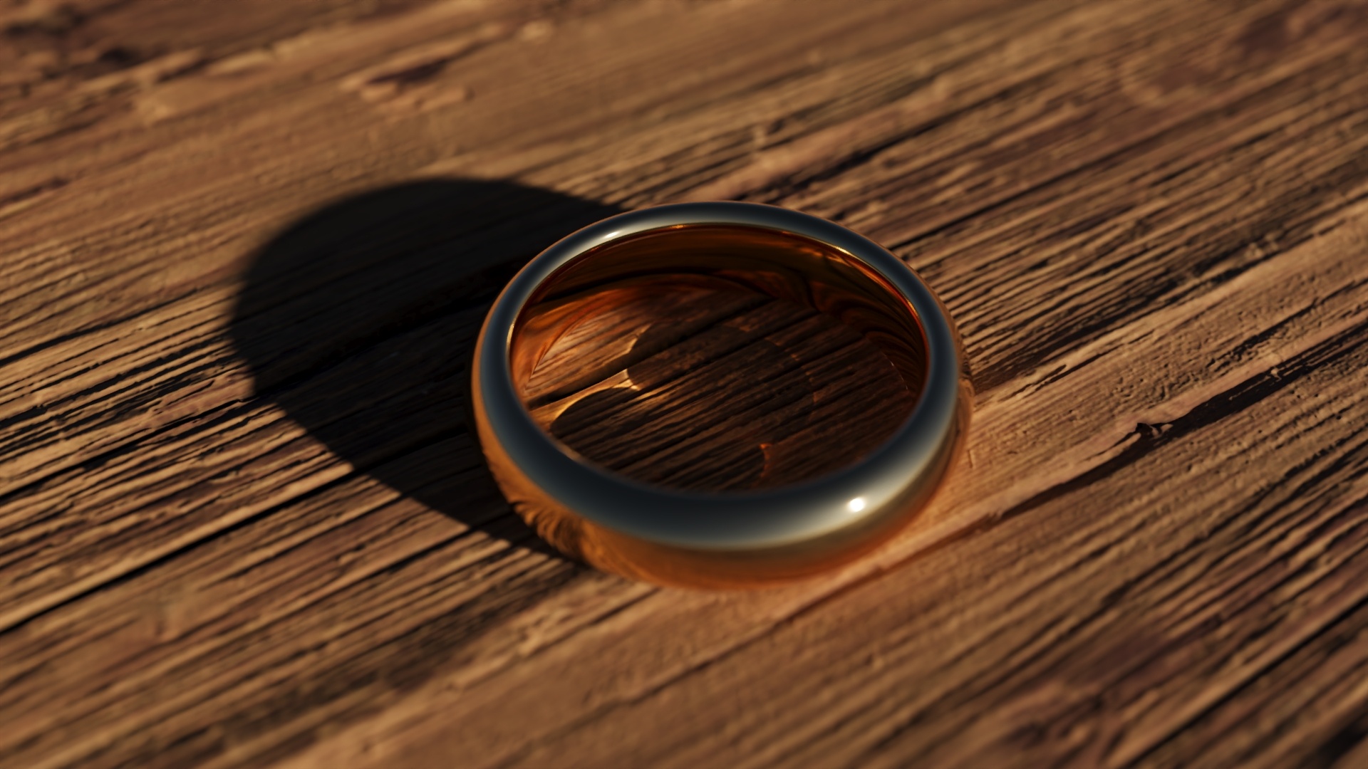

A golden ring casting reflective caustics from sunlight. No Rayswitch material used.

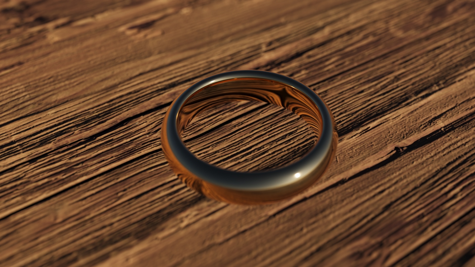

A golden ring using the Rayswitch material. Caustics are disabled by connecting a pure black Corona Legacy Material to the Global illumination slot. This prevents any light from bouncing off the ring.

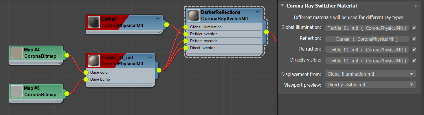

An example of making the reflections of an object less distracting using the Corona Rayswitch Material. The textile material of the chair is darker when visible in reflections thanks to a Rayswitch material with a darker diffuse material connected to the Reflection slot.
Original Material
Darker Reflections
