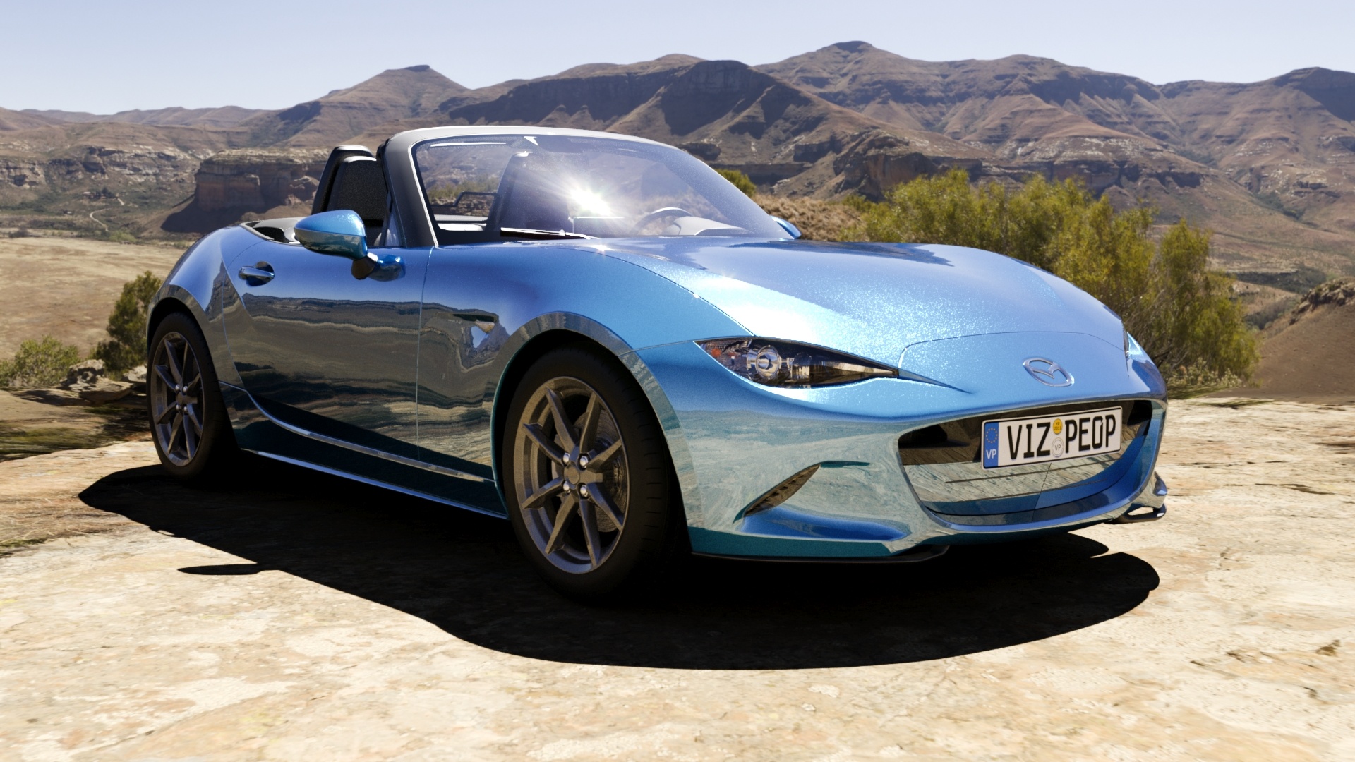

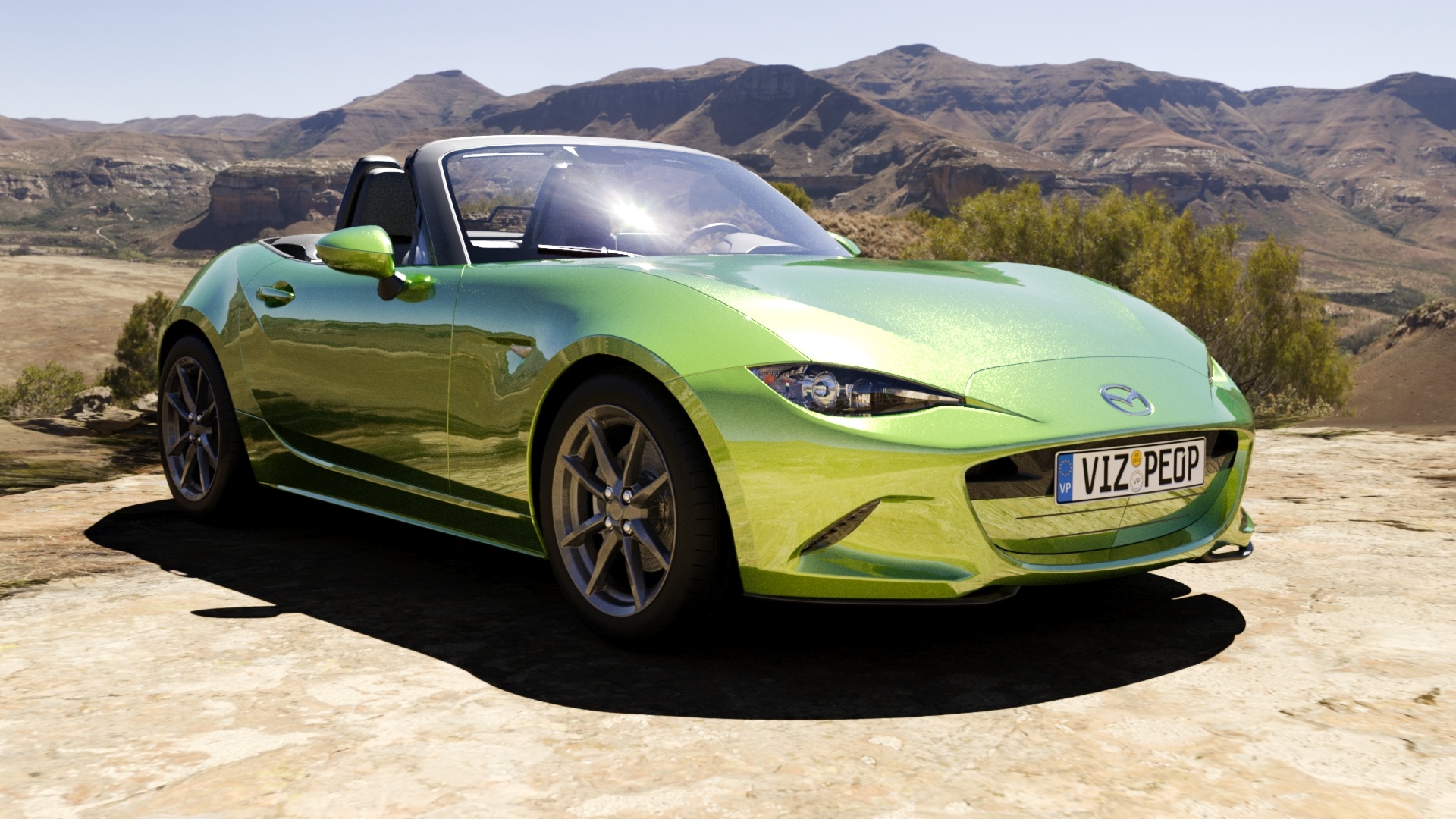

Assigning Different Materials to Objects
Three different carpaint materials are connected to a Corona Select Material, which is then applied to the car object. This way, you can cycle between different carpaint colors a single click.
Green Paint
Blue Paint
Orange Paint
