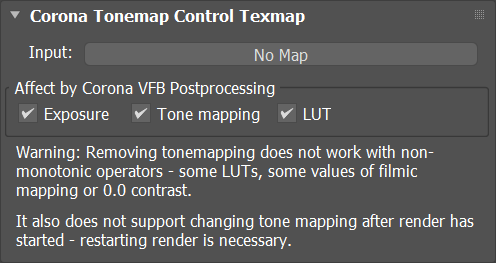

Properties
Input – The input map which is excluded from the VFB tone mapping influence.
Affect by Corona VFB Postprocessing
Exposure – When enabled, the input map is affected by custom exposure. When disabled, the map is excluded from exposure influence.
Tone mappingWhen enabled, the input map is affected by various tone mapping operators. When disabled, the map is excluded from their influence.
LUTWhen enabled, the input map is affected by the currently used LUT. When disabled, the map is excluded from LUT influence.

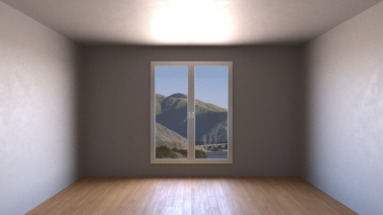

Without Corona Tonemap Control
In this example, the landscape photo is connected directly to a Corona Light Material with Emit light option disabled to create a background effect. The Corona Tonemap Control Map is not used. When the scene exposure is changed, the brightness of the background photo changes as well (e.g. when exposure is set to 4, the background becomes overexposed).
Exposure = -4
Exposure = 0
Exposure = 4

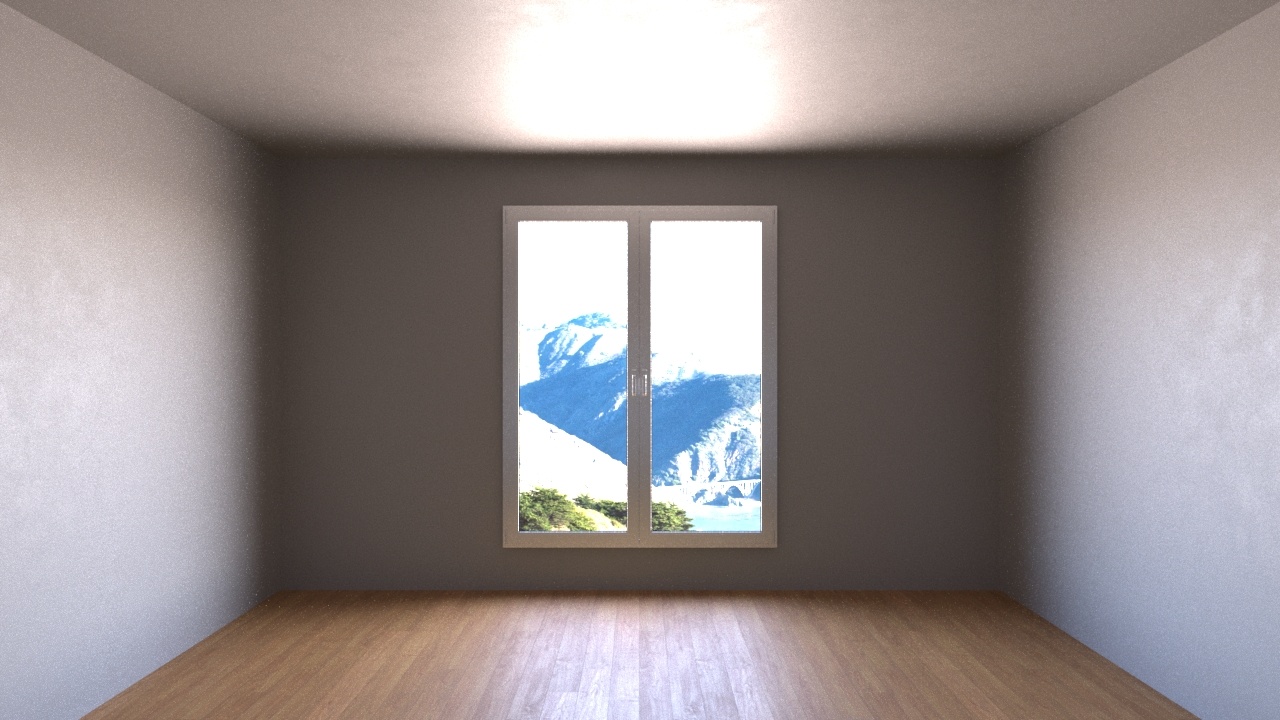

With Corona Tonemap Control
In this example, the landscape photo is connected to a Corona Tonemap Control node, and then to a Corona Light Material with Emit light option disabled. Thanks to the Tonemap Control map, even if the scene exposure is changed, the brightness of the background photo stays the same.
Exposure = -4
Exposure = 0
Exposure = 4
