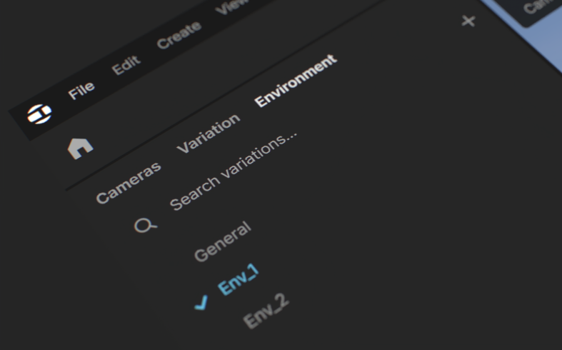

In the Environment tab, you can create variations of the environment lighting of the scene. Across these variations, you can modify all environment lighting parameters found in the Environment right-hand side tab, and achieve different lighting scenarios.

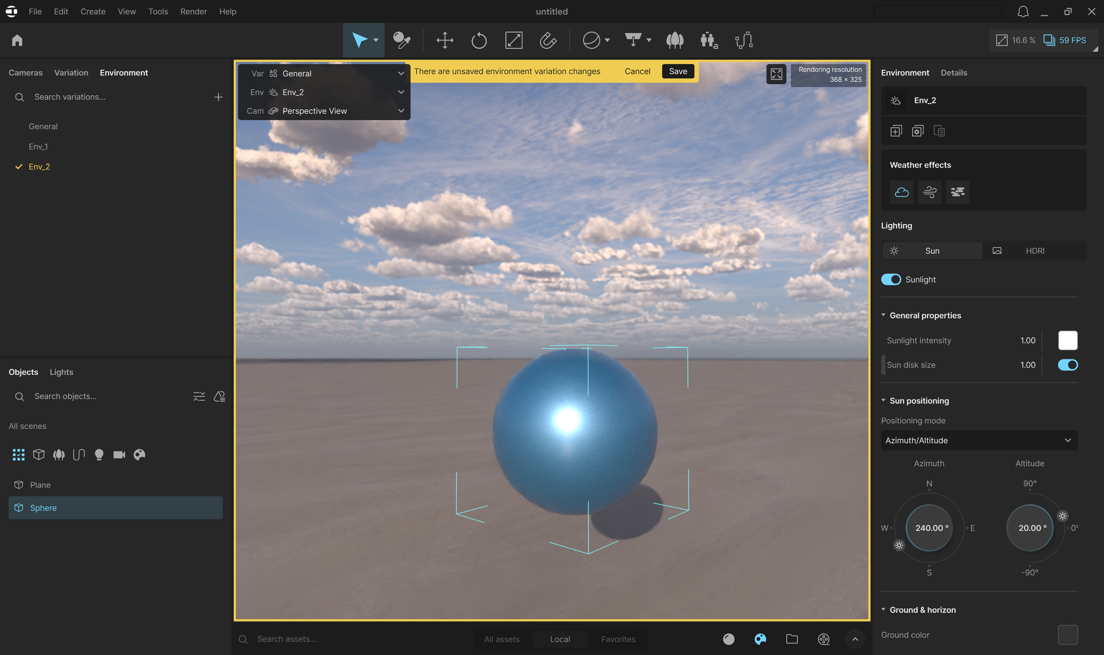

Selecting a variation from the variations list updates the viewport immediately in real time. Alternatively, you can switch between environment variations from the current view quick settings
Manage Environments

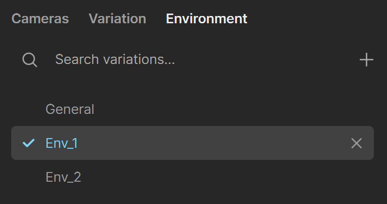

The currently applied environment variation is highlighted in blue and indicated with a check mark () in the environment list. You can search, create and delete environment variations as described in the table below.
Search variations  Searches for a specific environment variation. It filters the environment list and shows only those environment variations that contain the entry from the search field. Click thebutton on the right to clear the search.
Create a new environment variation – Allows you to create a new environment state from the settings in the Environment details tab on the right.
Remove  Deletes the selected environment variation.
A yellow frame around the viewport and a yellow highlight of the environment variation name appear every time a change is made to the current variation to prevent you from modifying it inadvertently.

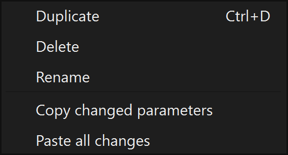

A context menu is available when you right-click on an environment variation, allowing you to perform some additional actions with variations.
Duplicate – Duplicates the selected environment variation. Shortcut: Ctrl+D
Delete – Deletes the selected environment variation.
Rename – Renames the selected environment variation.
Copy changed parameters – Copies the changed parameters of the selected environment variation.
Paste all changes – Pastes all changes from one environment variation to another.
