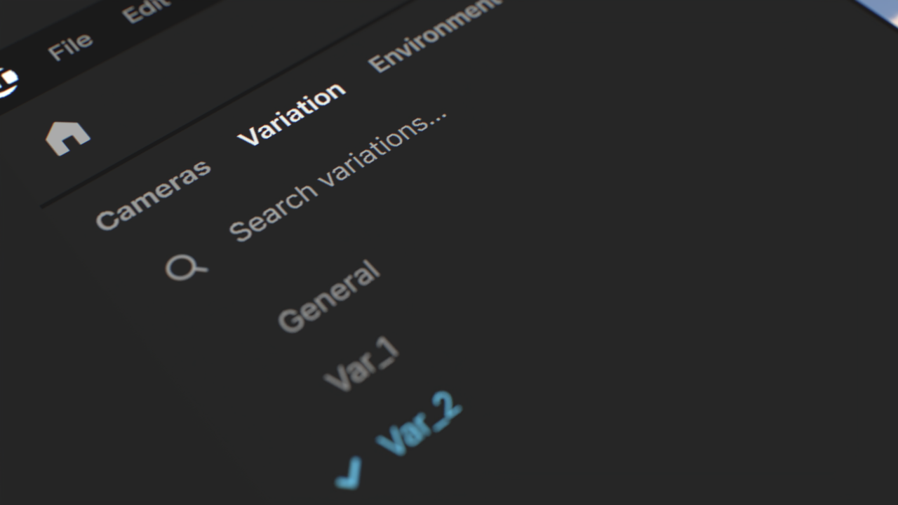

In the Variations tab, you can create scene variations.
Within the Envision timeline, the scene variations have their own track, allowing you to creatively combine and transition between them.
Selecting a variation from the variations list updates the viewport immediately in real time. Alternatively, you can switch between variations from the current view quick settings

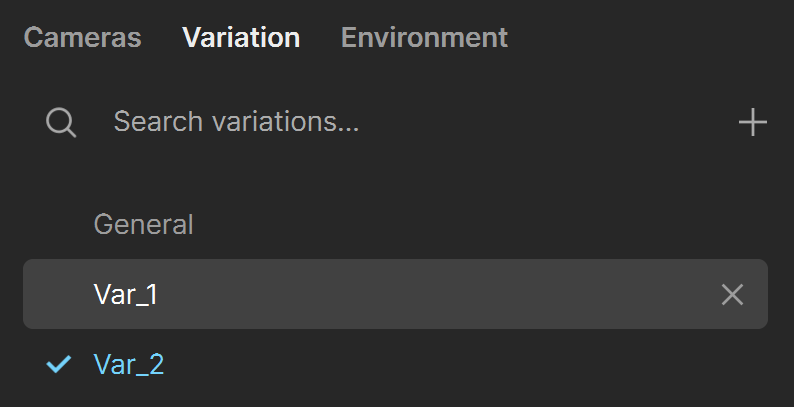

Manage Variations
The currently applied variation is highlighted in blue and indicated with a check mark () in the variations list. You can search, create and delete variations as described in the table below.
Search for a specific variation using the Search field. It filters the variations list and shows only those variations that contain the entry from the search field. Click thebutton on the right to clear the search.
Create a new variation.
Delete the selected variation.
A yellow frame around the viewport and a yellow highlight of the variation name appear every time a change is made to the current variation to prevent you from modifying it inadvertently.
When variations are used in the Animation Timeline, a transition indicator () appears next to them in the Variation list if the playhead is over a transition element in the Variations track.

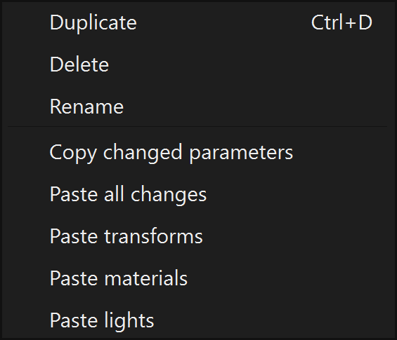

Actions with Variations
A context menu is available when you right-click on a variation, allowing you to perform some additional actions with variations.
Duplicate – Duplicates the selected variation. Shortcut: Ctrl+D
Delete – Deletes the selected variation.
Rename – Renames the selected variation.
Copy – Copies the selected variation.
Paste all changes – Pastes all changes from one variation to another.
Paste transforms – Pastes all transformation changes from one variation to another.
Paste materials – Pastes all materials from one variation to another.
Paste lights – Pastes all lights from one variation to another.
