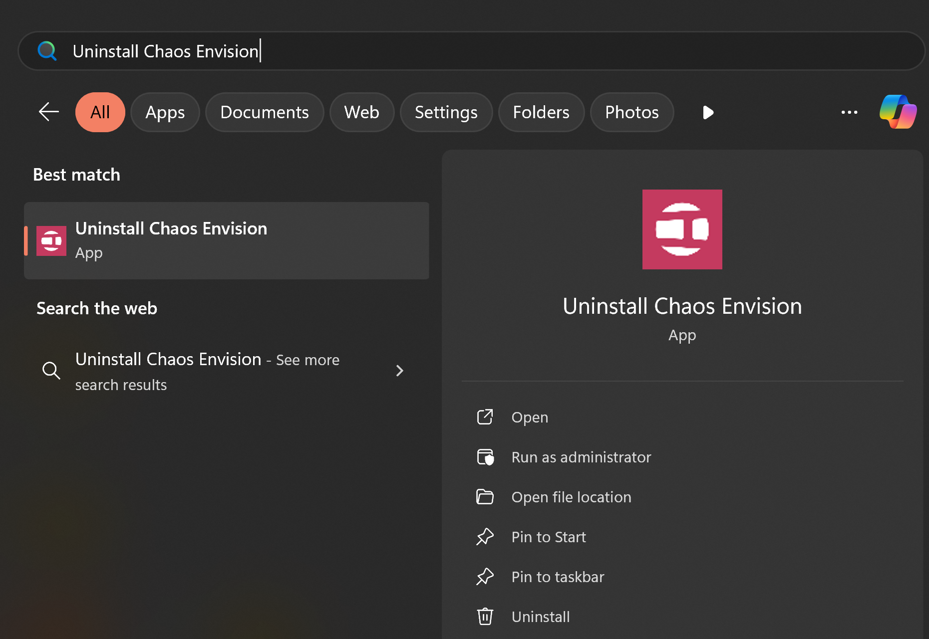

To access the Envision uninstaller from the Start menu, search for Uninstall Chaos Envision.
This starts the Envision uninstaller. Follow the on-screen instructions to remove Envision from your system and restore any files overwritten by the installation.
