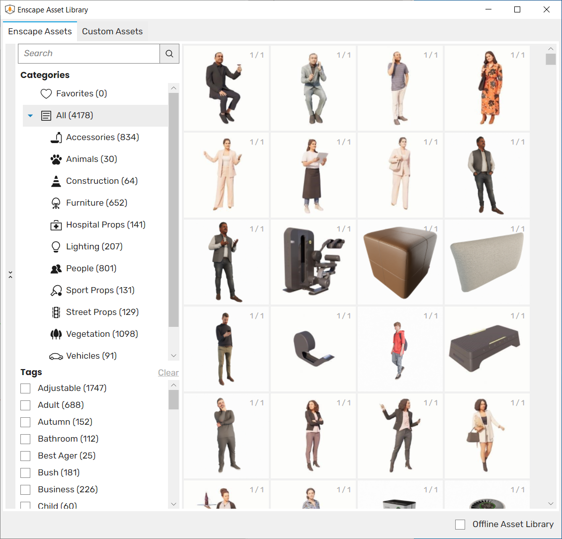

If you want to access the Asset Library panel in the Enscape Viewport, click on the associated Asset Library button in the Enscape Viewport UI, or press the [L] on your keyboard. Once opened  the following options available:
  • Search Assets function
  • Category and Tag filters
  • Asset Placement tools
  • Enscape and Custom Assets tabs
  • Offline Asset Library

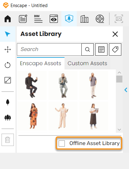

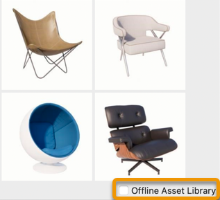

There is also an Offline Asset Library checkbox available from within the Asset Library panel in the Enscape Viewport UI.
Offline Assets checkbox in Enscape

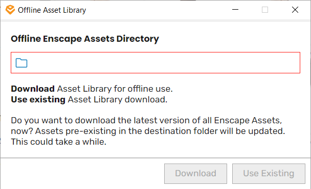

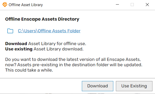

Once that is checked, a dialog will appear requesting that you define the location you would like the Offline Assets to be stored.
CAUTION: choosing a folder with existing content might result in loss of data. So please make sure to choose a dedicated folder that will only contain these downloaded Offline Assets, otherwise you may lose some files that you may otherwise have wanted to keep.
Define the location to store the Offline Assets
Another dialog will appear asking if you want to download the latest versions of all the Enscape Assets, or use the existing cached Assets, those being the Assets that have already been placed in the CAD and rendered once in the Enscape viewport.
Choose between the latest version or locally cached version of assets to use.
Selecting ‘Download’ may result in you having to wait for all assets to download (depending on internet speed, but on a good cable connection this should take approx. 5 minutes) and a progress bar will be displayed at the bottom of the Asset Library dialog to indicate the process.

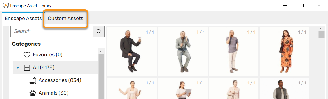

Custom Assets
Again, notice a tab for Custom Assets is available which allows you to upload and use your own assets in your projects and this is covered in depth here.
Location of Custom Asset Library

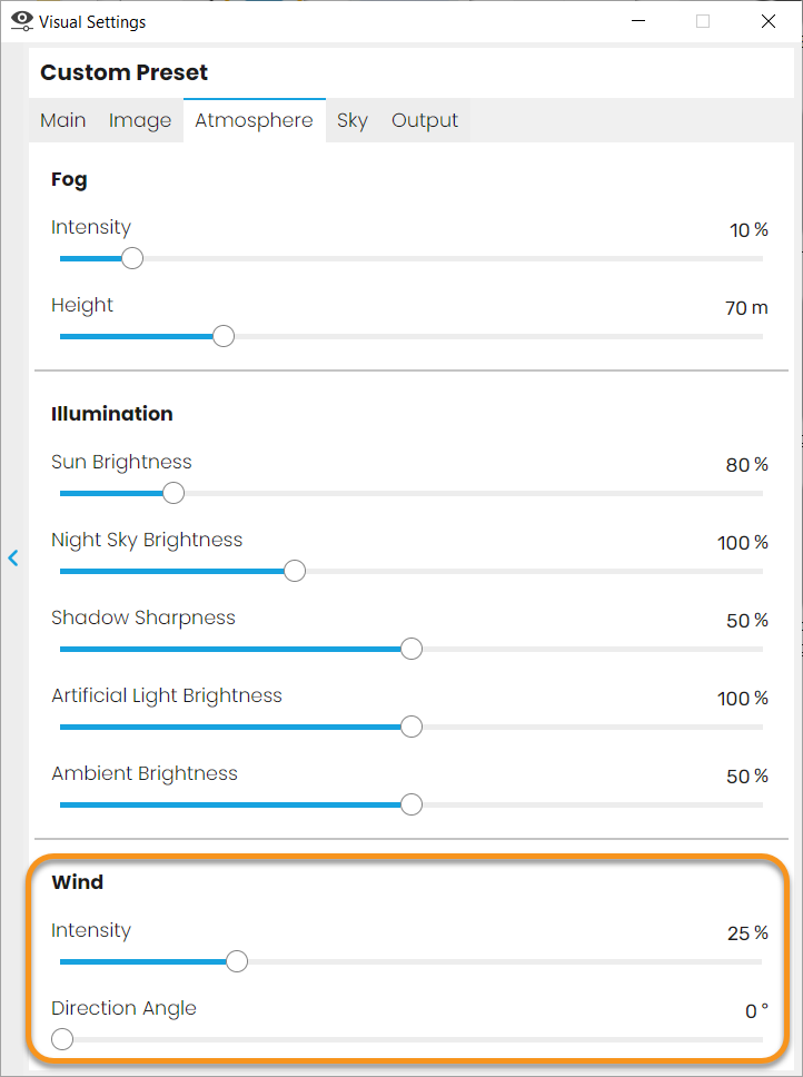

Only the tree assets are animated (although the Enscape special Grass material and the Enscape sky are also animated).  The degree of animation of these assets is affected by the Wind Settings in the Visual Setting’s Atmosphere tab, so you will need Enscape running to change these settings. The Intensity will affect how strongly the assets animate and the Direction Angle will affect the direction, in degrees, that the wind is blowing from.
It’s worth mentioning that this feature does not affect any Custom Assets.
Wind Settings in Visual Settings dialog

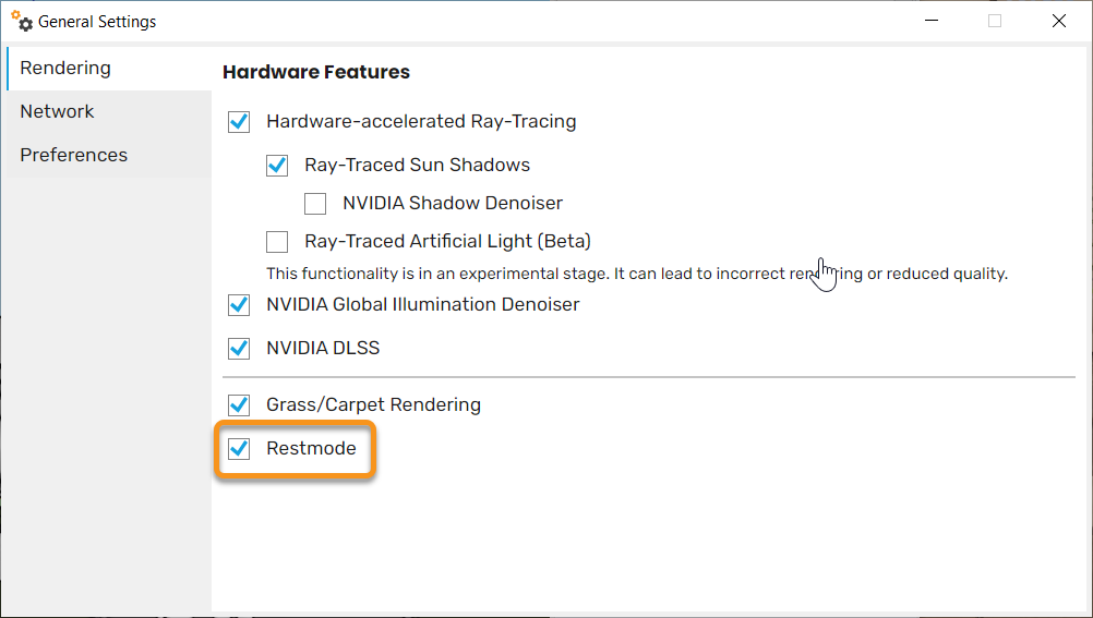

It’s also worth noting that some assets animate by default, such as vegetation, but only when moving around and for approximately another 2 seconds  after coming to rest. You can allow the assets to animate all the time by disabling Restmode. This option can be found via the CAD toolbar by clicking its associated button which will open Enscape’s General Settings dialog, where the option is found under Rendering.
Rest Mode disabled, assets will always animate
