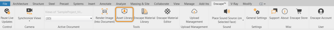

Asset Placement is achieved via the Enscape Asset Library which can be accessed in one of two ways. Either from within the CAD toolbar or from within the Enscape Viewport User Interface (UI) toolbar. This is covered in more detail in this article.
This feature is available for both Enscape and Custom Assets, but the complete feature is only available when the Asset Library is opened via the Enscape Viewport UI. The Asset Library dialog that is opened via Revit only allows for basic Single Asset Placement. But, once an asset has been placed, it then becomes available to be edited using the tools accessed via Asset Library when opened from within the Enscape Viewport UI.
This article focuses on the initial placement of assets via both methods and begins with explaining the tools available in the Enscape Viewport UI, followed by the placement methods available in Revit.
If you find the Asset Library window, or the Enscape Viewport is blocked by a notification stating that no seats are available on the current License Key, or that the License has expired, then please refer to this article.
Asset Library button in Revit

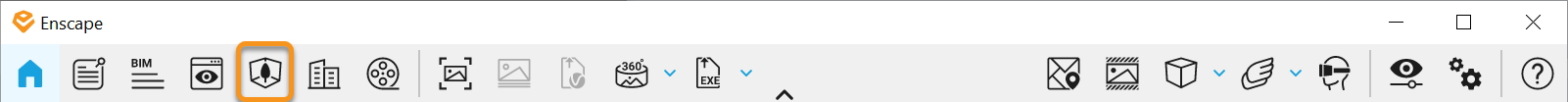

Asset Library button in the Enscape Viewport UI
Asset Library in Enscape
With the Enscape Viewport open and in focus, open the Asset Library panel either by clicking on the Asset Library button in the Enscape Viewport UI toolbar or via the [L] key on your keyboard, as illustrated below.

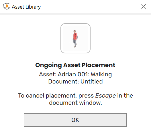

When Asset Placement is in progress in the CAD Viewport UI, placement can take place simultaneously in the Enscape Viewport as well. However, a notification will be shown, reminding you that there is an ongoing placement in progress. In case of conflicting changes, CAD Viewport takes priority.
Ongoing Asset Placement notification

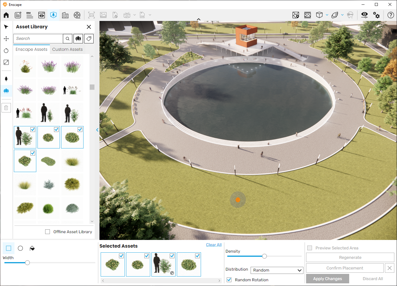

Multi Asset Placement
To speed up the asset placement process on large surfaces you can use the Multi Asset Placement tool. After clicking on the Multiple Asset Placement icon additional options will become available below the Asset Library.
Multiple Asset Placement menu

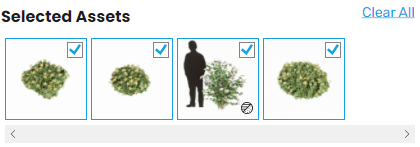

The first step to placing multiple assets is to select all the assets to be placed. Single or multiple assets can be selected and selected assets will receive a check box and will also be shown under the Selected Assets area at the bottom of the Enscape Viewport UI.
Click the checkbox in the asset thumbnail either in the Asset Library panel or under the Selected Assets area to remove individual assets from the selection. To remove all assets at once click the Clear All option in the Selected Assets area.
If Confirm Placement is clicked, the current placement can be undone by clicking Discard All.
If assets are added, or removed by unchecking them, all assets in the current selection will be repositioned.
Selected Assets
Before or after selecting the assets, you need to select one of the selection tools to scatter the assets on a surface.
There are three options available:
During the asset placement process, it is not possible to change the selection tool until the Confirm Placement button has been clicked. Or, click the Clear All option or uncheck all selected assets in the Selected Assets area first.
Area selection tools
Rectangular Selection
Selecting the Rectangular Selection option provides a way to stipulate a limited area the assets will be placed in. Once selected, by moving the mouse over a surface in the Enscape Viewport the user will see a circle with a control point in the middle to assist in choosing the origin of the rectangular area to be specified. Once you have clicked on the surface to specify that origin, 2 orange control points will appear. One control point will anchor itself to the surface to act as a pivot point and the other control point will follow the mouse movement to specify the length of the rectangle. When you finally click to specify the length of the rectangular area some proxy assets will appear within that specified area. You can increase the width of the rectangle at any point during this process by adjusting the Width slider located below the 3 selection tools.
You can continue to adjust the size of the rectangle by clicking on either of the 2 orange control points which will allow you to adjust the rectangle’s orientation and size. The assets will be recalculated and regenerated to accommodate changes made to the selection area.
You can continue to make adjustments up until you click on the Confirm Placement button. Once Confirm Placement has been clicked, you can continue to specify other selection areas using any of the 3 selection tools. Only after you click on the Apply Changes button will the full asset geometry and the associated asset textures be placed in the project.
At that point the individual assets will be available for individual editing or deletion.
If you want to start placement again, click on the Discard All button.
Circular Selection
Similarly, the Circular Selection tool allows you to specify a circular area of a surface for a selection of multiple assets to be placed on.
As with the Rectangular Selection option, the first click will specify the point that will be the center of the circular selection. Two control points will then become available. The control point at the center of the circular area specifies the pivot point or the center of the circular area. The second control point will follow the mouse movement to allow the user to specify the initial diameter of the circular area. Once specified, asset proxy models will appear within the defined circular area. You can continue to adjust the size and position of the circular area by clicking and dragging the respective orange control points.
As with the Rectangular Selection tool click on Confirm Placement to continue creating other areas. Click Apply Changes when you are done placing assets to load the full geometry and textures and allow for individual asset editing.
Bucket Selection
The Bucket Selection tool will place assets on to an available surface. Hovering the mouse around in the Enscape Viewport when the Bucket Selection tool is selected will show a bucket symbol instead of the mouse pointer and any surfaces that are available for asset placement will be highlighted as you hover over them. Once a surface for asset placement has been identified click on that highlighted surface and proxy models of the selected assets will be placed on that surface as a preview. That means the assets will not be fixed in place until you click on the Confirm Placement button.
If you click on another surface before clicking the Confirm Placement button, the proxy assets will be removed from the previous surface and applied to the newly selected surface.
Once you are happy with the placement of the assets, click on Confirm Placement and then Apply Changes to finalize the placement of the selected assets. If you want to start placement again, click on the Discard All button. This will then revert the tool back to a state where you can continue to place assets.
Density
The Density tool determines how many assets will be placed in total.
For example, you may have only chosen a total of 3 assets from the Asset Library, adjusting the Density slider will increase or decrease the number of the 3 selected assets to be placed in the selected area or on the selected surface. This is particularly useful for placing vegetation, for example.
Using the highest density could potentially lead to performance issues on large surfaces.
Distribution
The Distribution drop down menu determines the way in which the assets are placed.
The 3 options available include:
  • Random: no placement pattern is followed, and assets are placed randomly. This is better suited for large surfaces.
  • Jitter: assets are placed on a grid based layout, but with a random offset. In large areas, the pattern may be more easily noticeable.
  • Uniform: assets are placed on a grid layout.
Random Rotation
The Random Rotation checkbox, when checked, will randomize the selected assets on the XY plane. This option is enabled by default. If unchecked, all placed assets in the current selection will face the same direction. This can be useful when placing a group of spectators, for example.
Preview Selected Area
If Preview Selected Area is checked, the complete assets geometry and textures will be loaded and shown in the Enscape Viewport.
Regenerate
If the Regenerate button is clicked the selected assets will appear in another position specified by the currently active  placement settings (Density, Distribution, and Random Rotation).
After the Regenerate button is clicked, the Preview Selected Area option will be disabled (unchecked) if it was enabled when the Regenerate button was clicked.
Confirm Placement
Once assets are placed in the desired position, clicking on the Confirm Placement button will fix the assets position, although the asset will continue to be shown as the low poly proxy version by default. Once Confirm Placement has been clicked, assets can not be edited or deleted as a group and must be dealt with individually. Additionally, the area selection guides will disappear.
Alternatively, you can simply click on the Undo option in the Revit UI.
Apply Changes
Click the Apply Changes button to load the full asset geometry and its associated textures (if Preview Selected Area is disabled). Apply Changes will only become available after Confirm Placement has been clicked. This is also valid for Single Asset Placement.
Discard All
The Discard All button will only become available once Confirm Placement has been clicked, and it will remove all that have not been applied by the Apply Changes button.

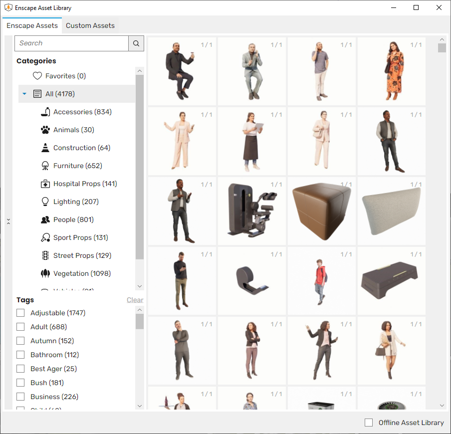

Asset Library in Revit
When  the Asset Library is opened via Revit, initial placement of assets must be performed in the Revit UI and it is only possible to place single assets via this method. The tools provided within the Enscape Viewport UI to scale and move an asset, as well as the Multi Asset Placement feature are only available when opening the Asset Library from within the Enscape Viewport UI.
What follows is a guide on how to place assets via Revit. This is only possible by opening the Asset Library via the associated button available in the Revit menu and not from within the Enscape Viewport UI.
Lastly, the Asset Library when opened via Revit does not require the Enscape Viewport to be open.
Revit side Asset Library dialog

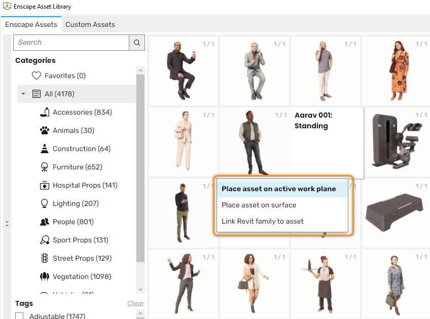

We have three ways to place an asset in Revit.
The option available are:
  • Place asset on active work plane (default) – this will result in the asset being placed on the active Work Plane only. You can set the Work Plane via the Revit -> Architecture -> Work Plane -> Set
  • Place asset on surface – this will result in you have to select the surface you want to place the asset on to first, and then the precise location on that surface.
  • Link Revit family to asset – this will replace one of the existing families in the project with the current asset.

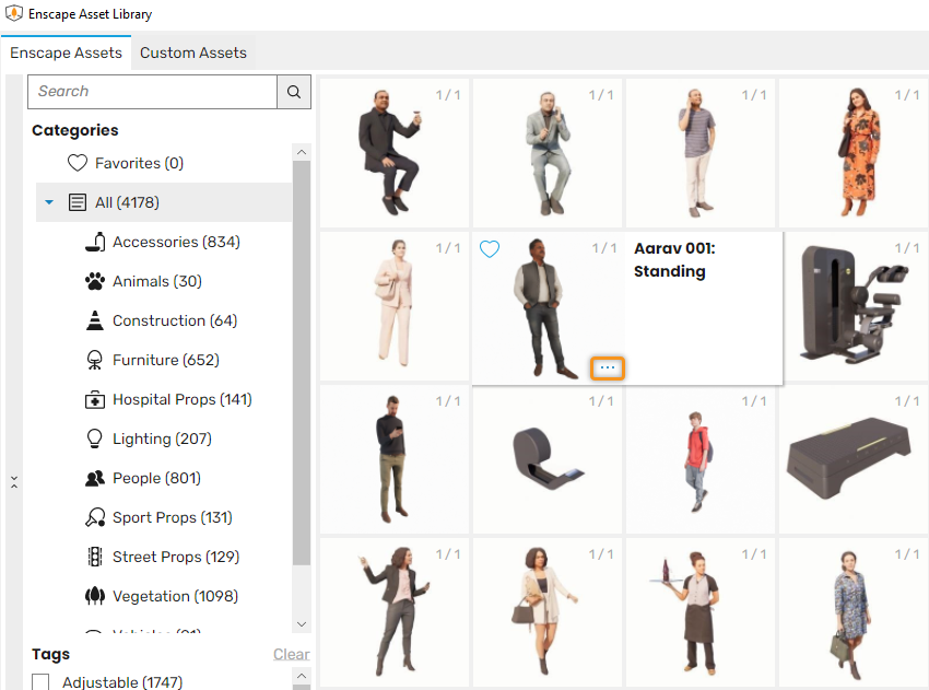

These options are available by clicking on a button that is displayed when hovering over one of the assets in the Asset Library.
Location of the asset placement button in the Asset Library for Revit
Click on that button to reveal the three options available to you.
The asset's placement options menu

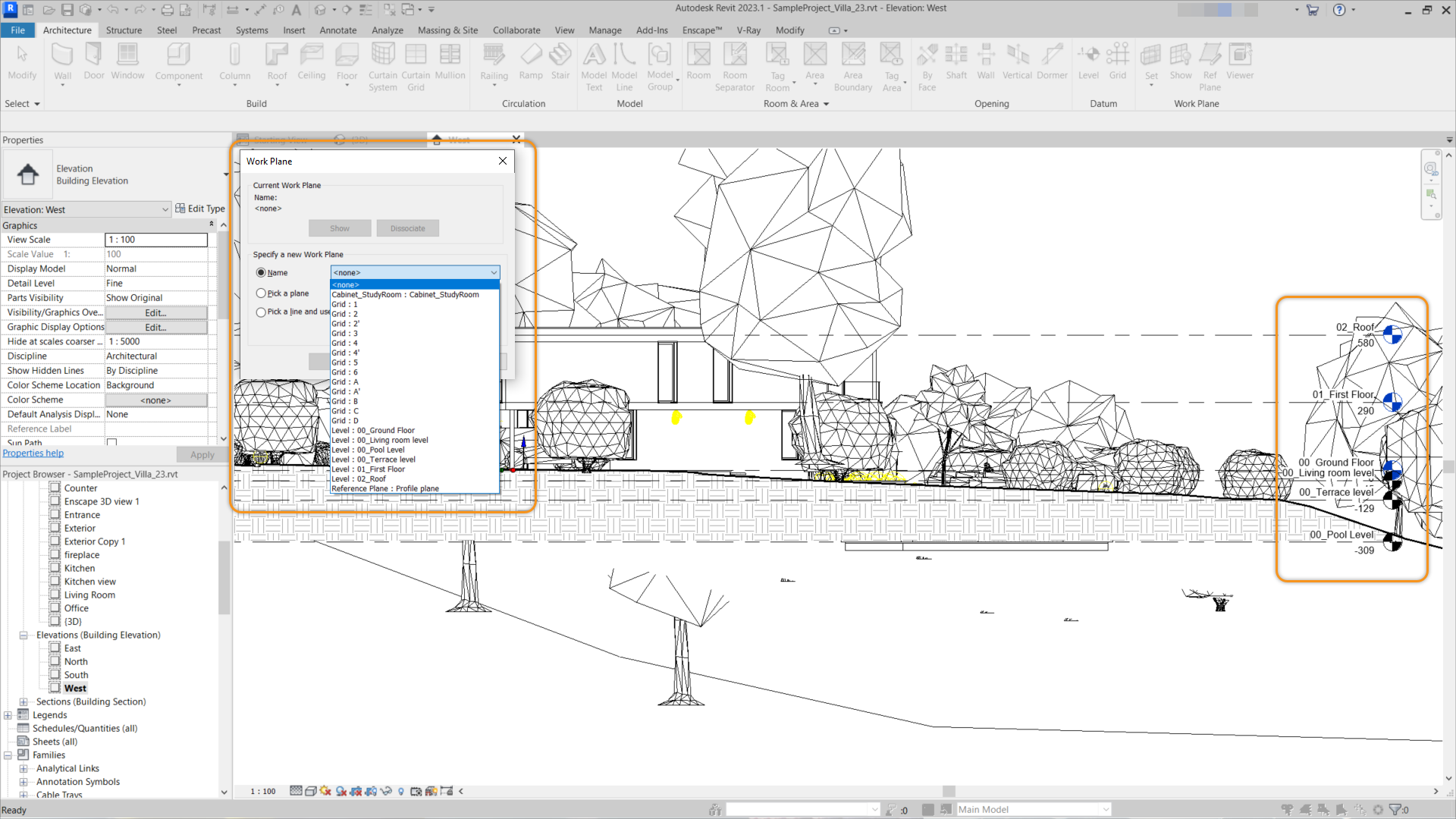

Place Asset on Active Work Plane (Default)
Placing an asset on an active Work Plane means you need to select the work plane you want to place the asset on.
Select Architecture –> Work Plane –> Set, and in the Revit dialog, a drop down will allow you to see what levels there are.
Select the active Work Plane

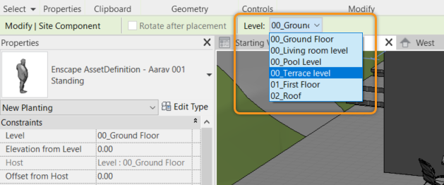

Once you have decided which work plane you want to place the asset on, select the Place asset on active work plane (default) option for the asset. Once you hover your mouse over the Revit viewport, you will see some Revit ‘Guides’ as well as a low poly proxy of the asset to assist in placement within the project.
Don’t click yet, first check that the correct Level is also selected from the drop down associated with the Modify | Site Component option in Revit.
Check the level is correctly selected before placing asset
Click to place the asset. The asset proxy model will turn slightly darker in the Revit viewport, indicating the asset is ‘placed’.
You can carry on placing more instances of the asset up until you press the [ESC] key twice, which will drop the current asset and bring the Asset Library back into focus for you to either choose another asset, or close the Asset Library. Pressing the [ESC] key before placing the second asset, and pressing [ESC] a second time will close the Asset Library and Enscape will update the view appropriately.

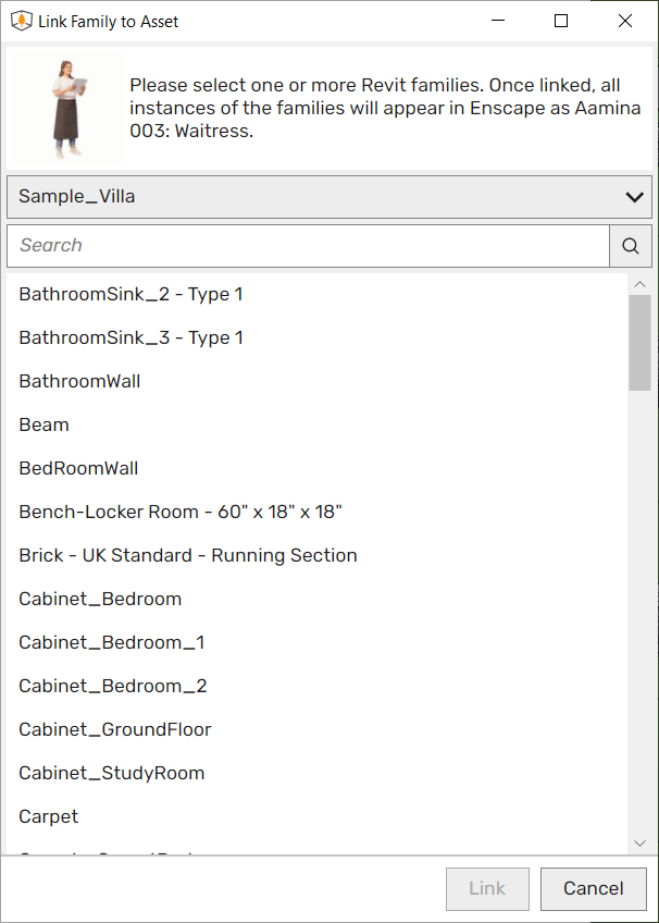

Link Revit Family to Asset
Choosing this option to place an asset will open up a window names Select Target Family where a list of the families that are already placed in the project will be shown.
In the following example, to place the asset where ever the Bench appears, we select Bench from the Target Family window. This will then replace the target family in the Enscape window with the asset you chose from the Asset Library. Close the Asset Library when finished placing the assets.
To remove a linked asset from a Revit family, you can open up the Revit Family Parameters dialog and remove the EnscapeAssetId, which will remove the link.
