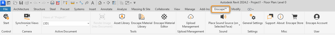

After the Enscape .exe installer has finished running and has been closed, you should then be able to see Enscape as a top level menu option within Revit’s top level menu structure within its User Interface (UI).
If you can see the Enscape top level menu option, then clicking on it should result in the Enscape ribbon becoming visible, as shown in the following screenshot.
Location of the Enscape menu in Revit
