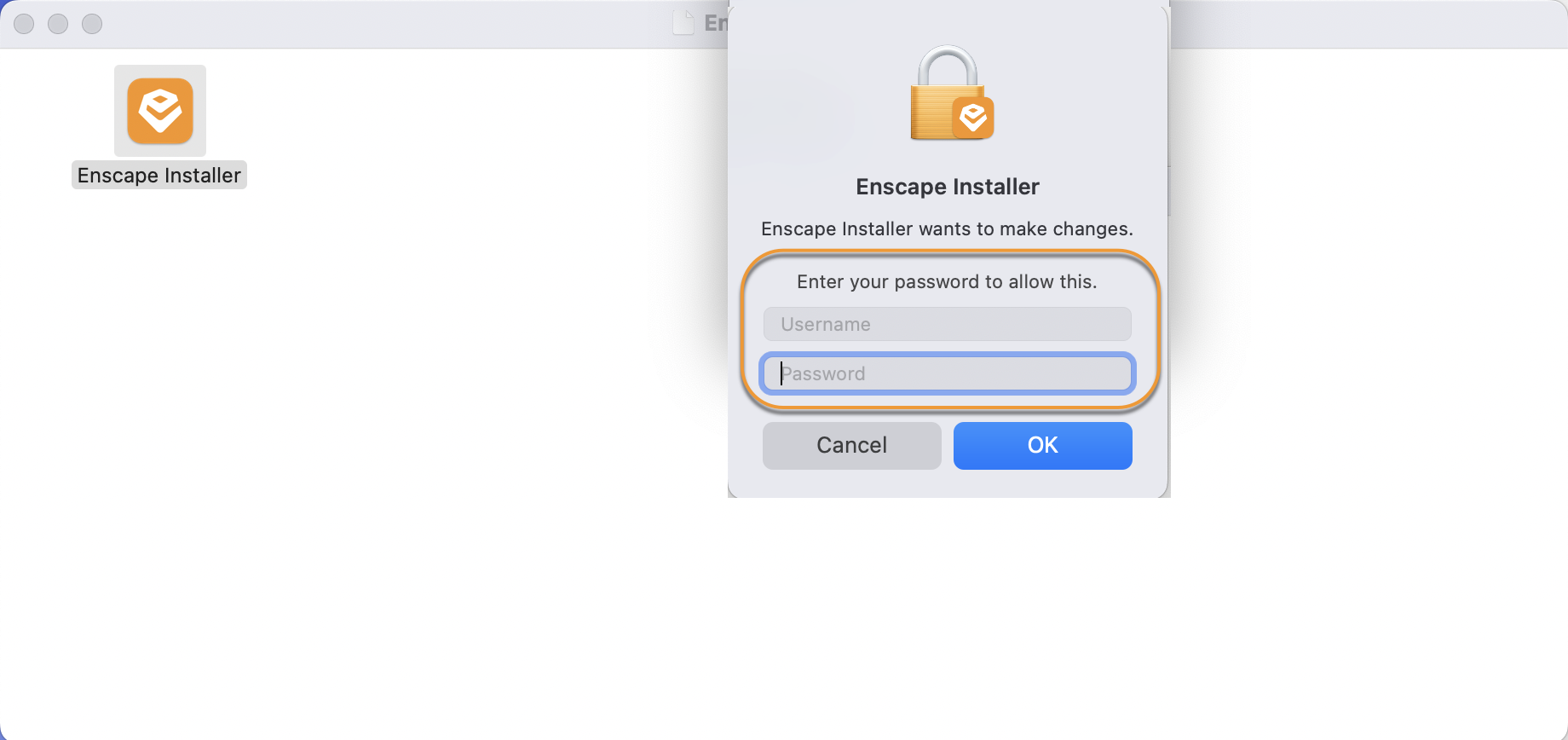

Installing Enscape for the first time should be simple and straightforward. For the best results we recommend making sure that your CAD software is not running before you install Enscape. You can then simply open and run the Enscape installer from the location on your machine that it was downloaded to. At the beginning of the installation you will be prompted to enter the username and password of an admin account even if you are logged in as that admin. This could be a familiar behaviour to other standard installations.

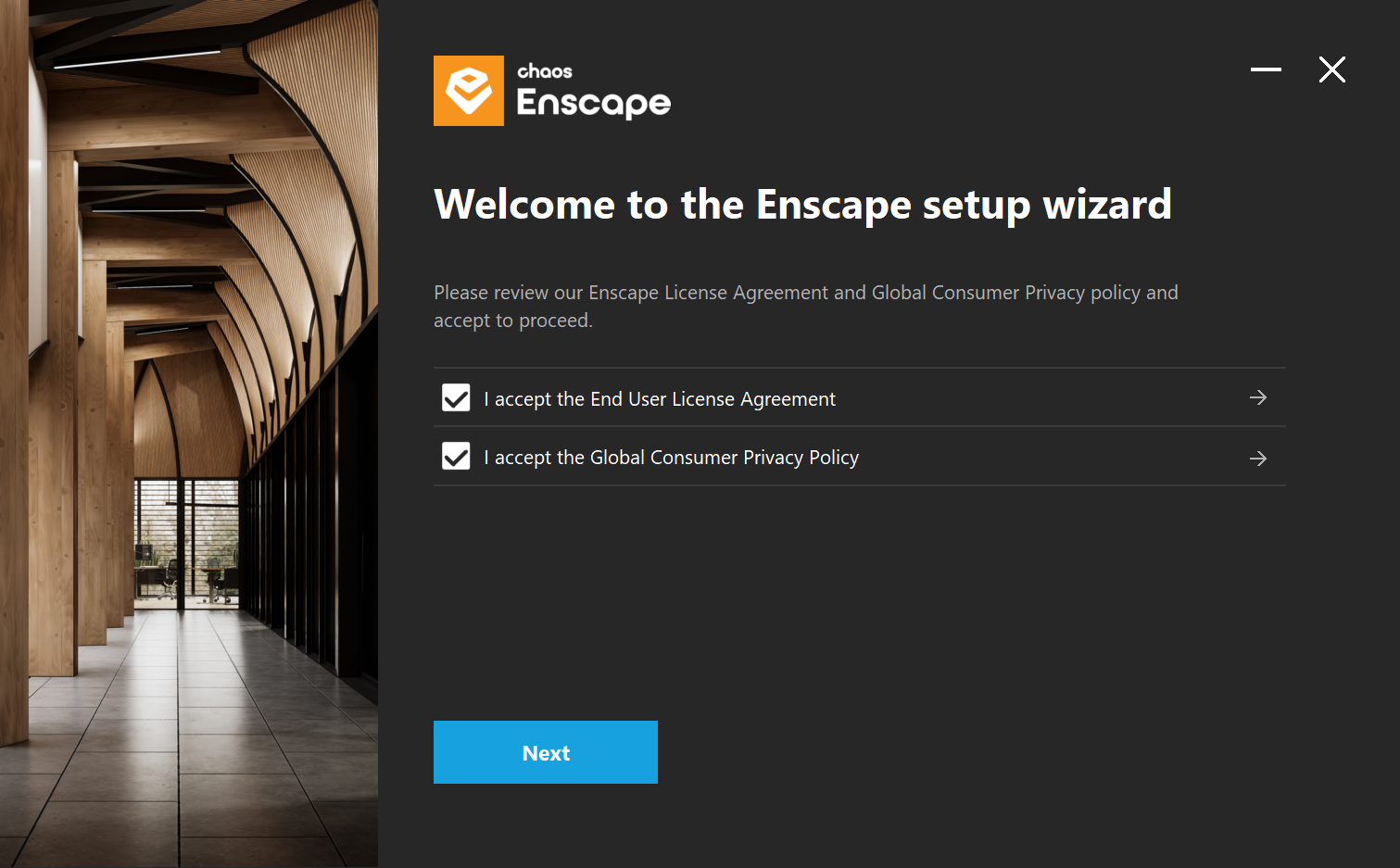

When installing Enscape, a wizard will guide you through the various steps of the installation process. To continue, you will be prompted to accept the End-User License Agreement (EULA) as well as the Global Consumer Privacy Policy (GCPP). Click Next once you have read and are ready to continue with the installation.

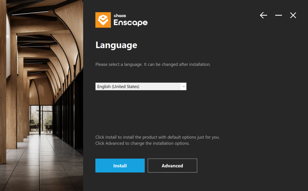

Language
You will be asked to select a language you want to use Enscape in and you can choose from a list of selected languages. English will be selected by default. If you are ready, you can simply click Install to continue installing.

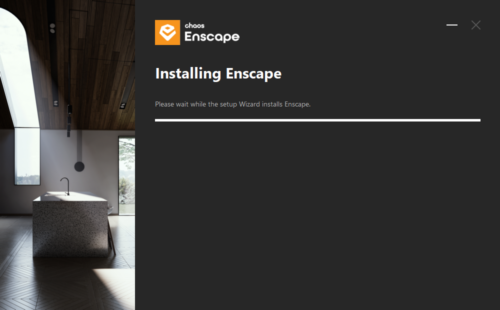

The installer will then run and you should see this in the installer window as shown in the following screenshots. Enscape will identify if a previous version is already installed. That version will automatically be uninstalled first.
Your chosen version of the Enscape plugin would then be installed.

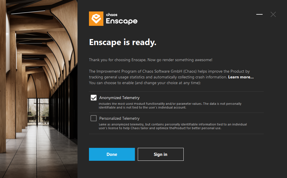

Once signed in to your Chaos account, you will get a confirmation that Enscape is ready.

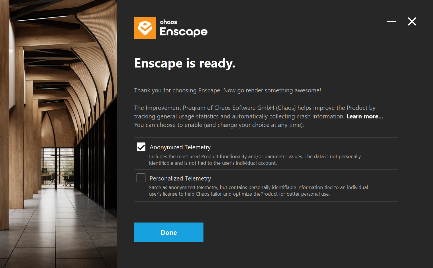

To further improve your experience with our tools, we kindly ask you here to share some telemetry data about your usage with us. You can change these settings at any time!

You can see the Advanced button becomes available once you accept the license agreement, whereby you will be asked to select the Language. The Advanced button is available only at this point of the installation process and will give you additional options for the Installation Scope. As this option is only available on a fresh installation of Enscape, if you want to access these options again, then you will need to uninstall and reinstall Enscape first.

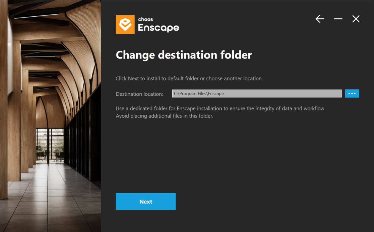

When you click on Advanced, it will allow you to specify a custom installation location by navigating to the location you want to install Enscape to by clicking the three dots on the right side of the destination path. Once ready, click Next.

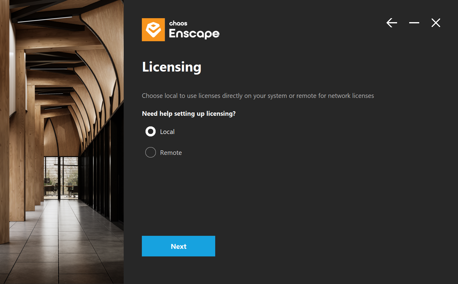

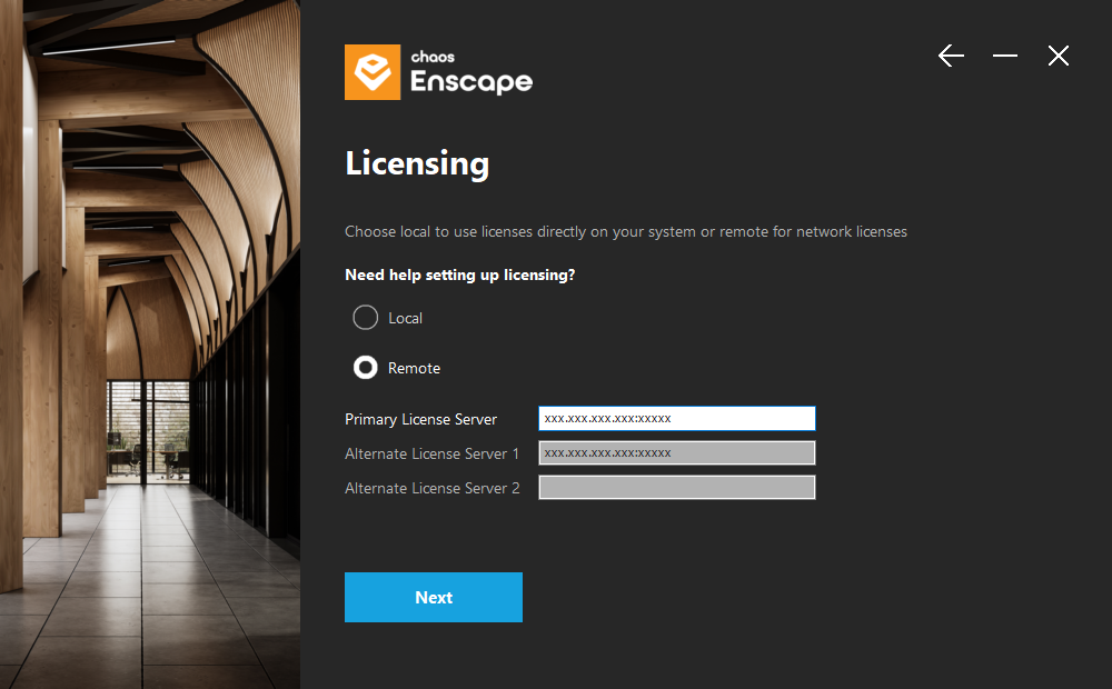

In the next window you can specify where your Enscape license should be retrieved from. Choose Local to use licenses directly on your system (Fixed-Seat License or Floating License with a local License Server) or Remote to use a network license (Floating License with a remote License Server).
Local License
If you select Local you directly go on with the installation process by clicking Next.

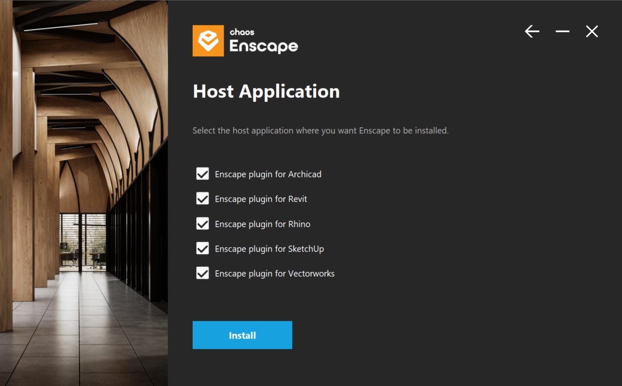

After clicking Next, you can specify whether to install the plugin for only one specific CAD, multiple CADs, or for all CAD’s.

Remote License
If you select Remote you can define your License server(s) before clicking Next.
