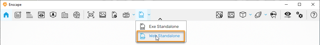

You will need to click the small arrow next to the Executable Standalone to reveal a drop down menu where the option Web Standalone is located. This is the process each time you want to create a Web Standalone.

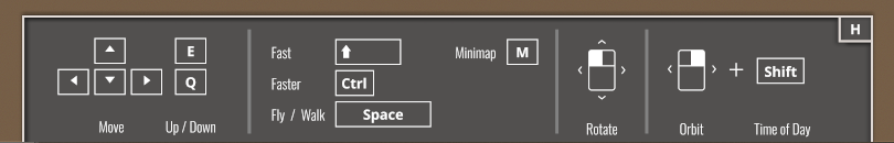

The Help Overlay appears automatically when the web standalone is opened. You can toggle it on and off using the H key on your keyboard. Movement in any direction can be controlled on your keyboard via the arrow keys, and the E and Q keys to move up and down, respectively. To speed up the movement somewhat, hold the Shift key; to speed it up even more, hold the CRTL key. Toggle between Fly and Walk mode with the spacebar. Pressing M turns the mini map on and off. To generally rotate the view, click in the window with your left mouse key and drag in the desired direction. Adjust the time of day by pressing shift, holding the right mouse key, and moving the mouse.

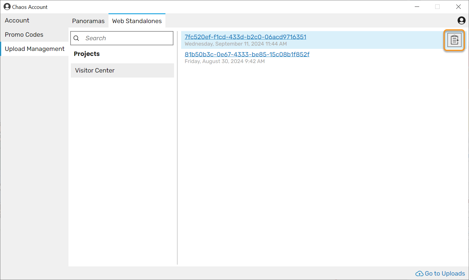

Back in the your CAD, you can administer your Web Standalones by clicking on the Upload Management button in the Enscape ribbon.
Once clicked, a new window named Chaos Account will open. Click on the tab named Upload Management on the left sidebar. Now click on the Web Standalones’ tab which will list all the Web Standalones that you have created, categorized by project.
Here, you can click on the Web Standalone and the link will open in your Web Browser. Additionally, once you hover over the web standalone link, you will find a button to copy the link to your clipboard as well.

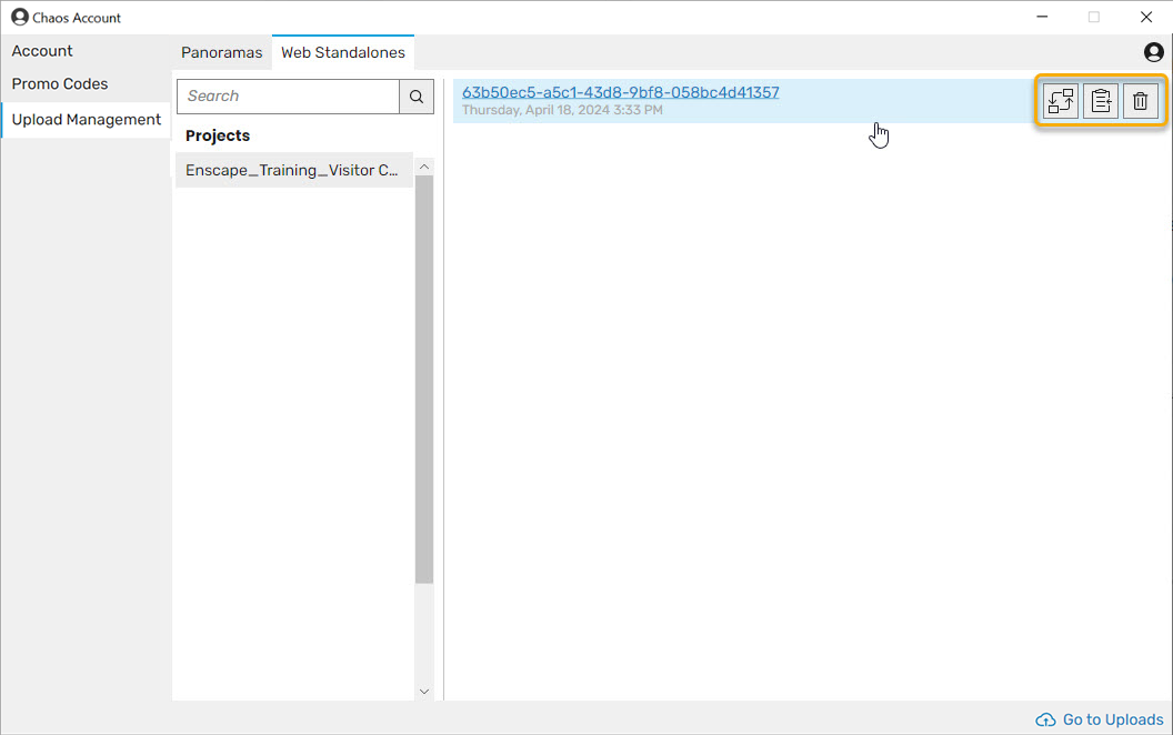

Here, once you hover over the web standalone link, you have 3 buttons to allow further administration of your Web Standalones. From left to right, Replace another uploaded Web Standalone in the Cloud with this…, the Copy link, and Delete Web Standalone.

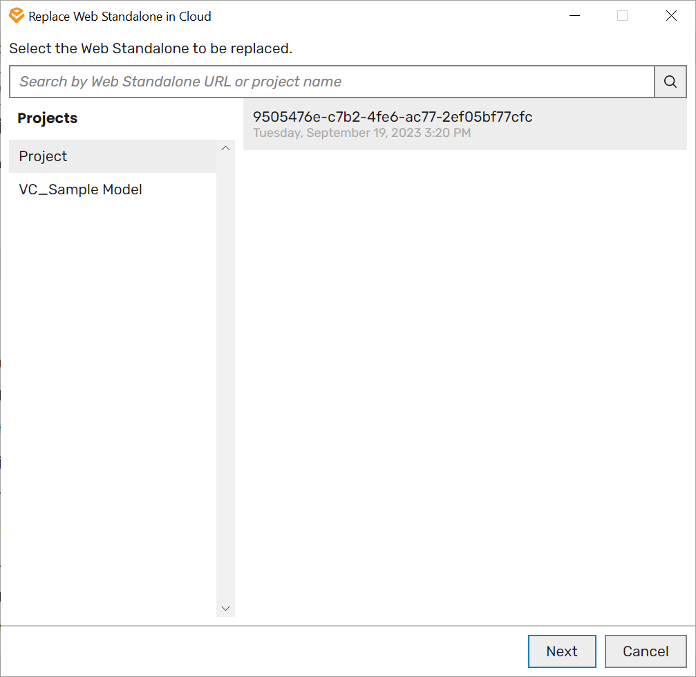

Clicking on the Replace another uploaded Web Standalone in the Cloud with this… button will result in the associated Replace Web Standalone in Cloud dialog to open, where you are asked to choose the Web Standalone to replace.
You can replace Web Standalones that have been exported from different projects and these will retain the URL / link associated with the Web Standalone being replaced / deleted.

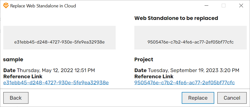

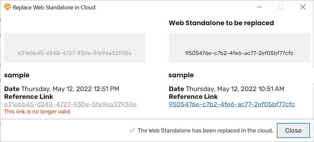

Once you’ve selected the file to replace, you will be asked to confirm the details of the exchange.
Details of the Web Standalone to be replaced

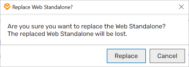

And then a final confirmation dialog to proceed, as the Web Standalone to be replaced will be deleted entirely.
Final confirmation to replace a Web Standalone
If successful, you will receive a confirmation notice that the Web Standalone has been replaced.
