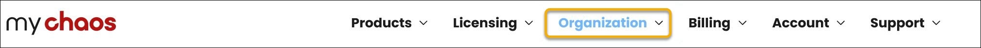

1. Log into my.chaos.com and go to the Organization tab on the toolbar.

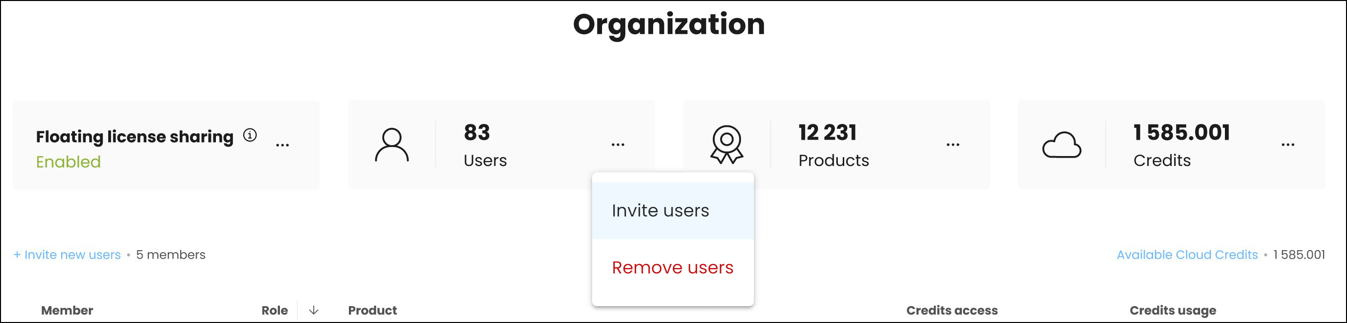

2. Go to the three-dot menu next to Users and select Invite Users.
3. Invite users to your Organization. For instructions on this step, see the My Chaos Guide page.

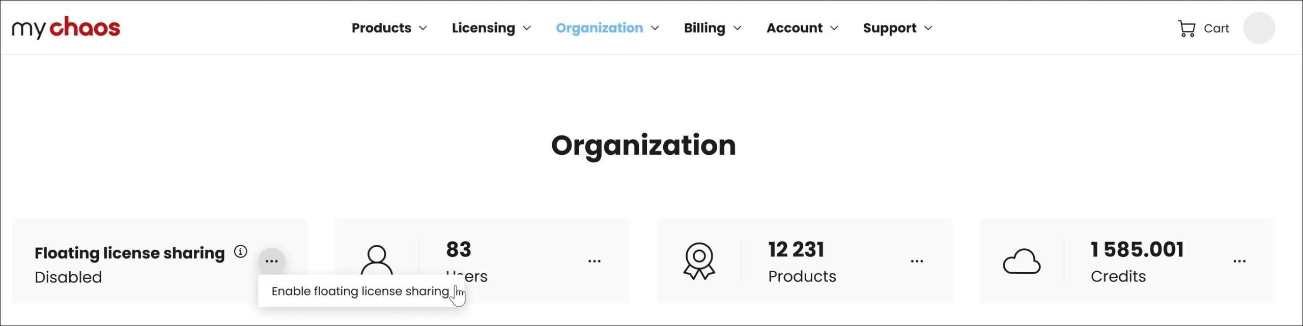

4. To enable Floating license sharing, open the three-dot menu next to the option and click Enable Floating license sharing.
At this point, any user within the Organization can use a shared floating license.

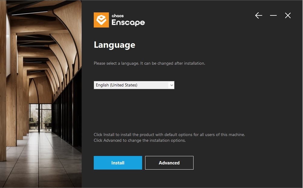

  2. Install the Chaos product(s) your Organization has a license for. Proceed with a default installation. This installs the Chaos license utility locally. Sign in with your Chaos Account when prompted.

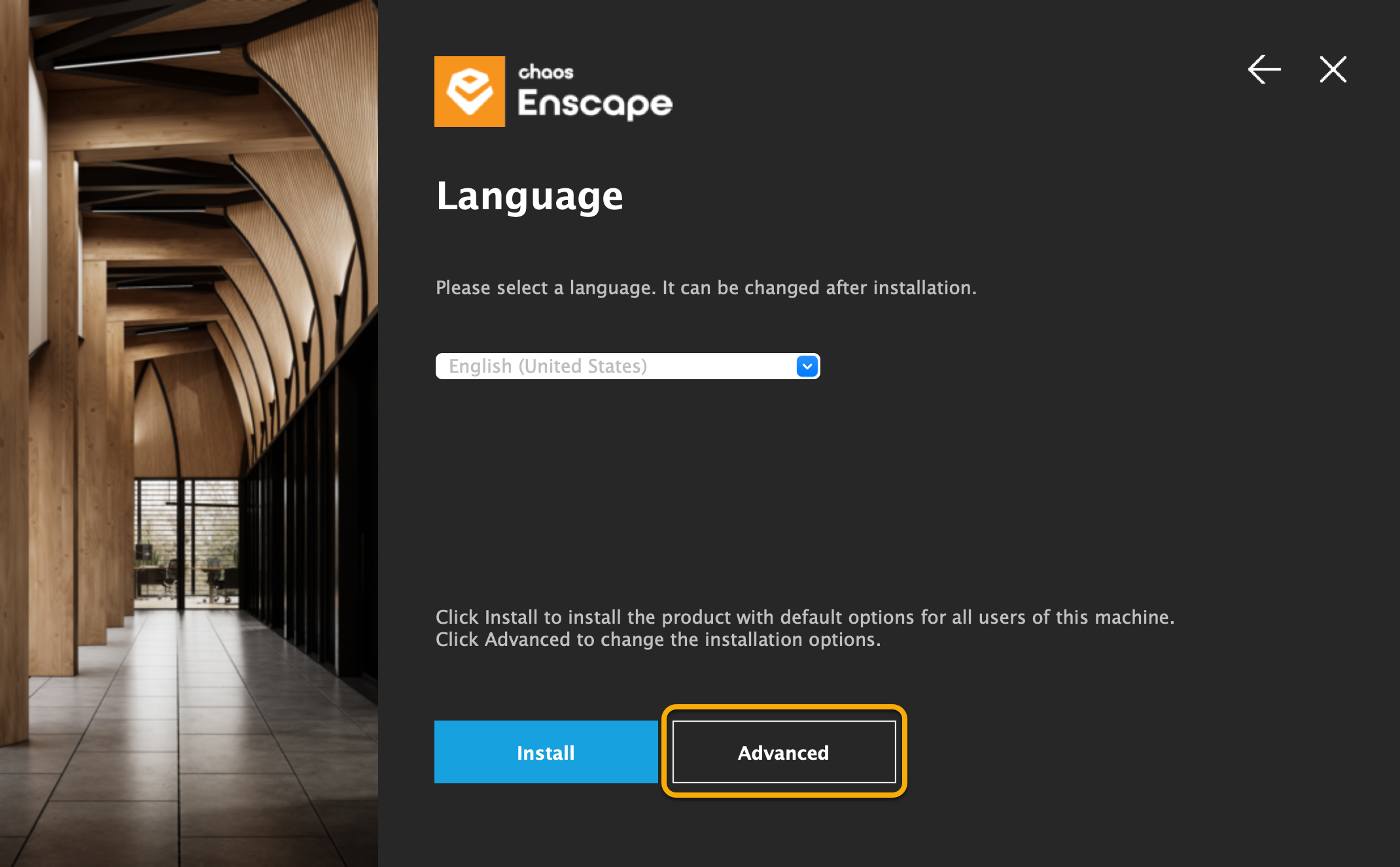

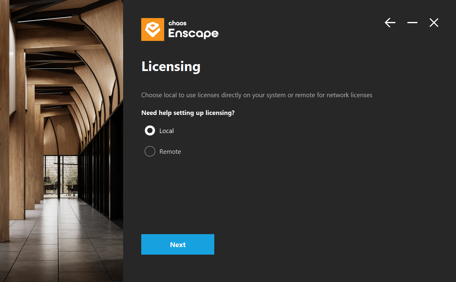

  • In case users have configured their Chaos product to connect to a centralized remote License Server, they will need to re-install the Chaos product and select Local Licensing in the installer’s Advanced options. Users will then need to sign in to the product with their Chaos Accounts.

If you already have a floating license setup with a centralized License Server within your local network, your users have selected Remote licensing in the Advanced installer options. To move to a Cloud-based Floating License setup, users will need to switch to Local licensing by re-installing the product and selecting Local licensing in the Advanced installer options. If users are installing a Chaos product for the first time, they only need to install with all the default options without selecting any of the Advanced installer options.
