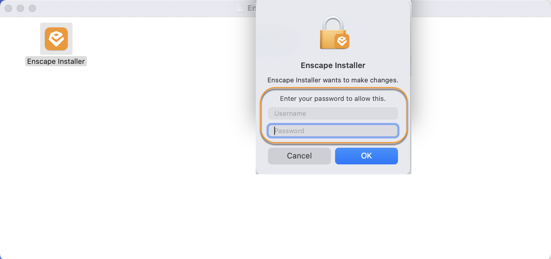

At the beginning of the installation you will be prompted to enter the username and password of an admin account even if you are logged in as that admin. This could be a familiar behaviour to other standard installations.

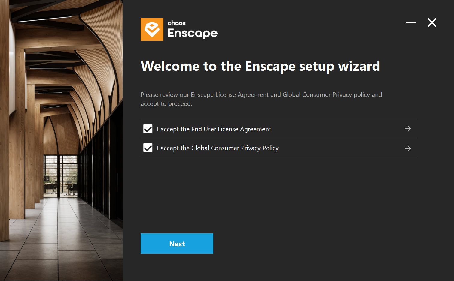

When installing Enscape, a wizard will guide you through the various steps of the installation process. To continue, you will be prompted to accept the End-User License Agreement (EULA) as well as the Global Consumer Privacy Policy (GCPP). Click Next once you have read and are ready to continue with the installation.

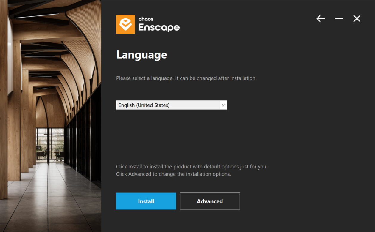

Language
You will be asked to select a language you want to use Enscape in and you can choose from a list of selected languages. English will be selected by default. If you are ready, you can simply click Install to continue installing.
 The language can be changed after installation, if required. The option to do this is found in the Enscape General Settings window under the Preferences options.
Simple Installation
After clicking on the ‘Install‘ button once the language has been selected, the installer will proceed to install Enscape and all its sub features, but only for the currently logged in user.

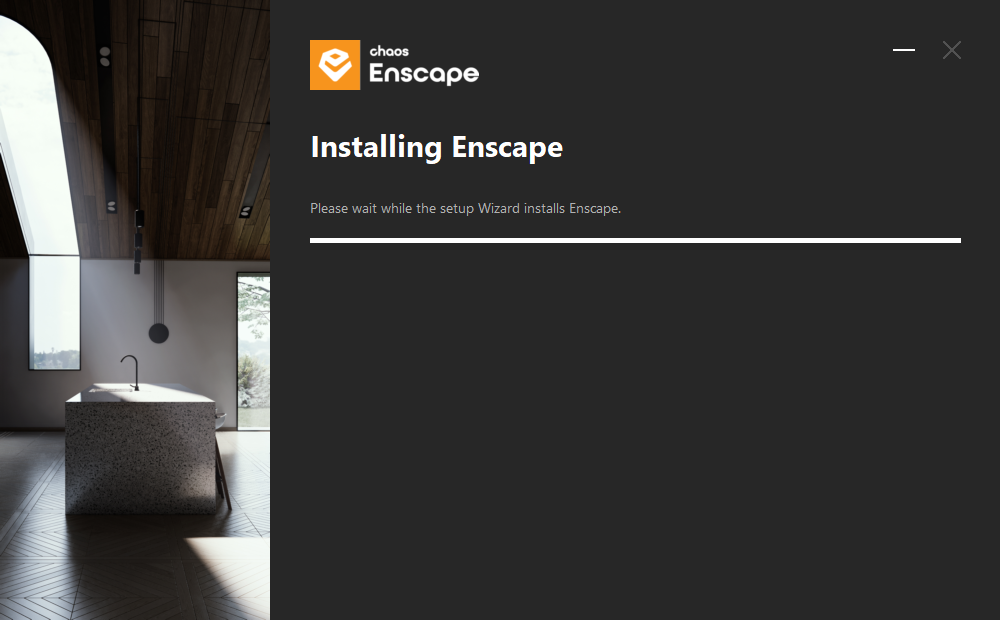

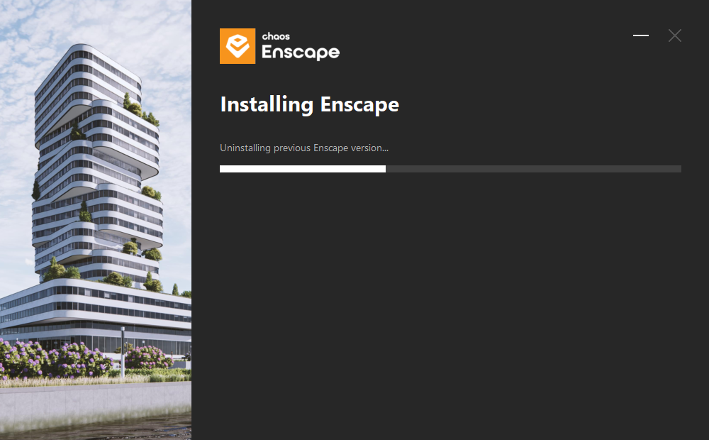

The installer will then run and you should see this in the installer window as shown in the following screenshots. Enscape will identify if a previous version is already installed. That version will automatically be uninstalled first.
Your chosen version of the Enscape plugin would then be installed.

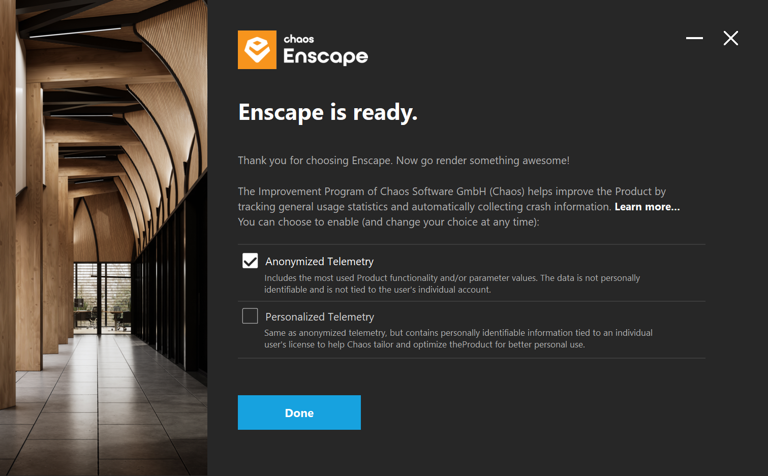

Once signed in to your Chaos account, you will get a confirmation that Enscape is ready.

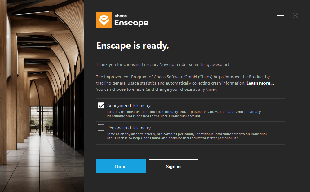

To further improve your experience with our tools, we kindly ask you here to share some telemetry data about your usage with us. You can change these settings at any time!

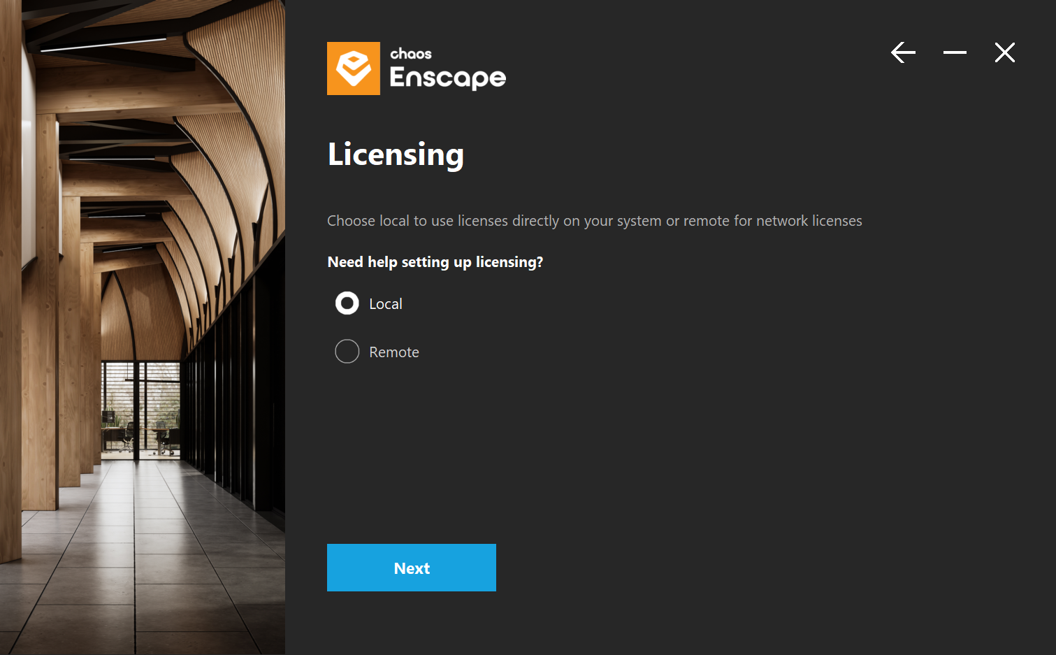

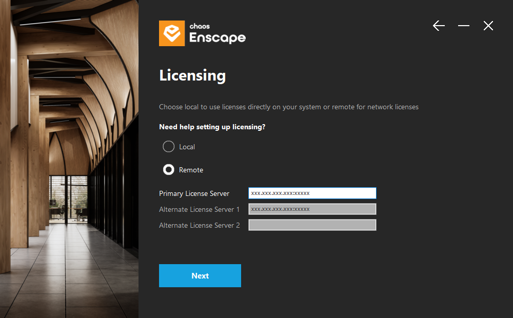

In the next window you can specify where your Enscape license should be retrieved from. Choose Local to use licenses directly on your system (Fixed-Seat License or Floating License with a local License Server) or Remote to use a network license (Floating License with a remote License Server).
Local License
If you select Local you directly go on with the installation process by clicking Next.

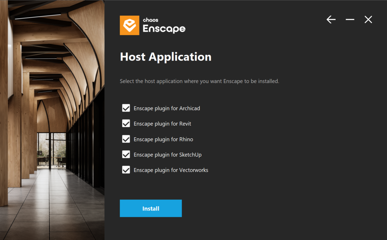

After clicking Next, you can specify whether to install the plugin for only one specific CAD, multiple CADs, or for all CAD’s.
To further impove your experience with our tools, we kindly ask you here to share some telemetry data about your usage with us. You can change these settings at any time!

If you select Remote you can define your License server(s) before clicking Next.

After the installation is finished, you will get a confirmation that Enscape is ready.

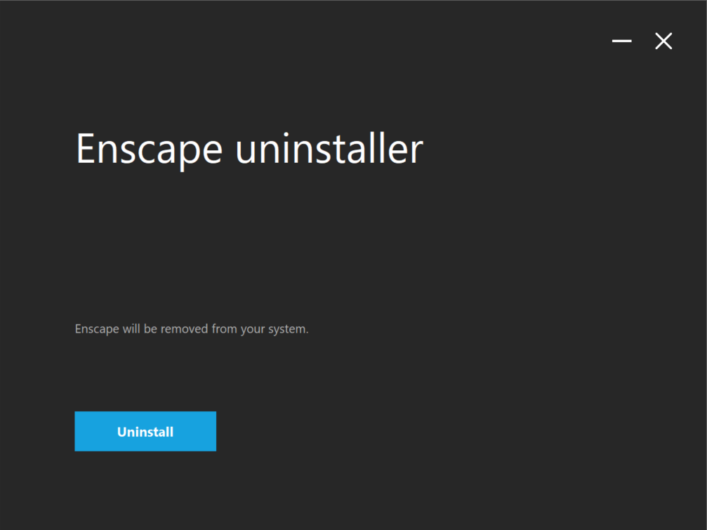

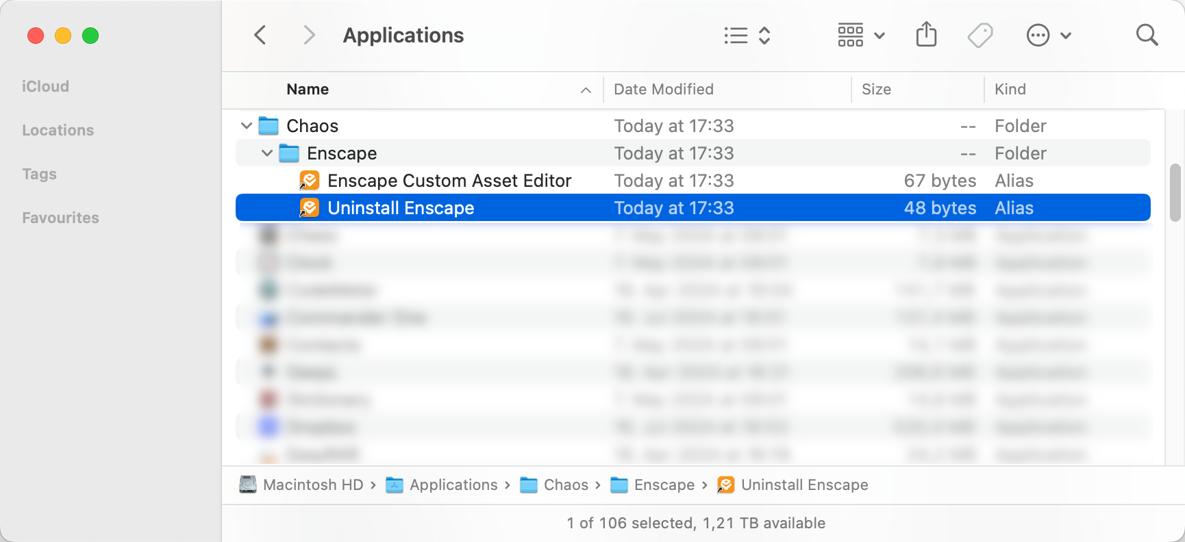

To uninstall Enscape from your Mac, go to the install directory (e.g. /Library/Chaos/Enscape/uninstall) and open the Uninstaller.

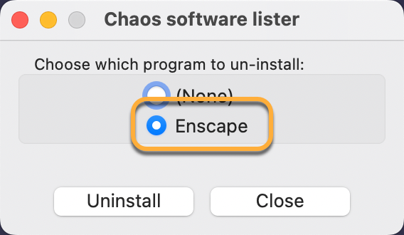

A dialog will pop up asking you to choose the program you wish to uninstall. Select Enscape and click Uninstall.
This will open the Enscape Uninstaller window. Click Uninstall to continue.

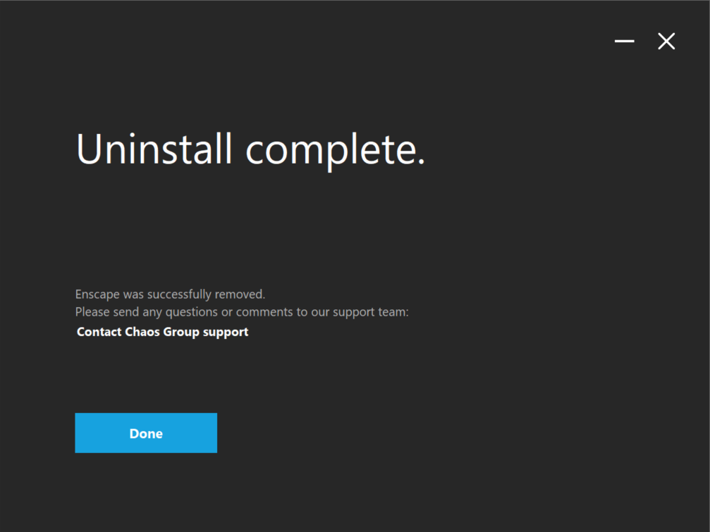

In the next window you will get a confirmation that Enscape has been successfully removed from your machine.
You can click Done to close the window.
