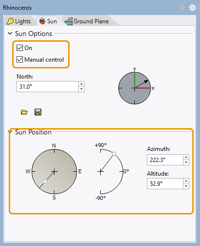

Rhino Sun Settings Window
By having the Sun Options ‘Manual control’ unchecked, Rhino will display extended options to allow you to control precisely where you would like the location to be.

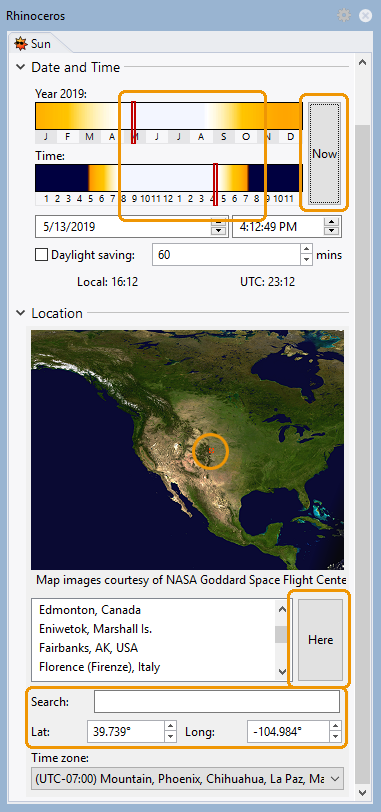

You can adjust the time of year and time of day under the Date and Time area with the red sliders, or you can hit the Now button to use the current date and time.
Location can be set by either clicking on the map, the location is indicated by a small red box on the map.
You can click on the Here button, which will use your current location if available, or you can manually search by city, or set the Longitude and Latitude coordinates for better precision.
Rhino Geolocation Settings

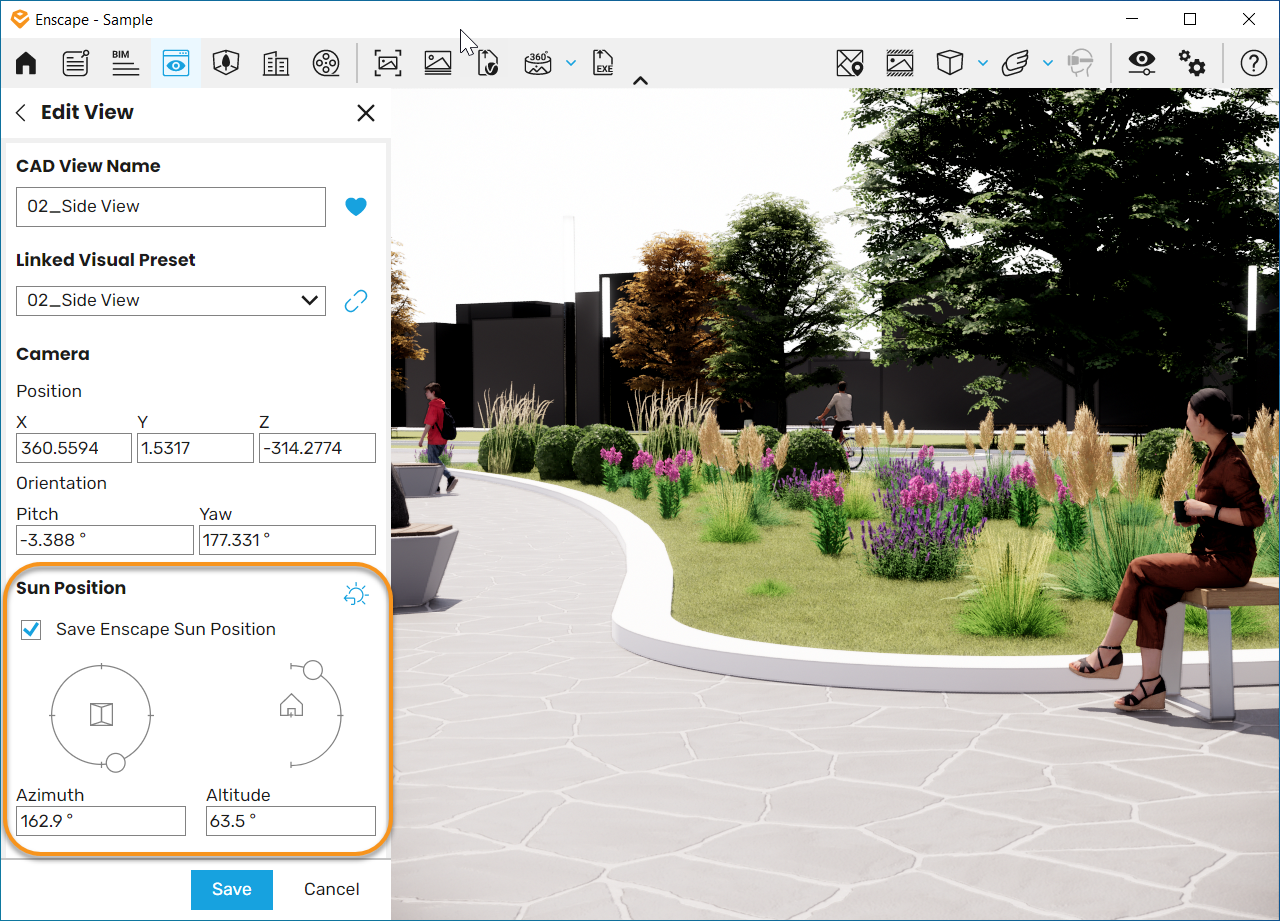

Save Enscape Sun Position

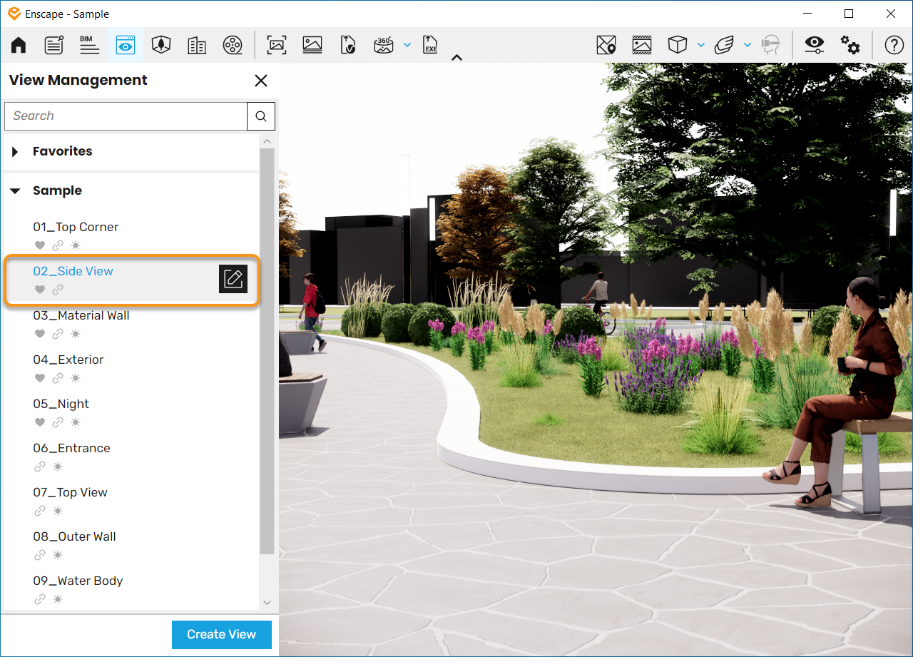

While you are adjusting the time of day in Enscape. You can save the Enscape Sun Position by going into the View Management tab – Select the view you would like to save the sun position of.
Manage Views
There will be a section for Sun Position, then click the box to open the Enscape Sun Position settings.
Sun Position Section
You will now have 2 options to control the Sun Position:
Azimuth – Rotation of the sun around the building.
Altitude – Rotation above and below the horizon line.
By adjusting these sliders you will see the time the time of day change to the desired result.
*If you need to undo the changes at anytime, click the undo button.
Once you are happy with the adjustments, click the Save Button at the bottom of the window.
Azimuth and Altitude Settings
Now each time you go back to this view it the sun settings will stay the same.

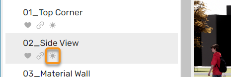

*You can see if a view has the sun settings changed by the little sun icon under the views name.
